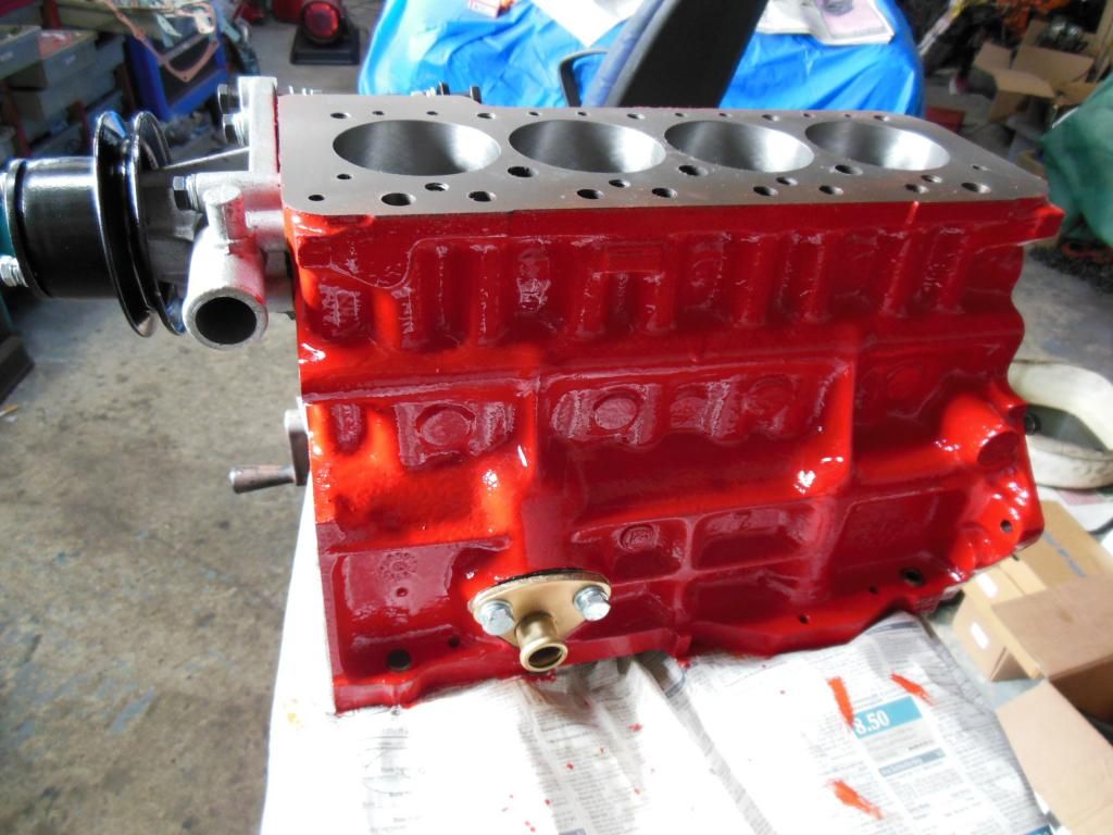

Hi chaps, a quick question for you all... would this part that I've spotted on ebay...
http://www.ebay.co.uk/itm/321498876867?_tr...K%3AMEBIDX%3AIT
be suitable to bolt to the return side of my T3 and then marry up to the block via the connection in the photo below...
I ask because by eye the two pipes do not look the same diameter. Any thoughts?

It says the barb is for 16mm id hose, which looks about right. Measure the unflared part of the pipe to see.
you want a right angle one really,
Yes ideally, did have one but can't seem to find a replacement..
this is the std metty setup,

Yes Joe, thats exactly the bit I need, the piece with the green pipe clamped to.
Anyone got one floating around??
I've got one; PM me your address and I'll stick it in a jiffy bag

Thought your engine was built? Or this just an example pic?
Lol yes, one of the library Steve sent me during the build...
