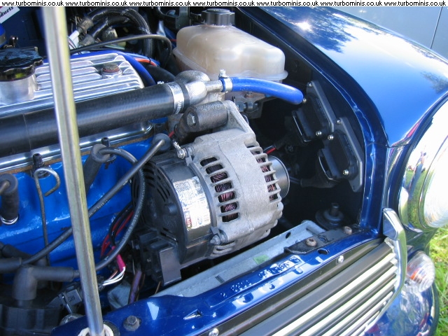

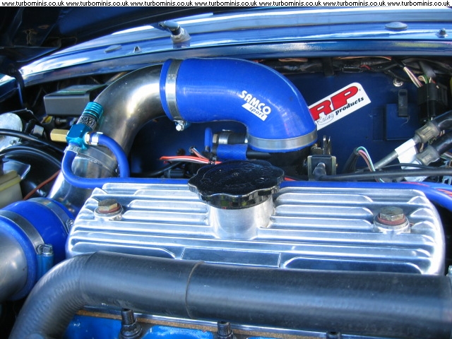

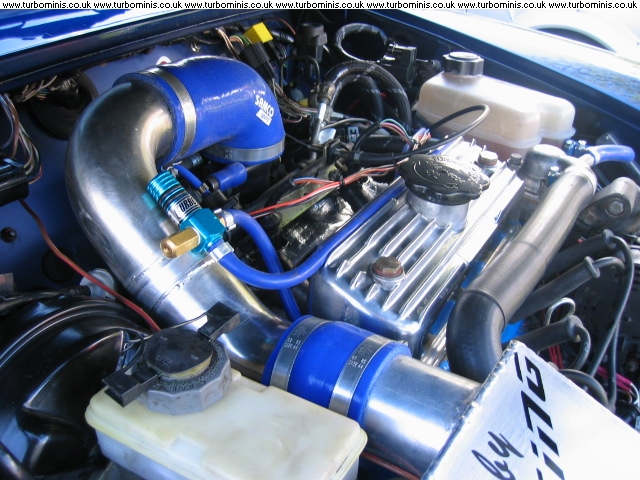

As mentioned earlier, there was a Twin point turbo on this year's annual Mini Meet in Norway. I got a couple of pictures of it, but unfortunately I don't know a lot about the setup.
The owner had nil knowledge of the 5-port problems, (neither do I to be honest) so I didn't go there.
What I do know, is that he uses LARGE injectors from a Cossie of some kind.
Oh, and it's a 1380 btw, and he is using the turbo of a VAG 1,8 turbo, which he claimed was too small. Homemade manifiold.

do you know what power it was making?
He said that he was going to get 200hp out of it. I nodded politely :)

Very neat set up I must say - I'd love to know how it works nd what ECU he's using?!

Just to add something here, as I have spoken a bit more with the owner of this setup.
He has some knowledge about the 5 port troubles, and have a sequential injection setup from MOTEC to try to even out the fuel distribution into the cylinders. he has converted everything to MOTEC I think, and with std box and such, the engine has costed something in the area of 6000 pounds. mostly on electronics. He has not too much knowledge about the typical mini stuff, so it will be fun to see what he says when he experiences troubles with the engine itself, but he has much knowledge about ECUs and electronic engine control, he is working with that for a living. He is using an intercooler from an audi S3.

I also know one more here in Norway using a motec EFI system and a VAG 1.8t turbo, he "only" got 154 hp at the wheels with that system with 820 cc injectors. He is running Norway`s best RR and claimed that that turbo was too small and caused too much backpressure, and thus couldnt give enough boost to give really good power. his rollers are accurate and trrustworthy
