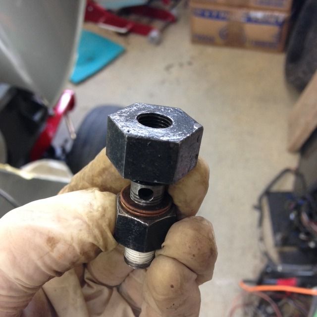

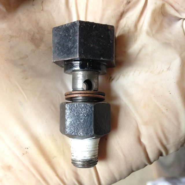

Chaps, can't remember where this goes... I'm sure(ish) its for the turbo oil feed but not fully convinced. It does kind of screw into where I'm thinking but would like to clarify please. I know the oil pipe connects to it by the banjo but what comes out of the top of it? Heres a couple of pics...

Yes turbo oil feed. The oil pressure warning screws in the top On 7th Oct, 2010 5haneJ said:

It is for the turbo oil feed if your using the standard pipe. It fits into the feed on the block below the one from the oil filter housing |

Ok thought as much... thanks guys. Rob, do you mean below one of the pipes from the oil cooler? The one on the left, not the one from the oil filter itself? Edited by evad1980 on 17th May, 2015. |

It fits into the hole in the front of the block that is below the one your oil cooler will be fitted to |

Yup thats the one... cheers! |
