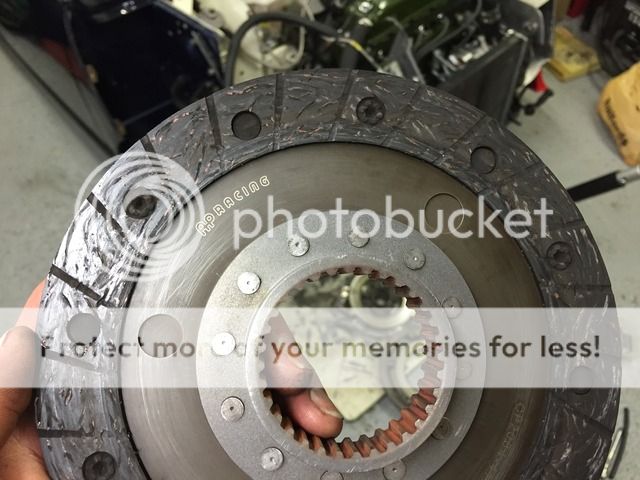

I've got an rts clutch set up with a organic race and rally plate. It did about 5-6k perfectly taking stick and not slipping.
Now it's slipping and looks like this...
Doesn't look particularly worn? What would you recommend fitting now? Same again or the Minispares 5puk paddle

IMO the organic plates are CRAP! CRAP!
is that bottoming out on those big allens ?
6966 Posts
looks bit of what of Robert says ,but also looks like theses oil in there
I'm using a 190mm organic and its held everything I've thrown at it.
What does the inside of the housing look like? Oily?

Yes there is abit of oil in the bottom on the wok. I have quite high crank pressure as my breather tank kicks out quite abit of oily vapour. Maybe I need to enlarge it. The engine burns next to no oil though??
I Hadn't noticed the Allen key heads... I'll have a look tonight. Just weird the clutch was perfect for 6k now it slips under full boost which is only 16psi

It probably contaminated

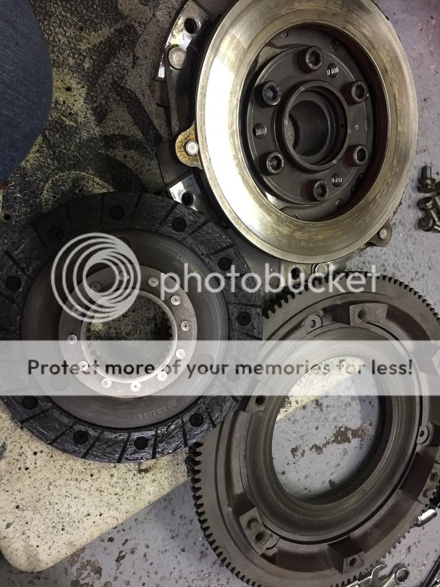

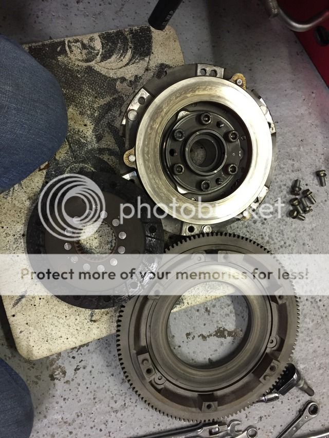

Clutch looks too small diameter. And it also looks like it is getting clamped very unevenly
It just looks all wrong

Only if they are touching the friction disc.
Are they ?
Given they would turn independently of the friction disc, and there doesnt seem to be any contact marks on the friction disc, they probably arent touching..
But the flywheel does look sort of damp/dirty, but the disc itself doesnt appear to have any real signs of oil/contamination on it ( unless you cleaned it before photographing )
Does the disc actually pair up with both cover and flywheel friction surfaces ? or is the disc far smaller as it looks ?

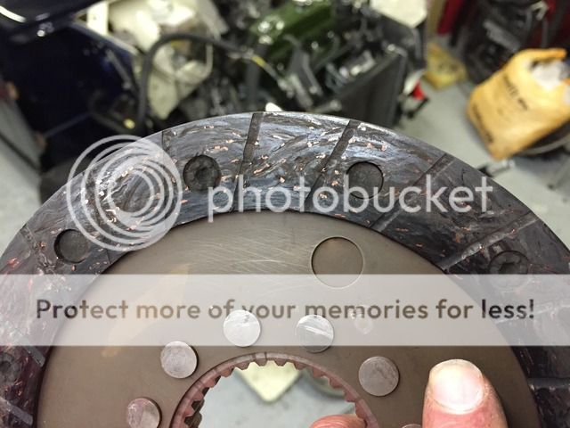

The disc is about 6mm smaller than the flywheel friction surfaces. I agree with the uneven wear, which is worrying
I sand blasted the flywheel which is the reason for the strange finish. It's by damp and I would t really say oily, maybe the slight ring of dark oil? One side. I didn't clean anything.
I must admit I would expect to see something really chewed up if they were touching? But I'll look closer tonight.
I have the oil splash ring thing on there.... Dunno if that actually does anything to save the clutch plate

i think theres a fair bit worn off that by the depth of the slots in the friction plate (or lack of...)
6k is a fair amount of use for somthing like this, also its worth noting that the after market back plates are machined to give a bit more preload, so wouldnt be as prone to slipage on a worn plate.
I'd whack a new seal in as a matter or course, give everything a degrease and a slight sand of the friction surfaces, and a 190mm organic,
Have you a photo of the other side of the pressure assembly, something doen't look right from the reverse side for an RTS.
I agree with oil, classic discolourisation, but, as Joe says, have you actually measured the wear ??
The slots look very thin.
Just measure the overall thickness of the driven plate.

The plate measure 6.85mm thick I don't know what they are new though!

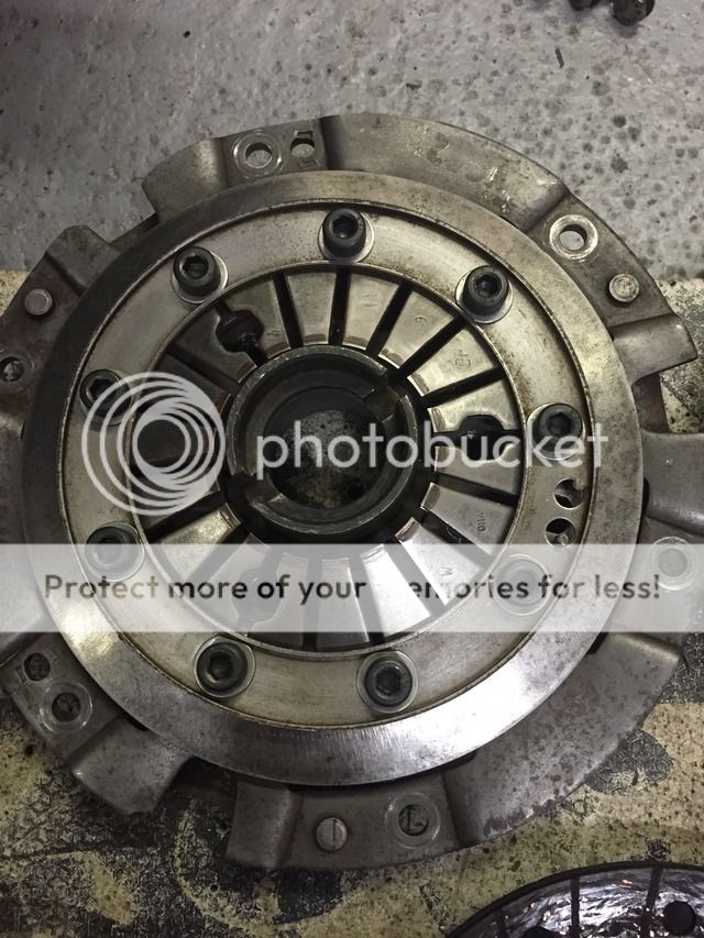

There is only a very slight mark on some of the Allen heads. But I'll grind abit off them to be safe.
Here's the top

I think the plates are around 7.8,mm new, so thats quite a bit of wear.

Check the pressure plate isnt bottoming out on the bolts that replace the rivets on your rts. If they poke through to much they can cause it to bind

Slater the bolts I cut down so they barely poke through 1mm so I don't think it would be that. Cheers
