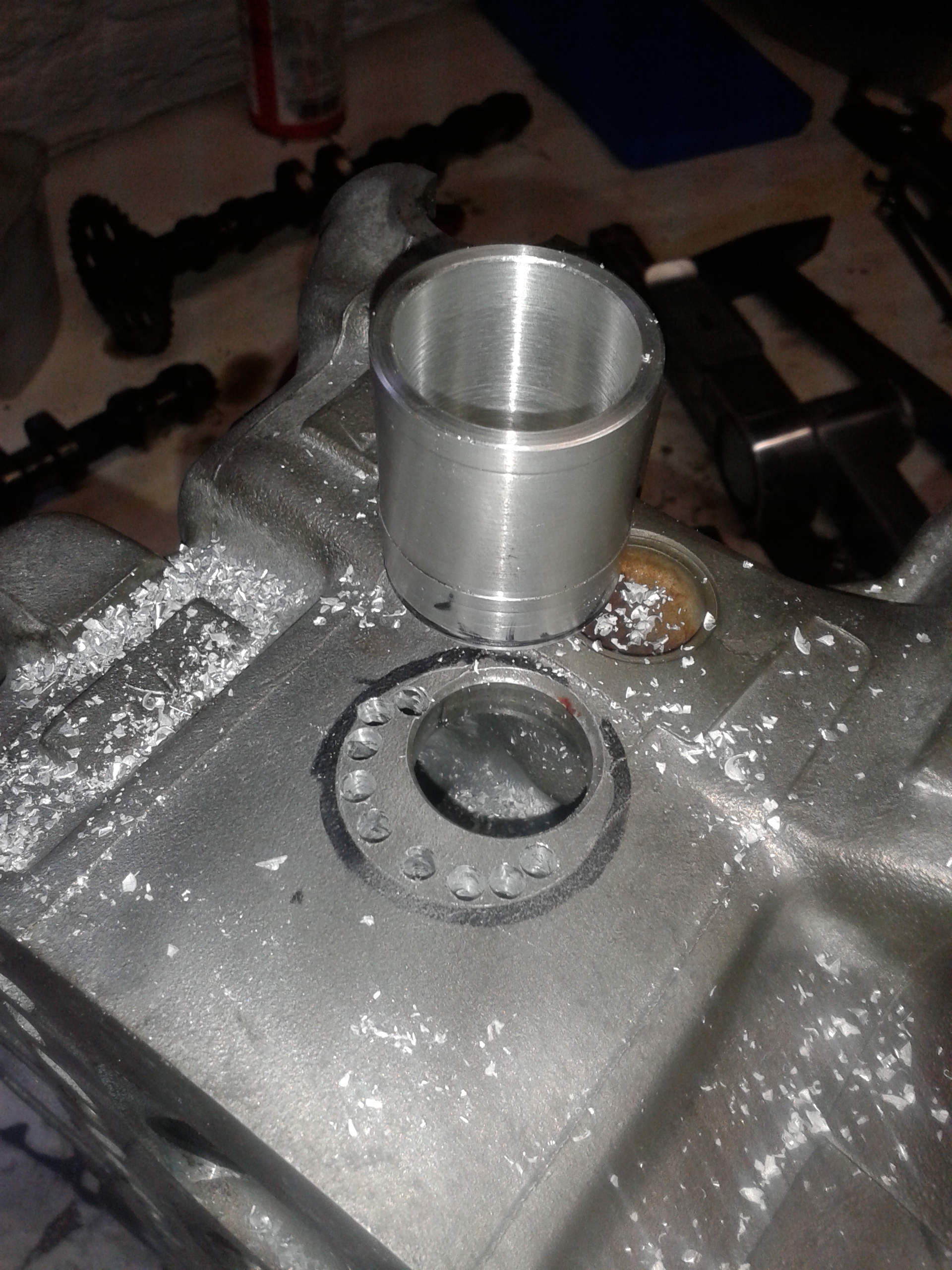

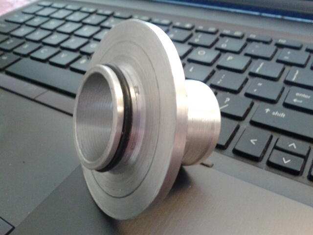

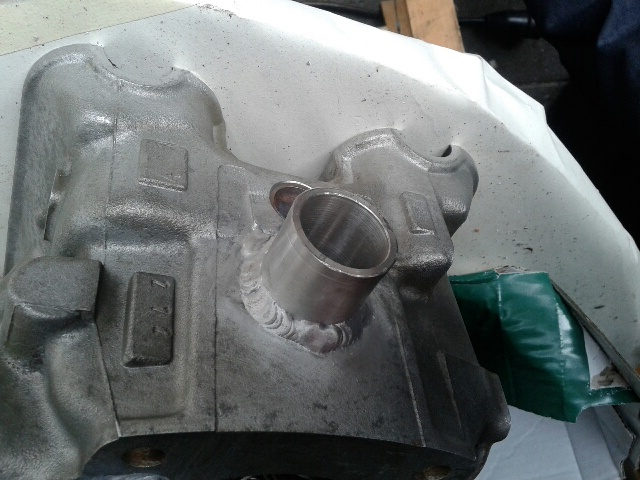

Something like this: also for 32mm inner diameter hose
