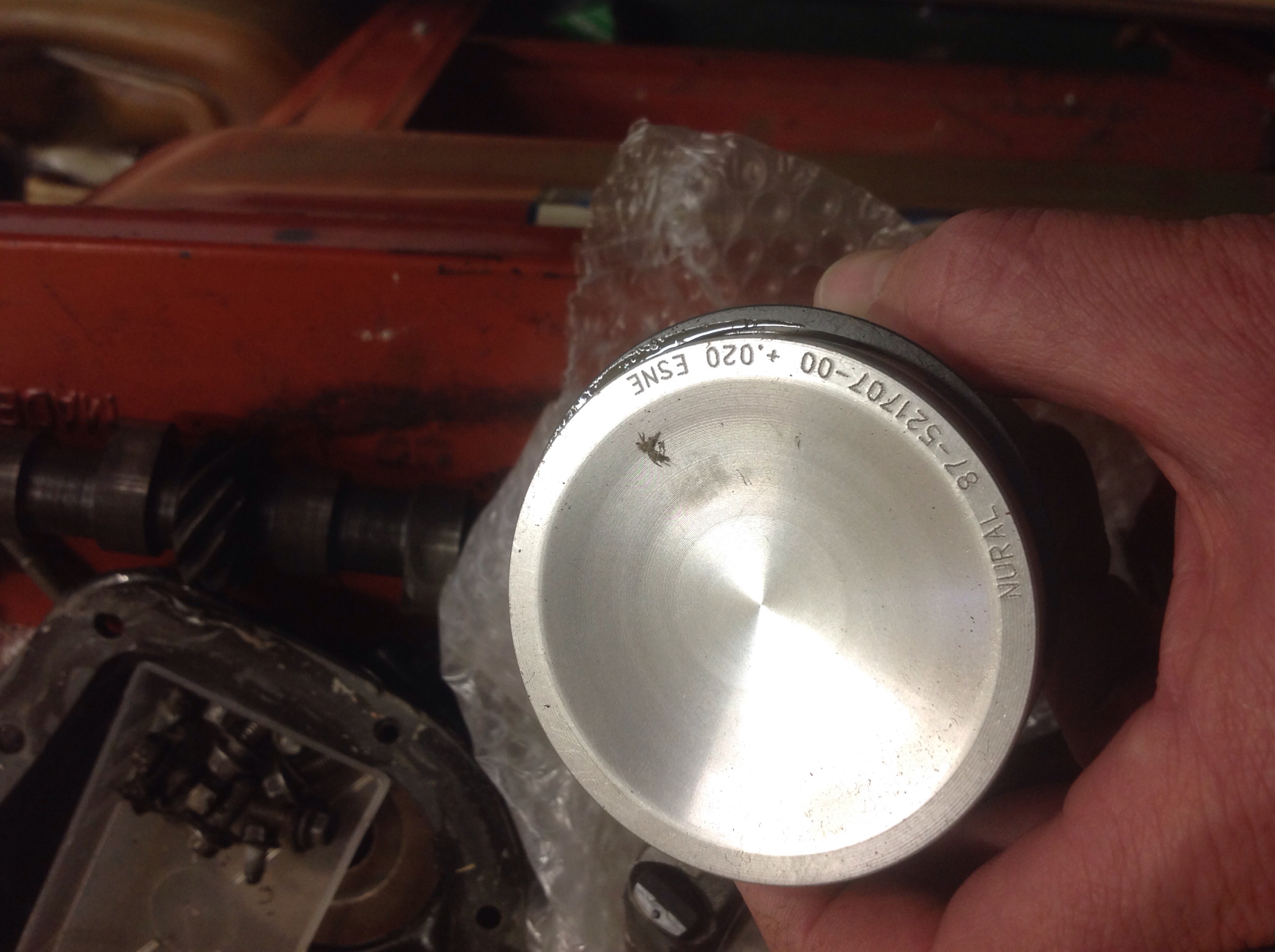

Hi all I am building my turbo engine and have a set of Pistons, NURAL +.020 ESNE 87-521707-00.
The question I have is
Are these Pistons sufficient for my build as I am looking at 150-170bhp if possible or would you say to buy a set of Omega deep dish.
Your opinion and help would be appreciated photo added

I know nothing about the strength of the piston but i can see from the photo you will have problems trying to keep the compression ratio low enough for any decent amount of boost
The pistons look almost flat top, you should be looking at around 35-40cc in the piston dish and combustion chamber combined to place you around 8-9 cr

Thanks Brett, I'll be getting myself some Omega ones then which most people if not all use
Nibs
The cast omega 10cc dish are excellent value for money, mine took a load of abuse and came out looking like new

Thanks Brett omega 10cc Pistons it is then!😄
