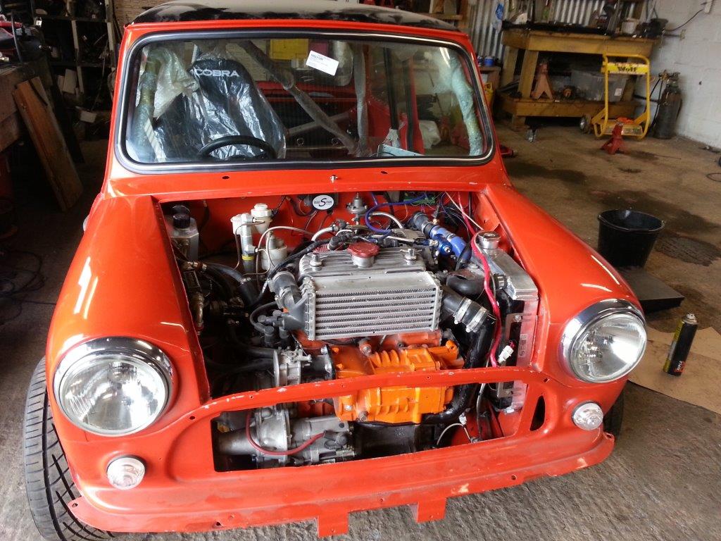

Got any pictures of your blow through?
robba_duck
4 Posts
Member #: 4127
Photo Attached :)

Where's your alternator?
Ozyris
78 Posts
Member #: 9054
Disneyland Near Paris
on the top behind head u can see it
