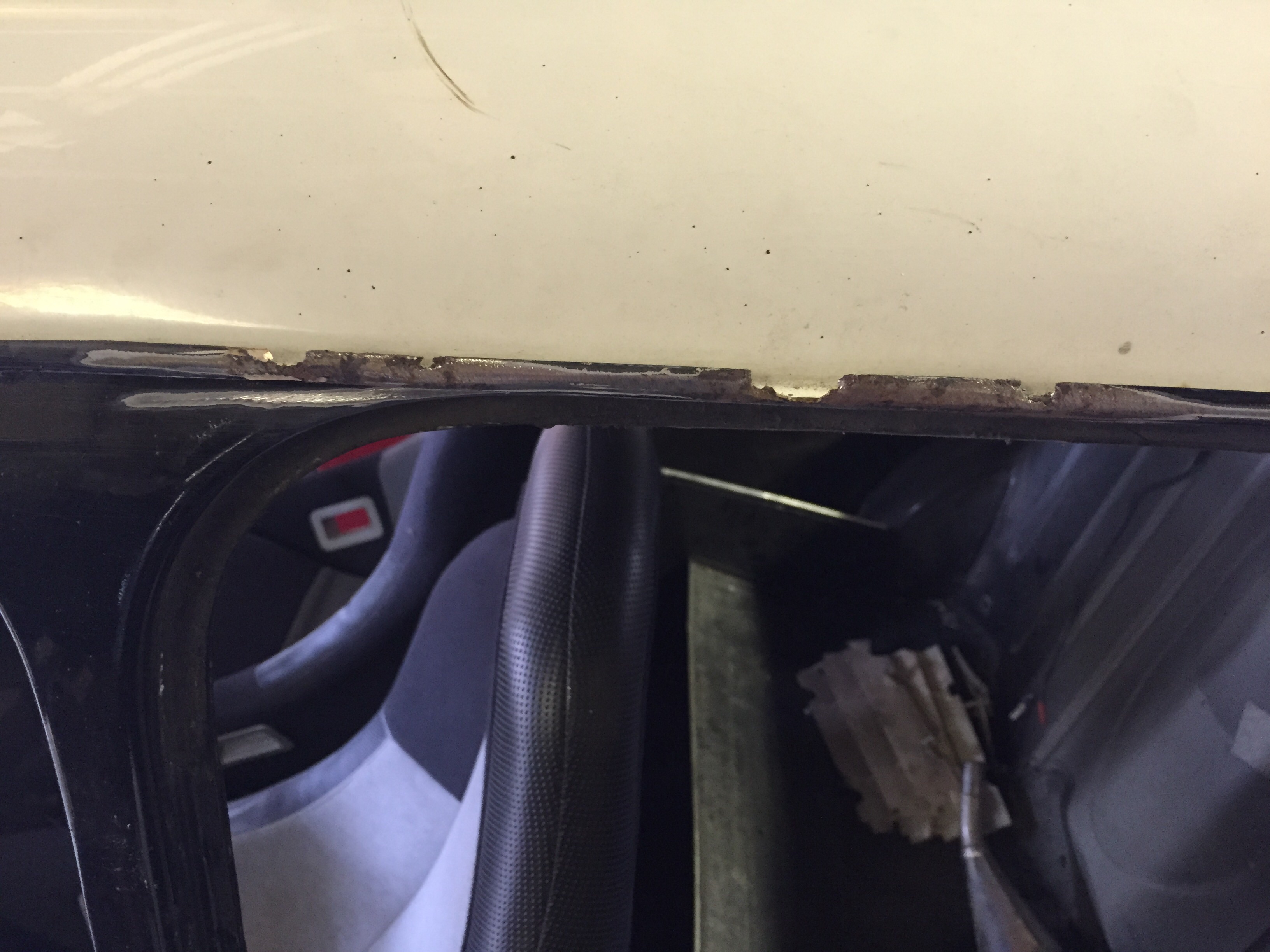

Anyone confident in welding this? Give me a quote please!
http://minispares.com/product/classic/MT632.aspx
LOL

Location is rotherham area!
Best way to tackle that would be get a gutter and weld it over the top in effect double skinning. I can do this for you pal
Or make a piece

back with a copper pipe and build up with weld? lot of work but id give it a shot, failing that sikaflex and gutter trim

Any idea on prices what you'd want to sort it? Done all the rest of the welding apart from this so its holding me up abit!

if you have done the rest then just get this tackled, you wont learn by handing over cash :)
Denis O'Brien.
Cut all of the rot out, make some repair pieces and leave them 15mm-20mm long (helps stop the edges melting away) then cut to length.
