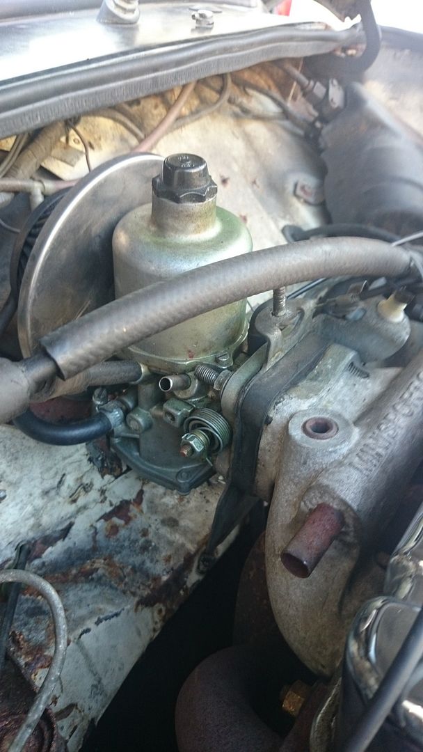

As title can anyone ID my carb. not taking it of yet so cant measure

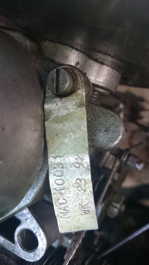

It has the little aluminium tag on it MAC 1003 WK 23 92 any help?

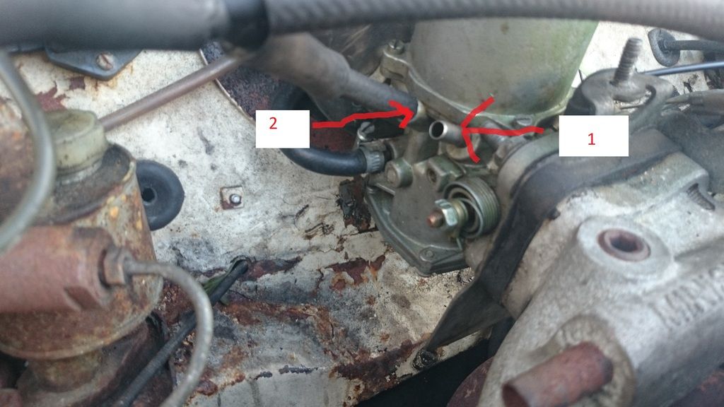

And am I right in thinking that port 1 goes to the breathers and port 2 connects to the little steel pipe that runner over the wok and down the block behind the starter motor and is just open?

Looks like an HIF38 to me. Probably of a 998 mini or metro.
Yes, your pipe thoughs are correct. " is for anti run-on valve. 1 should be blocked or to the breathers.

Ok cheers Will, Dose it make any difference if its blocked off or to the breathers.

No real difference between blocking 1 or plugging it to the breathers. Personally I'd just block it.
