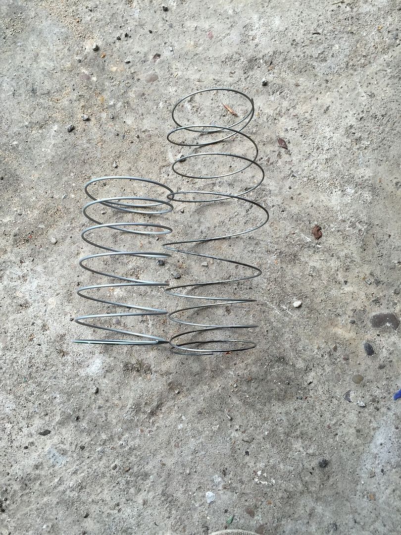

The spring I took out before I went and replaced with a green spring but sleath reckoned the original had a better feel so swapped it back. It does look a bit fucked though see the photo here

That spring looks knackered. It could be binding.
AFR's will show lean for any non fire event, whether misfire, or other. So just because it displays lean, doesnt mean it always is lean. So that needs treated with caution, but it may be correct. Read the plugs during such a problem or as it's on the dyno, there should be a gas analyser available too to give proper readings about how it is running
That spring on the right is well and truly fucked and shouldnt be anywhere near the carb.
