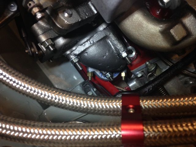

Been out messing with the exhaust today, got the back box hung ok and now need to connect the down pipe to the turbo. There just seems to be no room to get hands in there… I have the modded clamp that Steve sent me with the engine but finding it real difficult to find room.
Is there a knack to this, should I do it from underneath or above? Ive tried both but really struggling from both approaches. I had a wee search, found plenty of threads on downpipes but none answering what I'm trying to find.
Any thoughts? Cheers… Dave.

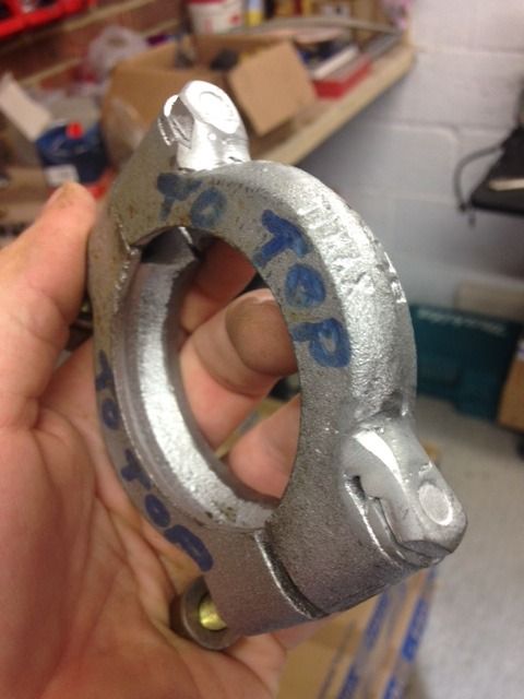

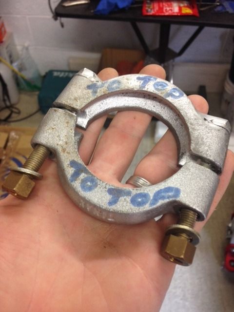

So this is the clamp…
Both studs tacked one side for easy fitment… note Steve's bold instructions.. can't get that one wrong!

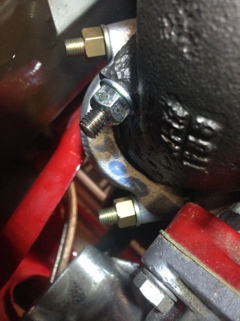

So managed to get it in place today, went in easier with a fresh head on my shoulders… spent most of yesterday under the car sorting exhaust back box and fuel lines so I guess I was just losing patience trying to get the clamp in place…
Is this the position you had it in Rob? I can get a half inch spanner in there now and give it very small turns at a time…
Sorry couldn't rotate the bottom two pics, you'll have to look at the screen upside down lol…
Dave.
I think I had it rotated a little more clockwise but yes, similar position; pretty much moved it about so I could get the ratchet on
