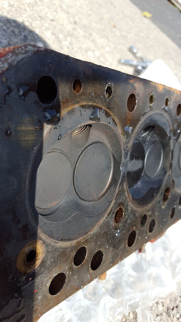

Theres the chunk out of the head

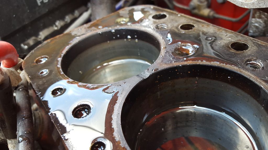

And the block ..

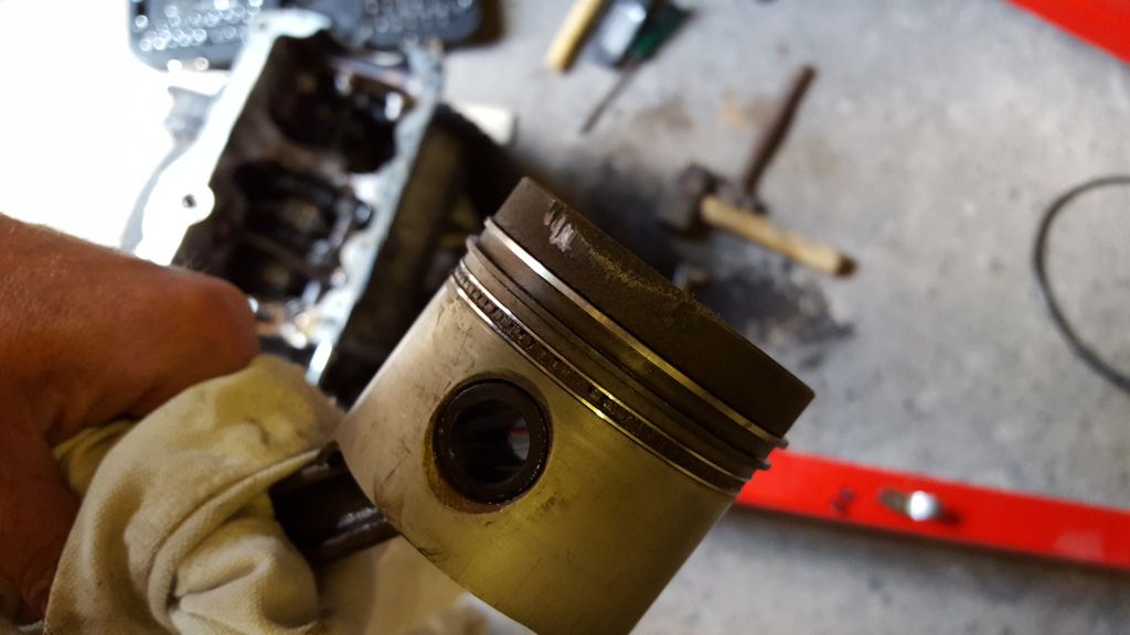

Its not all that clear but that's the piston

4309 Posts
Someone may have a piston lying round. Failing that if the new block is worn go for the cast omegas
My opinion, looking at the state of that a new block will need to be sourced too, a skim to take that much damage out will massively raise the compression ratio, which is unsuitable for a turbocharged engine.
