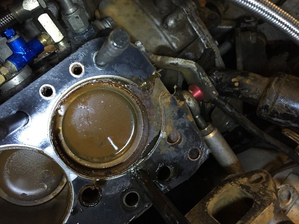

So the other day at Donington my head gasket blew.

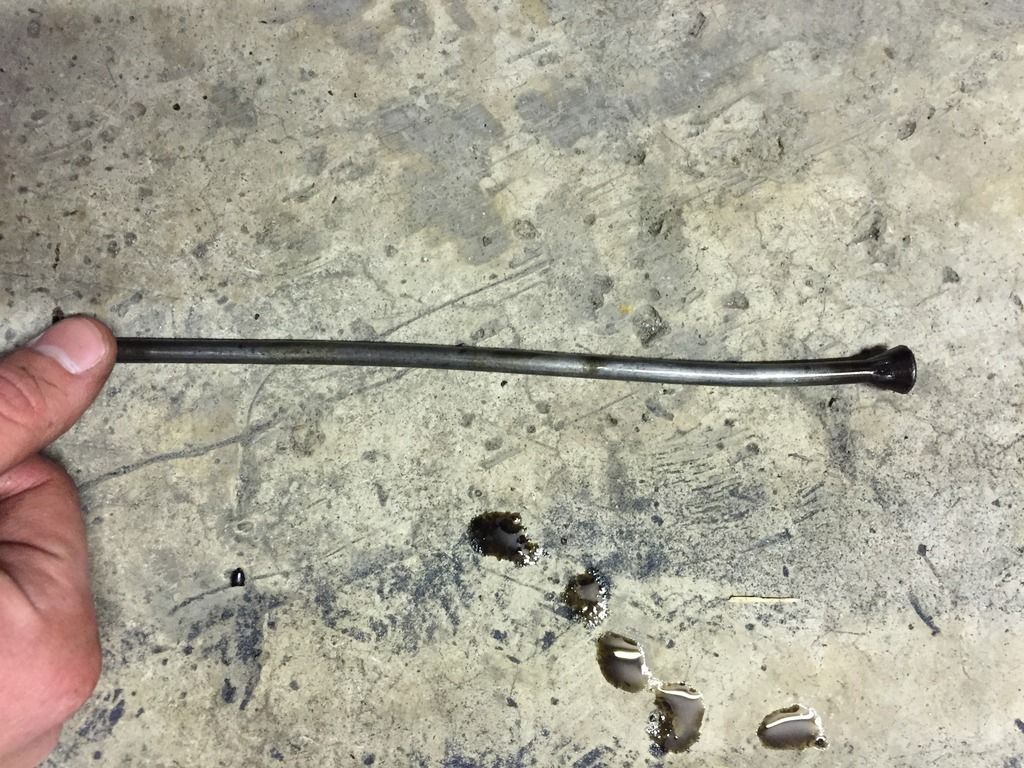

I pulled the head off last night and the gasket has blown in strange place. Never mind it will be replaced and straight back on. What I was surprised was the bent pushrods.
Has anyone got any idea how these have ended up bent? Valves are all fine. Could this be part of the failure from the head gasket.

is there a valve head mark on the piston i can see ?
if so i would say the valve siezed in the guide .

Extreme coil bind at full lift?

What is extreme cool bind john?
Phil not sure on the springs it's a Benross head maybe 280lb? Just a guess.
It's a phase 2 cam and med 1.3 rockers

seen this on a 1293 with high sporty cam combined with high lift rockers ( 1.5) and skimmed head. the dude didn't believe me it would not match and he bent 4 of those before he listened to the fact that his springs couldn't be pushed in that far.
The head gasket failure is caused by under torquing. Check your torque wrench.
It would benefit from being 11 studded.
As for the pushrod. As above, check that the coils aren't binding when you have it all back together. Simple check with a feeler gauge.

Are you on about the coils of the valve springs?
I'll look into it. I've ordered a new set of Minispares performance push rods to replace the full set.

yeah there is a point where the valve springs will compress no more as the coils are touching each other, this is coil bind, and something will "give" be it bending a rocker or a pushrod. On another note cant quite see where the gasket has failed :)

is that push rod from cylinder 4 with the blow out?
maby the gasket blew out hydro locking it jaming the valve into the seat?
why would only one push rod bend? surely 4 or 8 would as the valves and springs should have been a set? unless the installed heights where different?

Turbo This makes a good point. In the first post it says bent "pushrods", so I assumed all 8. But you've only pictured one. So how many actually bent ?

Also wondering how many + which ones bent?
It all looks pretty rusty mud coloured in there... How well do think the cooling system was working?

What checks have you done? A bent valve may not always be obvious. If you can't strip the head, tilt the head onto it's plug side, fill the ports with white spirit and watch for leaks around the seats.

What head gasket was it? Maybe 11 studding would be an option. How much boost were you running?

On 14th Mar, 2012 mw3 said:
classic under torque HG failure, had a few before buying a good torque wrench
classic advert for 11 stood also
edit: bit slow like, at least we all seem too agree though

so the gasket seems an easy fix check the block/head are still flat and check the torque with know wrench possibly 11 stud it
but what hasn't been figured out is why did the push rod or rods bend? we still dont know how meany rods are bent??
im still convinced a significant amount of water fulled the cylinder hydro locking it forcing the valves closed bending the push rod after all the cooling system has about 16psi pressure depending on rad cap

Off head I'd say 4 or 5 push rods were bent

Any chance this was one of those bad BK450 HGs produced quite some time ago?
