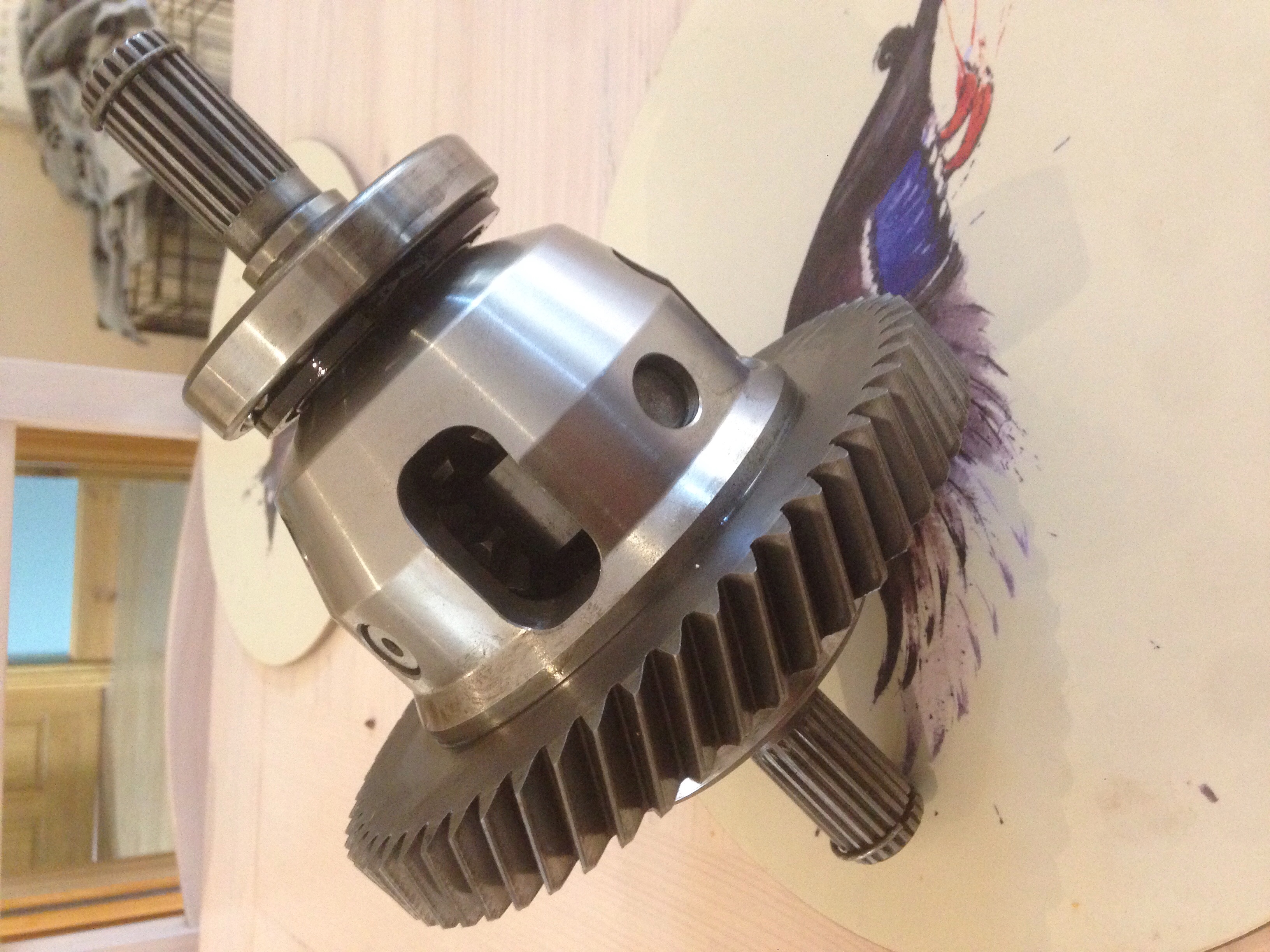

Meanwhile... I have started to tidy up my slightly rusty sub frame!! I stripped the subframe back to bare metal before spraying it with a zinc primer to prevent any little bits of rust popping up again.. So far I have only got the primer on. (See pics)
I also fitted my x-pin diff.
