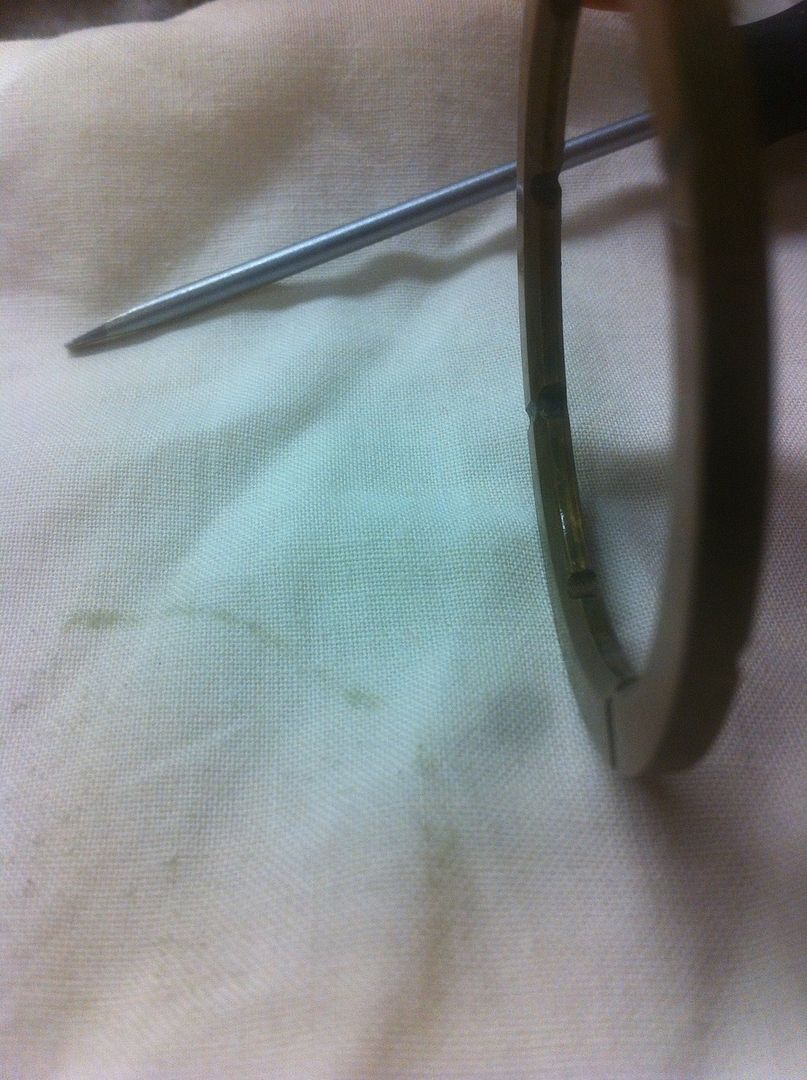

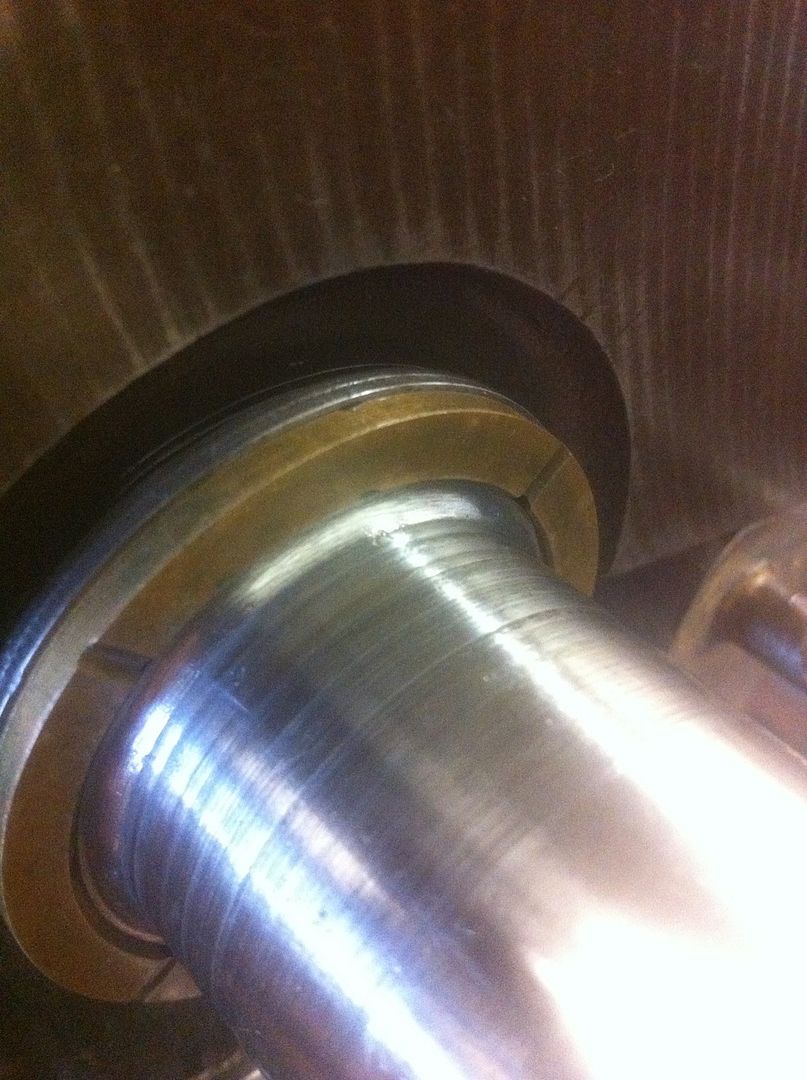

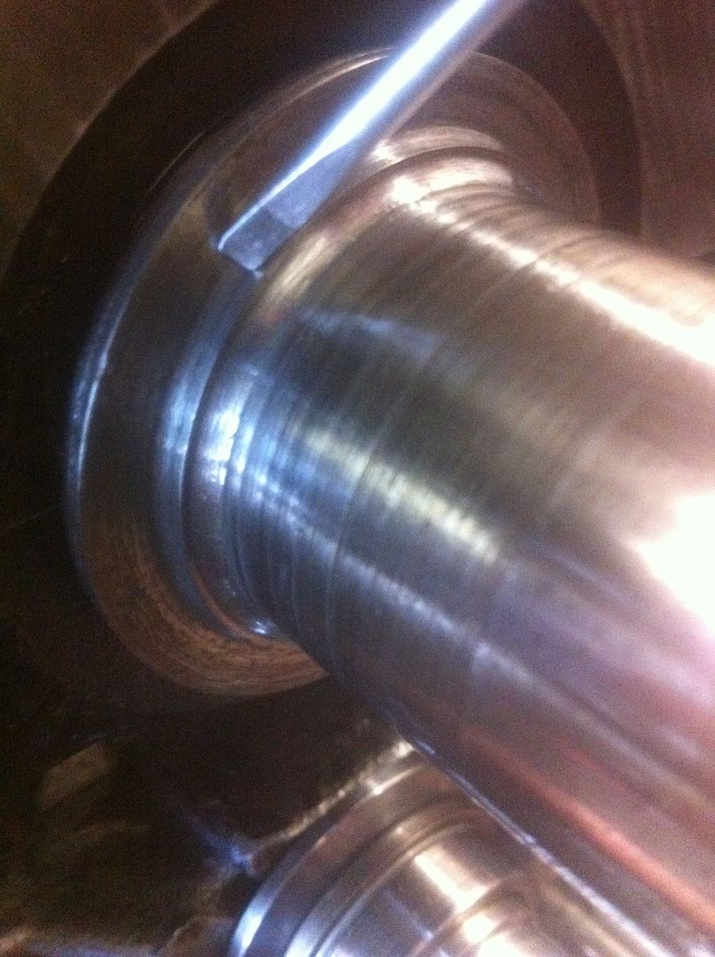

took some pics as ive got my engine apart anyway it might be of some help?
note the two types of gears one is oil feed and one is not depends what you have also the fly wheel theres a small possiblty you may have the oil feed crank and gear but a non sealed flywheel but unlikely
thrust should fit with a tinny up/down movement not much at all on this shoulder
it goes with that relief cut to the crank
