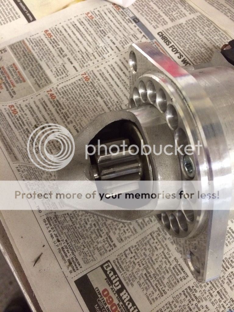

Removed powerlight starter number 3. Pinion has 11 teeth and looks like this
It looks to me like the pinion is stuck in its "start the engine position". Which would explain all the noise after the engine fires up. Should the pinion be further back inside the casing normally?

Also recieved a brand new brise unit today to replace the first starter that broke. This ones got ten teeth.
Sounds very smooth and no problems yet........
