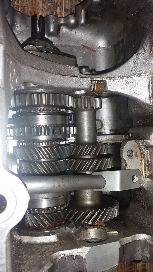

Don't see the problem althoug do think i now it....

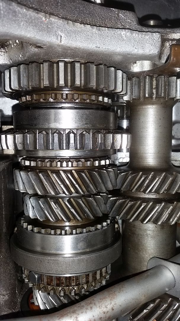

If i go to neutral i can't set in to reverse... if i select reverse than i also am in 3th gear! Have i ( god please tel me no) turned the syncro of 3th and 4th around?
3rd/4th synchro sleeve looks to be the wrong way round. Be carefull though as the synchro hub only goes on one way too

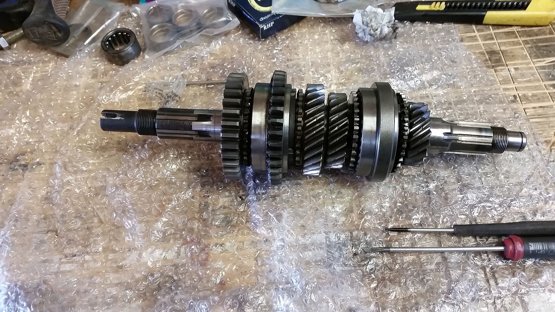

Thought so. Crap strip it all again for 1 stupid mistake. Strange the thing asembled like that. Syncro did pop out of each other when stripped but do thinck i resembled that one correct...

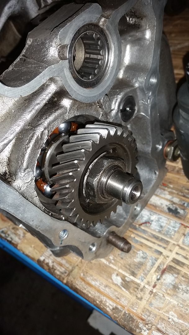

If i pul out this one
no idea of the English name) the bearing comes allong. And i lift the layshaft back out... would i be able to change that syncro without having to strip the rest? ( other bearing)
Edited by Rammie2000 on 26th Sep, 2015.
No. You won't be able to lift the synchro hub out of the selector fork easily enough to get it out without risking balls and springs escaping.

Spend some 30 minutes ( again) ripping it appart again and rebuilding it. Finally got it working right...! Another step closer to turbo.

Had it out proper... Could not resist shifting when it was in again... ( without the layshaft) ping.... 3 bals and 3 springs out!!! Got them back together without lifting it all out again but more work then a rebuild
Done that enough times..
