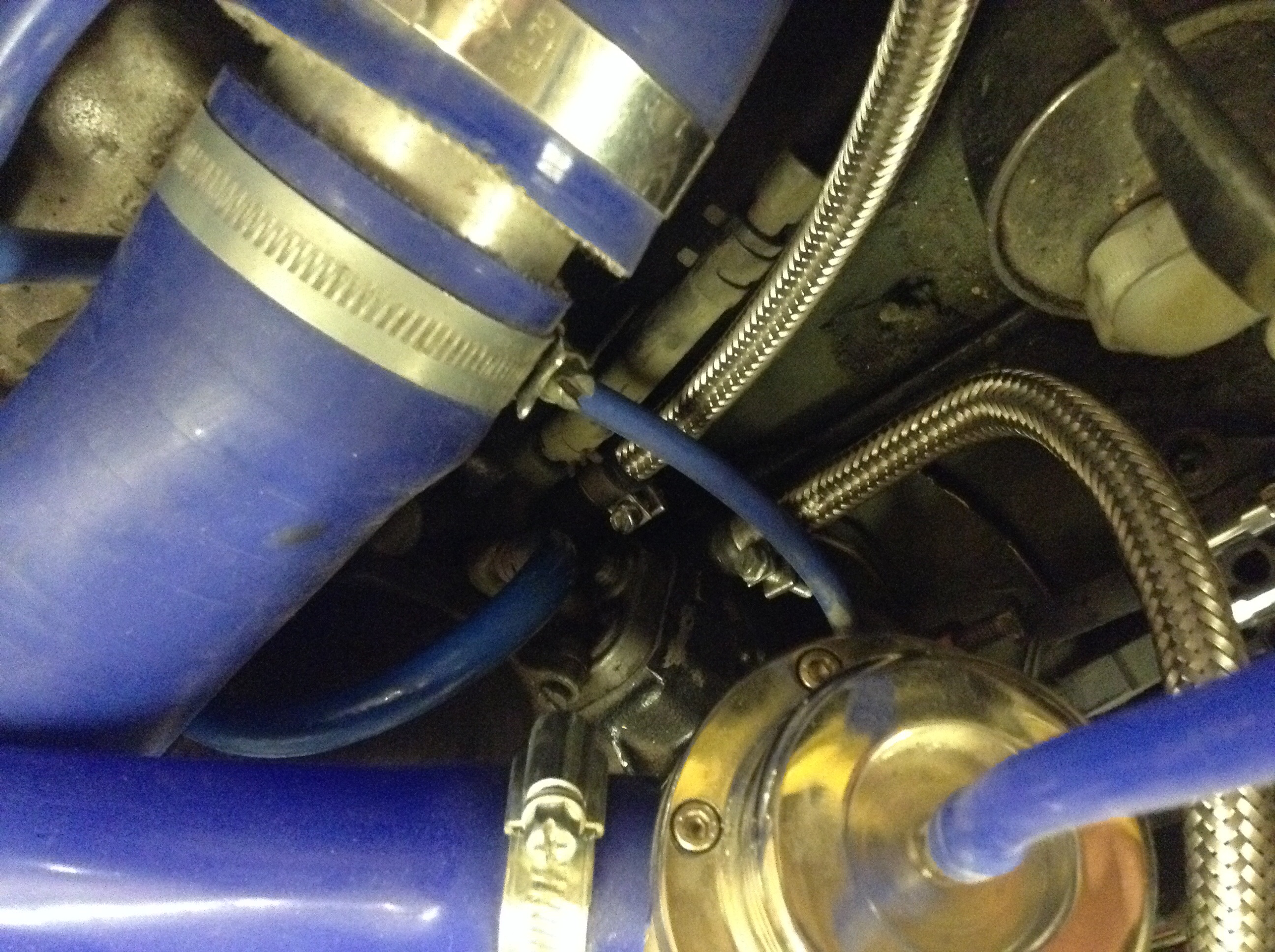

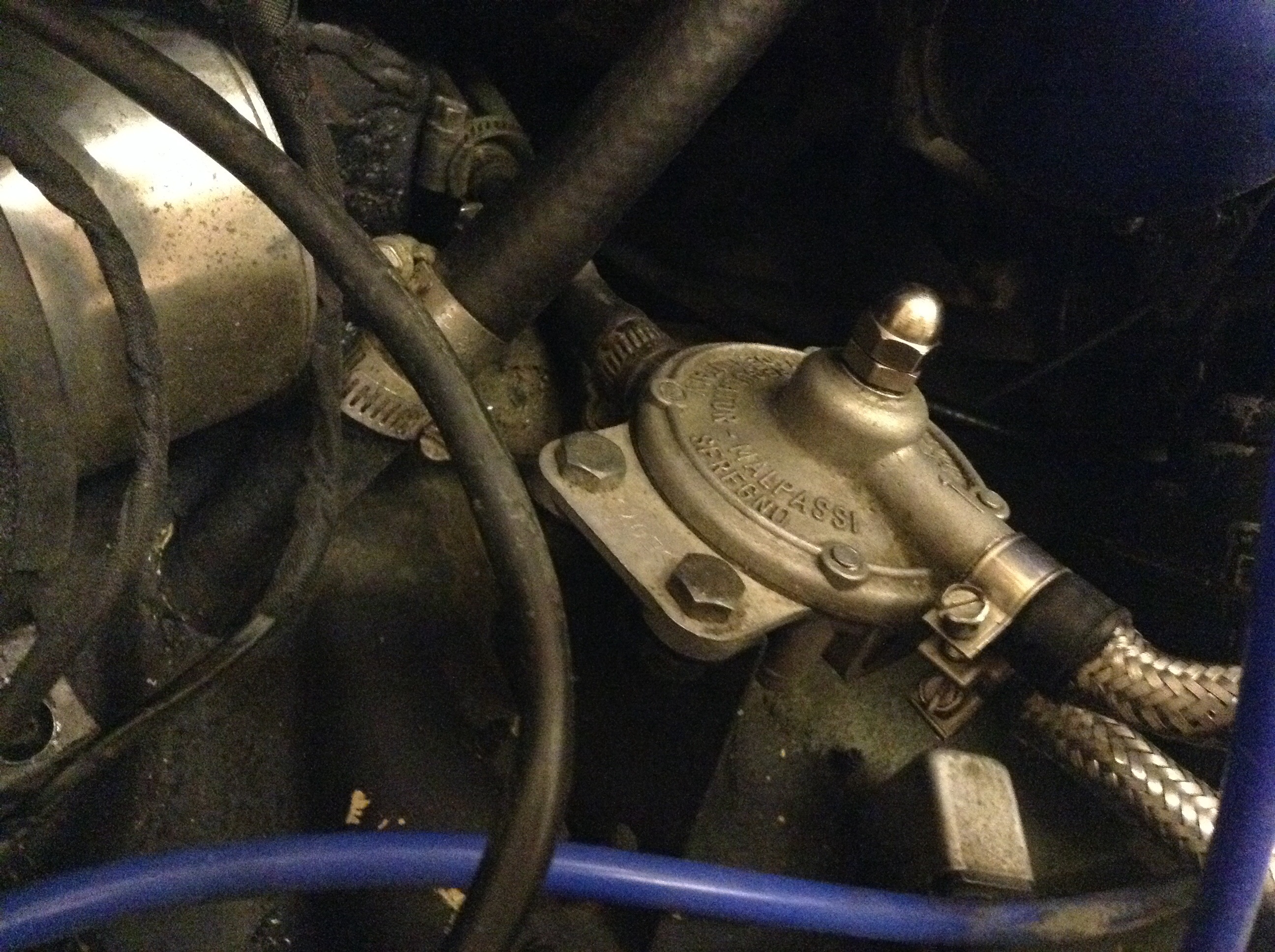

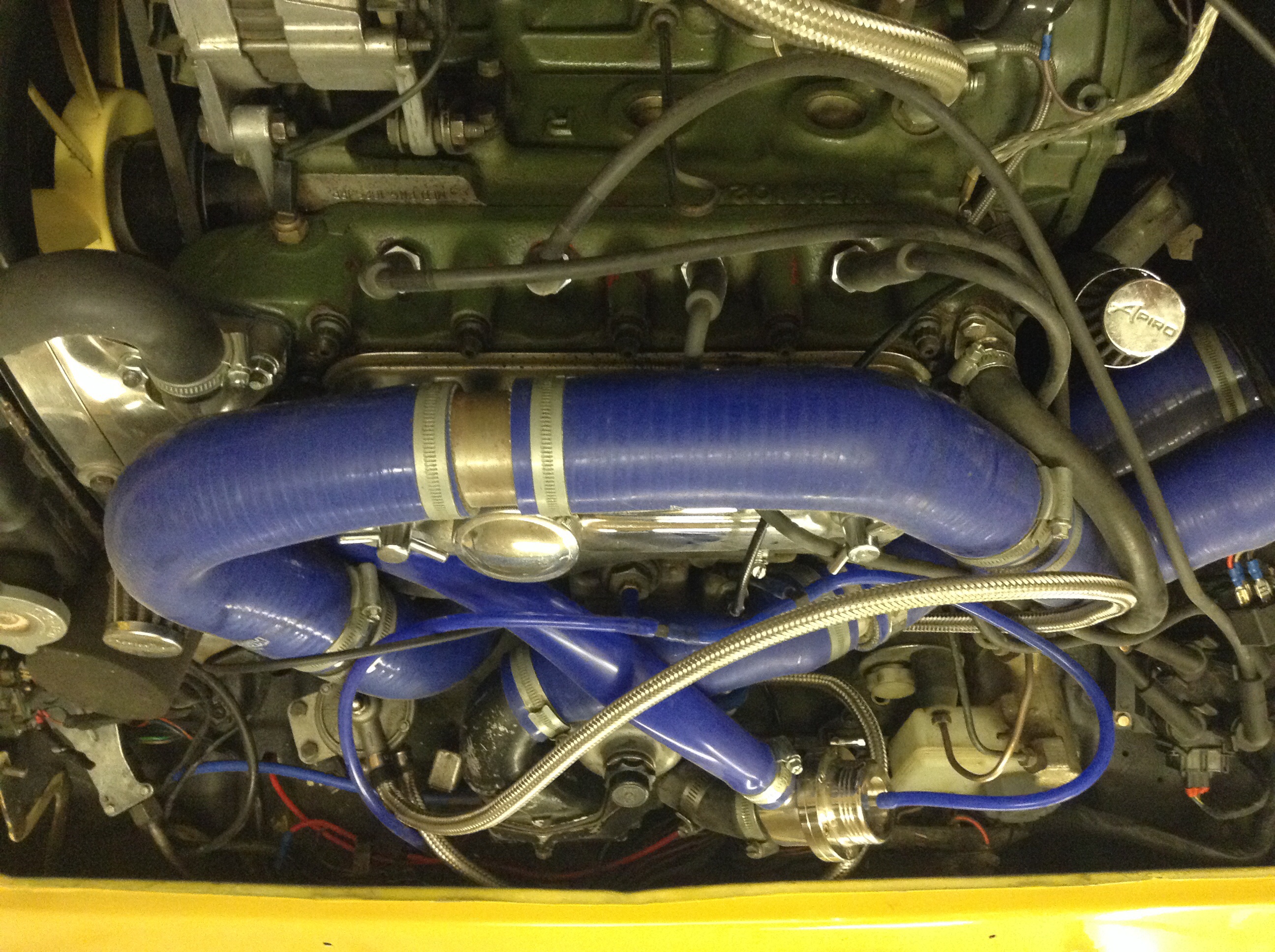

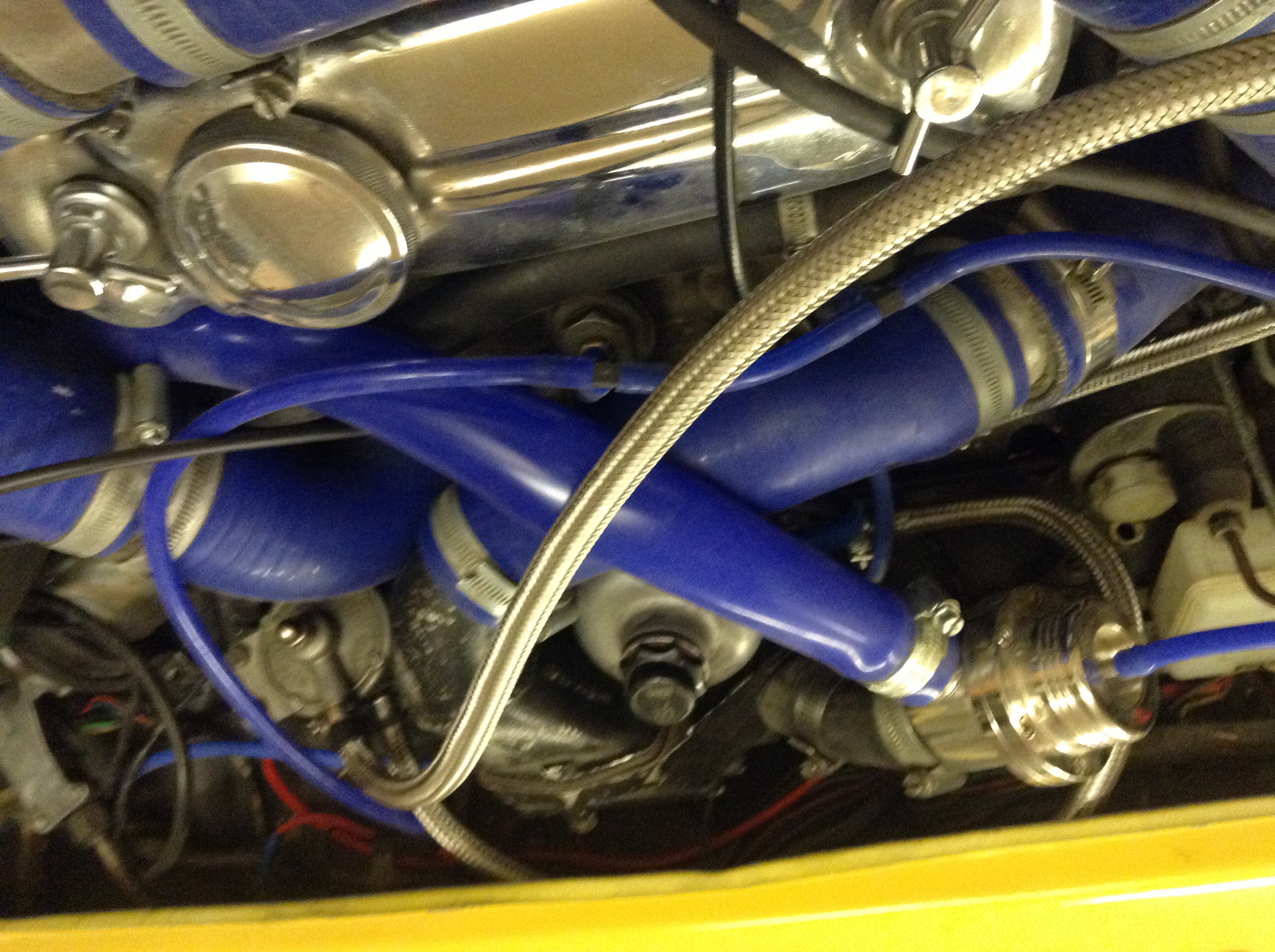

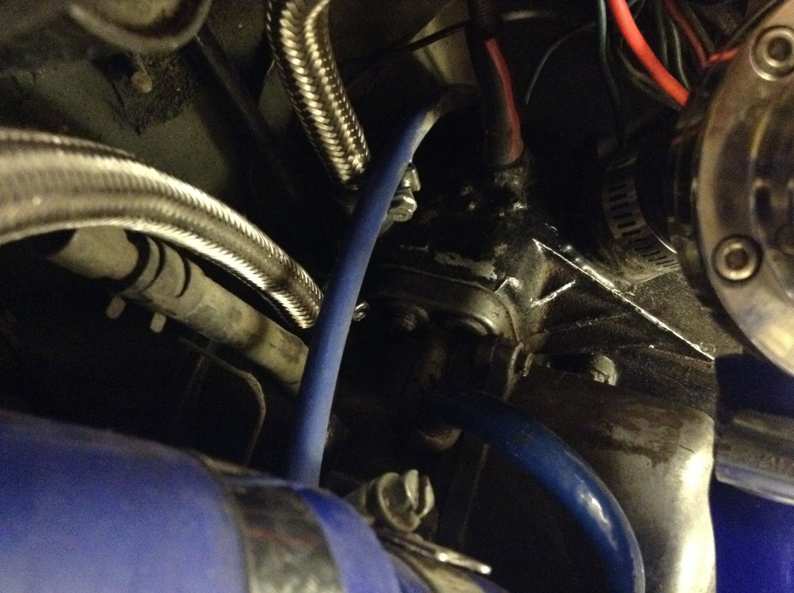

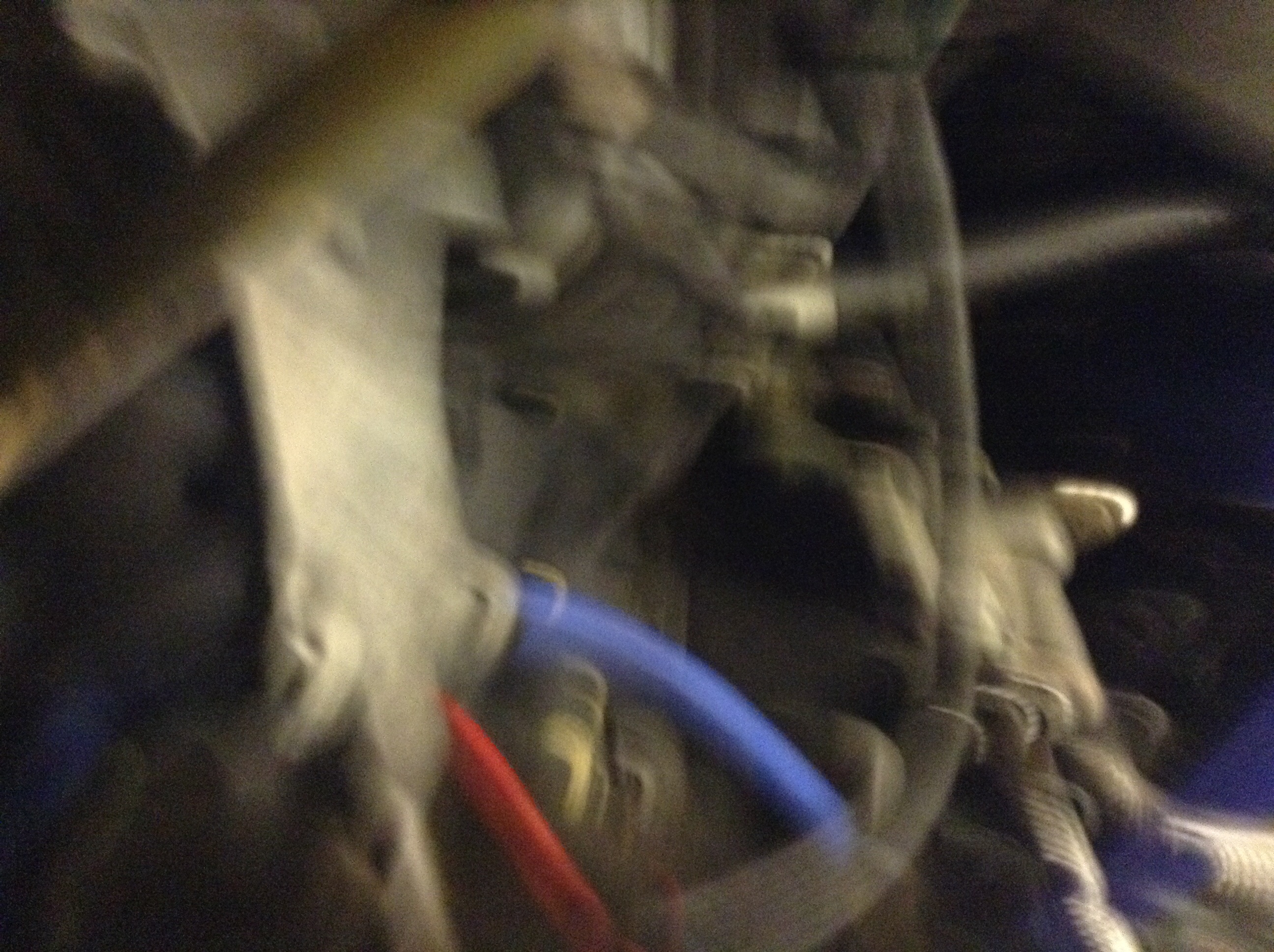

I've just taken some pictures which I will try and upload. One thing I did notice is the nut on the end of the regulator was really loose. I'm assuming this is just a lock nut and isn't the adjuster for the regulator
FlyingCustard
6 Posts
Member #: 11230
Here's some pics
FlyingCustard
6 Posts
Member #: 11230
Some more
