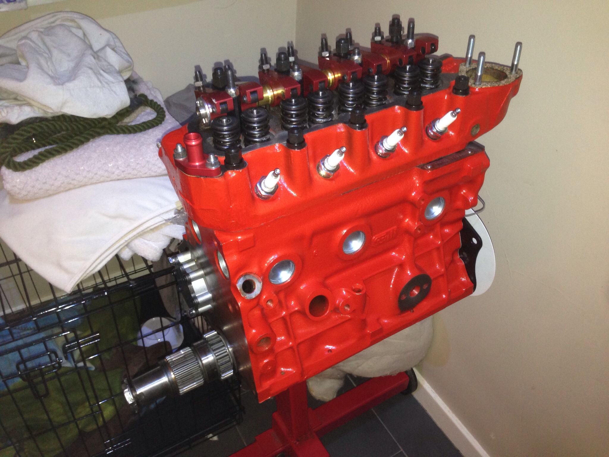

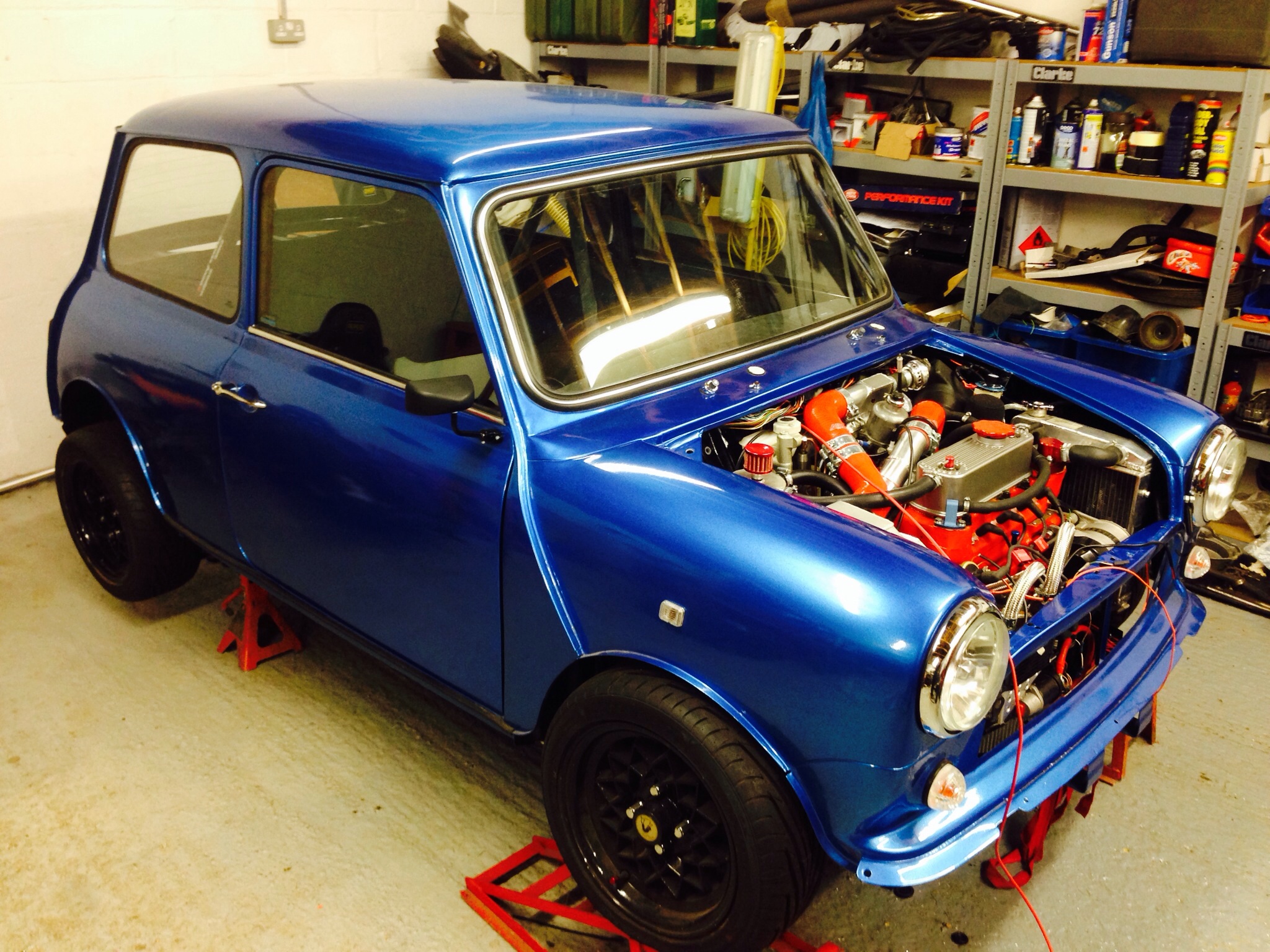

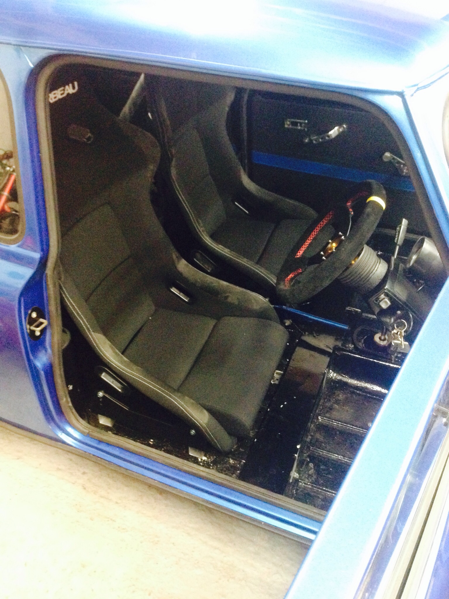

Just want to show my project I've been working on for the last four years.

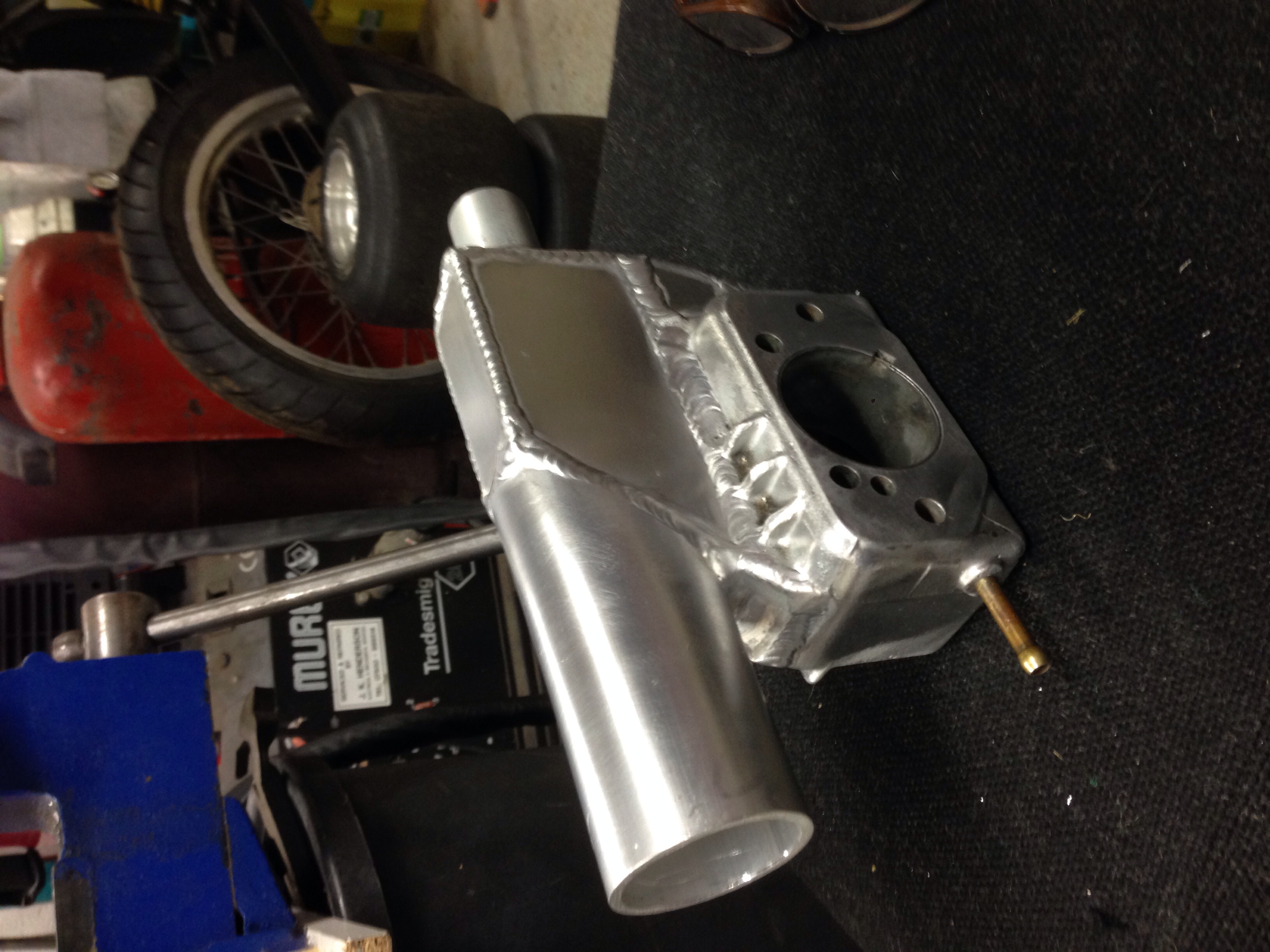

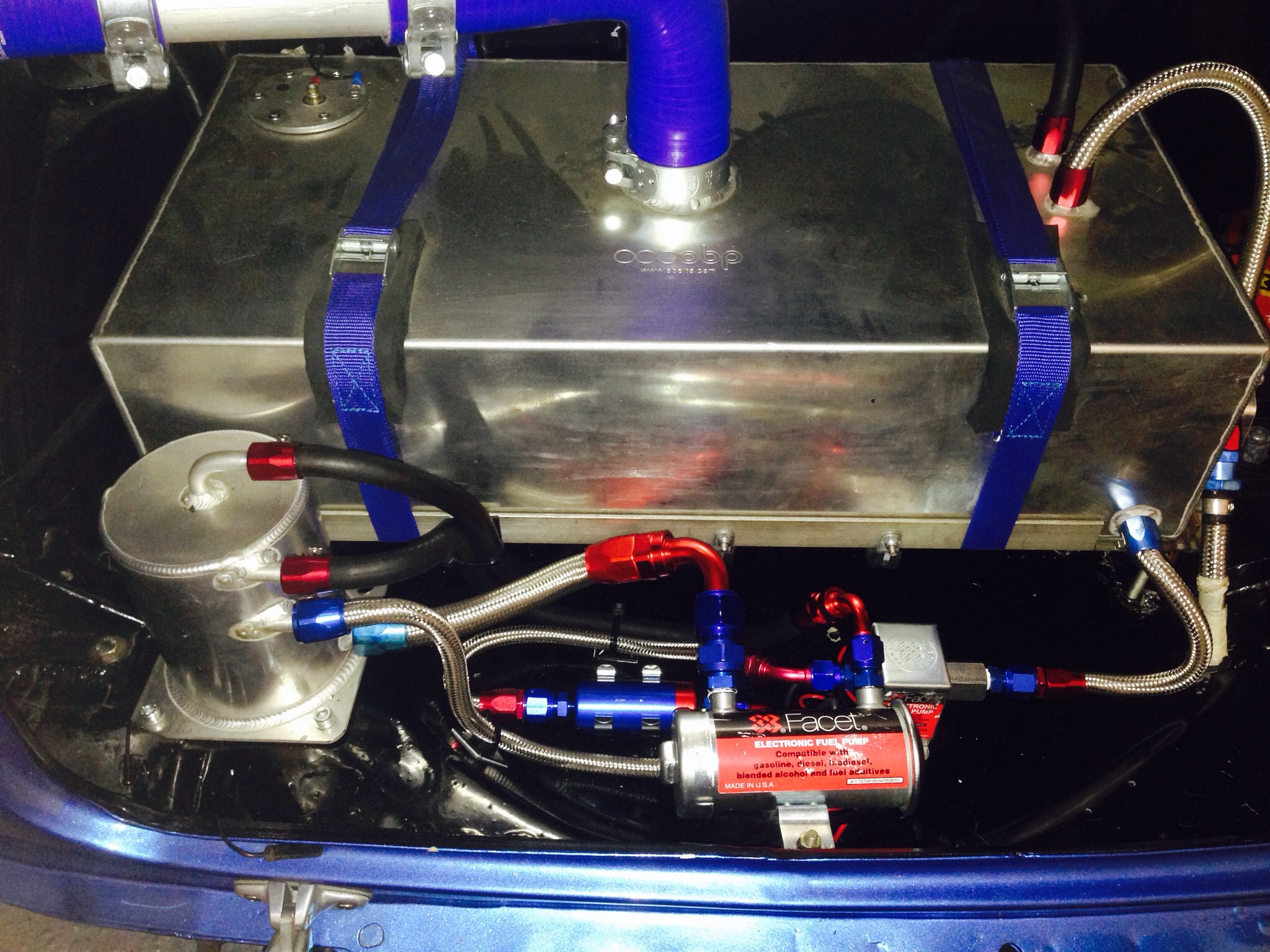

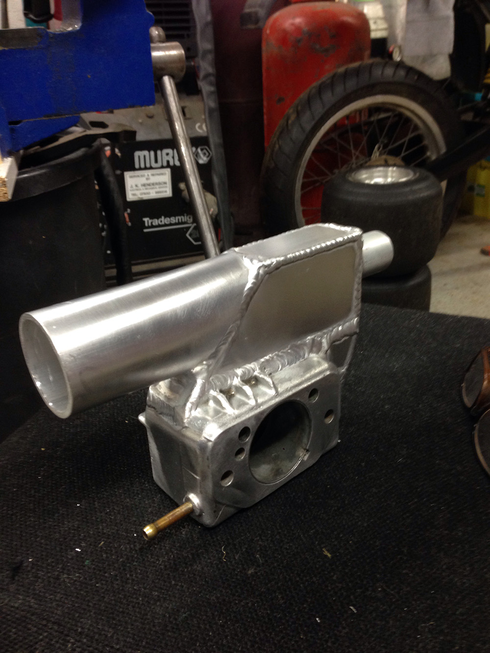

It's been a complete strip and rebuild nut and bolt job, getting to the final stages and really happy with the results, have completed 80% the build myself to try and save the £££s with only the paint job and engine machining done externally, built custom parts for the engine bay to fit everything (found a lot more difficult to fit a turbo in than what I expected). It's been caged and has a real race feel even got a plumbed in extinguisher got a few cosmetics to complete and a aem wideband sensor to fit and commission the interior layout.
Hope it's been all worth it

Greetings... Very nice mate, looks like you've done a very good job! 😁👍
Nice. What is the spec?

1293cc
omega 10cc pistons
Arp rod bolts lightened and balanced
Balanced Turbo crank ACL bearings
Centre main strap
Verto clutch competition pressure plate ap race friction plate and lightened flywheel
Kent 256 cam
High capacity oil pump
Kent vernier timing
Race followers
1.5 roller rockers
24cc head standard valves billet guides
Copper 4cc head gasket
280lb valve springs

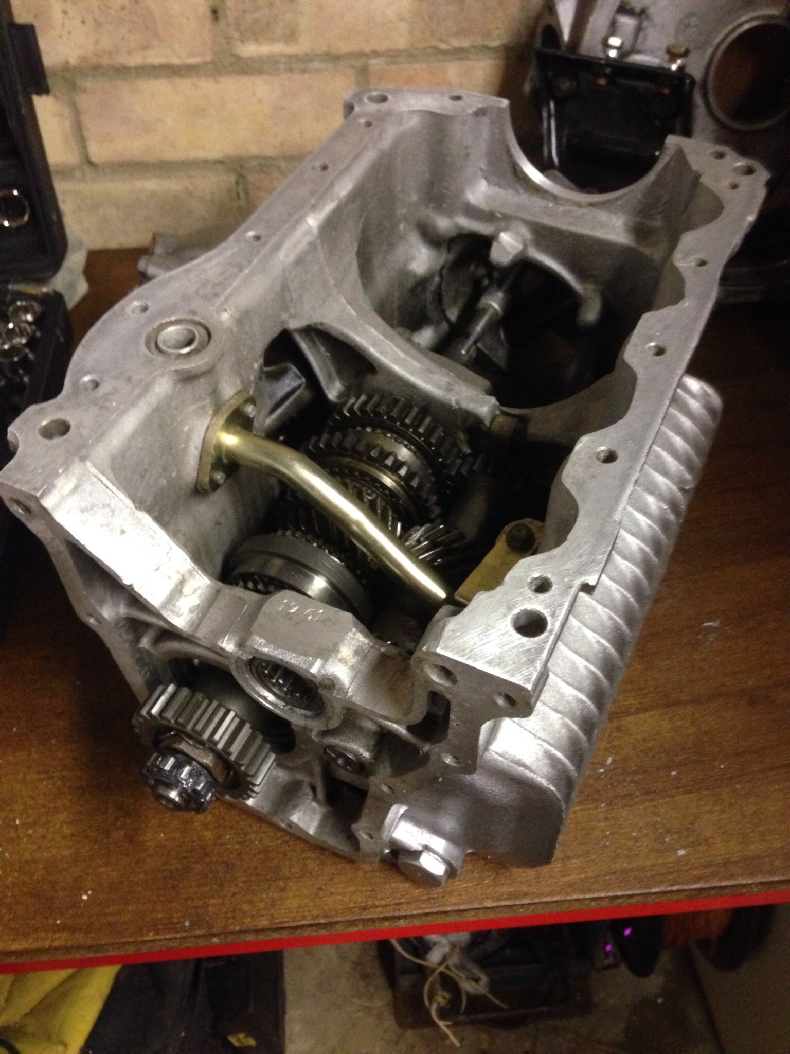

Turbo gearbox centre oil pipe
Straight cut roller drop gear 1:1
3.4 final drive turbo diff

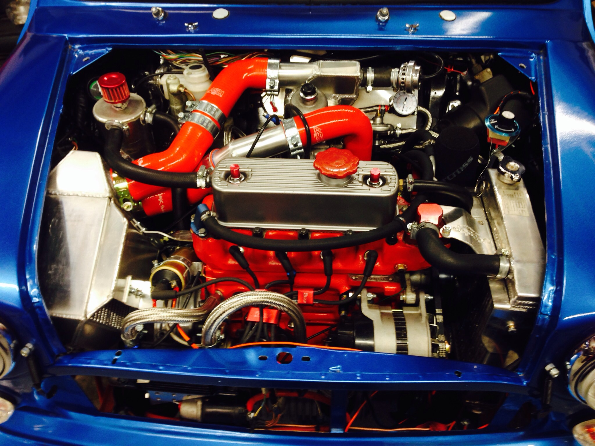

T3 turbo with 8psi escort turbo actuator (bleed valve fitted)
Custom plenum chamber
Ally rad and Renault 5 intercooler
Hif44 carb
