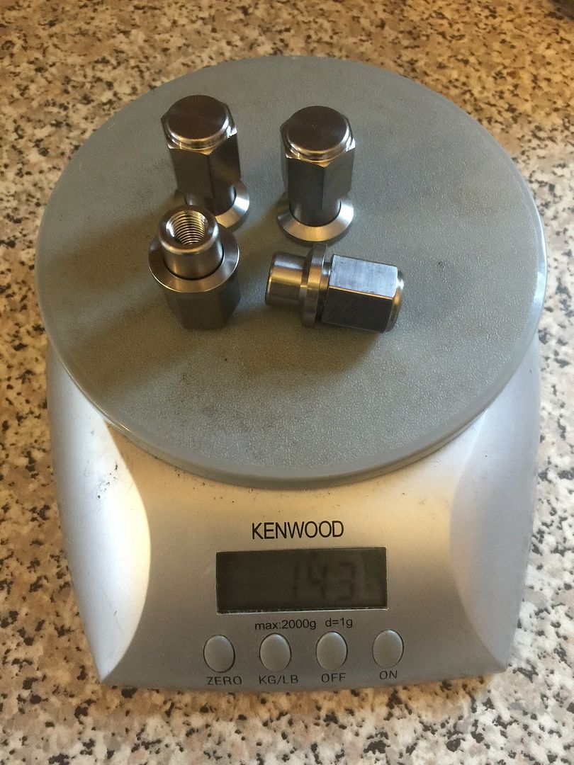

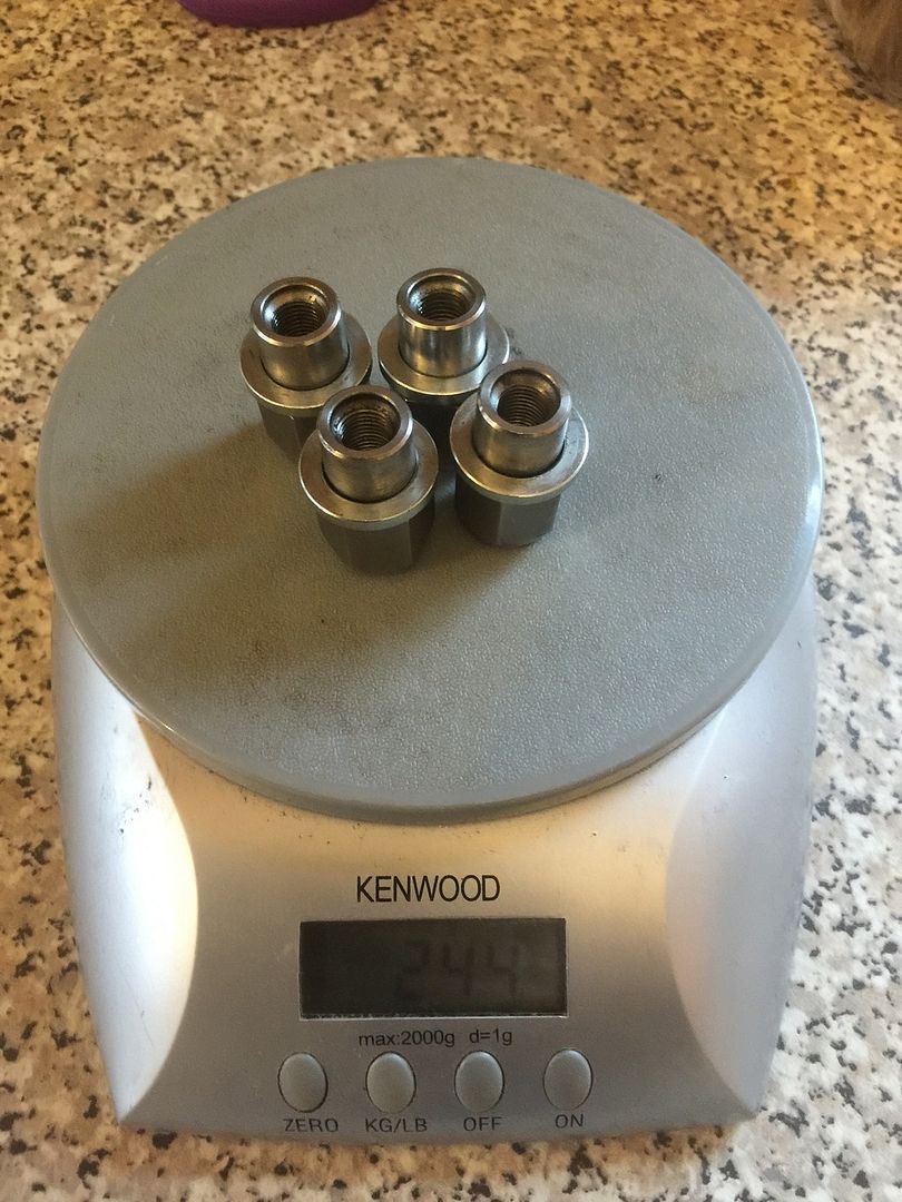

Cost per kg saved is quite high. About £500 per kg.
My new wheel nuts from Simon.
404g saving - Cost £200 = £495per kg

alaskanow0
1434 Posts
Member #: 8466
Mansfield
What's people's thoughts on Ti bolts on split rims. There's something like 64 x m6 x 35mm cap heads on my ST10's. That's about a 190g saving
Edited by alaskanow0 on 23rd Dec, 2015.
Ive been daring myself to do that for years but not done it yet. Not sure theyll be upto the job
I'm not sure I would. A few reasons.
1. Folk who have fitted stainless have had them work harden and fatigue, this says that the bolts are working fairly hard
2. I know Carl is rightly choosy about what he will buy to fit to wheels
3. Carl is the most dedicated man I know about saving weight. If he thought it was a go er he would have done it years ago, and I trust his judgement.
