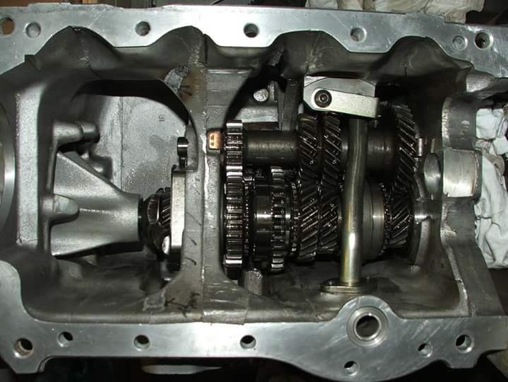

I built one very much similar ensuring every tolerance was at bottom limit. Thats not easy to do as the parts required to set 1st, 2nd and 3rd gears thrust clearances on the main shaft are not available. It takes careful selection of parts from 3 or 4 gearboxes, and may need careful machining of some parts to get it all just right. Swiftune lay shaft, KAD pinion support housing, and the turbo input gear support bearing to complete the package.
The biggest problem with a standard helical gear kit is more that 1st gear is far too short with big torque, almost useless, in my opinion.
