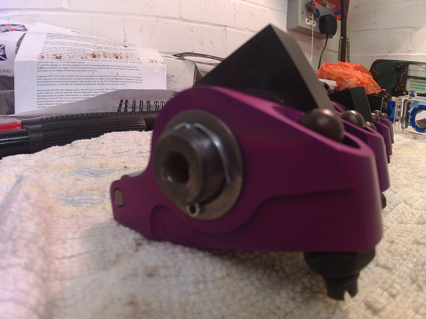

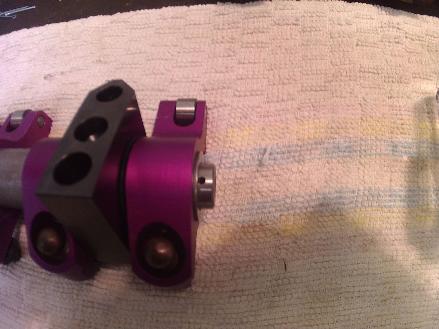

If I build them up using the 'factory' end washer and spring washer, and (initially) the 40 thou shim as per the sheet, there is insufficient rod length to fit anything (shim/washer/spring/split pin) on the other end.
If I remove the spring washer and replace the factory washer with a 40 thou shim I could get them all together and fit a split pin:

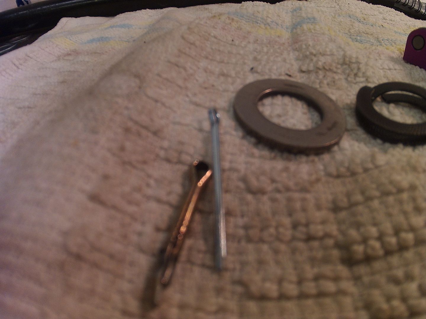

Also the holes to receive the split pins (at either end) are too small to receive the factory size split pin so I'm having to fit a thinner one (poor photo to try and illustrate the difference):
Am I okay to dispense with the spring washer and use the 40 thou shim and thinner split pin (how much side loading will these see)? I haven't yet played around with using the 20 thou shims (to centralise the rollers to stems),

I never bothered with the shims and spacers etc, just used the original spring setup, if it's good enough for standard rockers to not fail, it's good enough for 1.5s

Just use whatever shim combination will get the rockers in the right place over the valves, plus a shim at each end. Mine's been like that for years.
