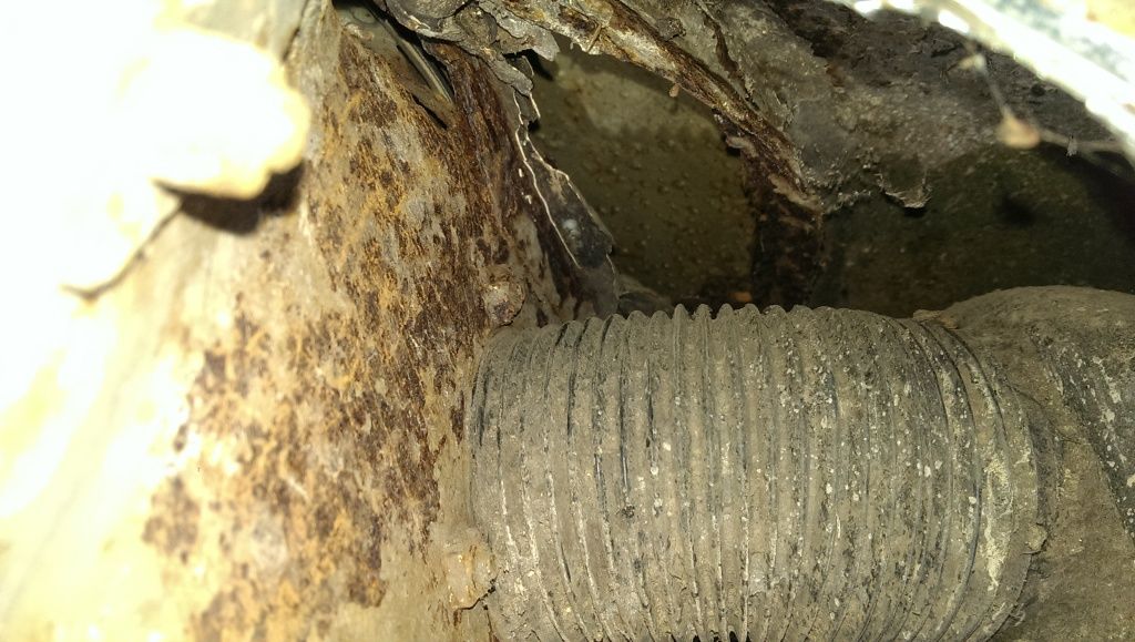

I'm in the interesting situation where the scuttle closing plate has completely disintegrated however the scuttle itself is fine, has anyone tried fitting a scuttle closing plate with the wing and scuttle in place?
Any advise would be gratefully received.
I said I'd do it, there's no need to remind me every 6 months!!
I've managed it in the past but only with a good scuttle; looking at yours, it still looks a bit crusty on the lip.
i did it a good few years ago, its probably the only repair i havnt redone or need to redoo hahaha
i have a removable front though
That is hiding so much more! I can see the inside of the car for a start!

The wires visible in the a pillar?
Nothing gets past Dave lol
Looking at it on the pc, the photo is a great deal clearer. There looks to me a fair bit of corrosion on the inner wing as well. I'd remove the wing and a panel and do it properly. I'd expect the scuttle id probably going to need a degree of repair

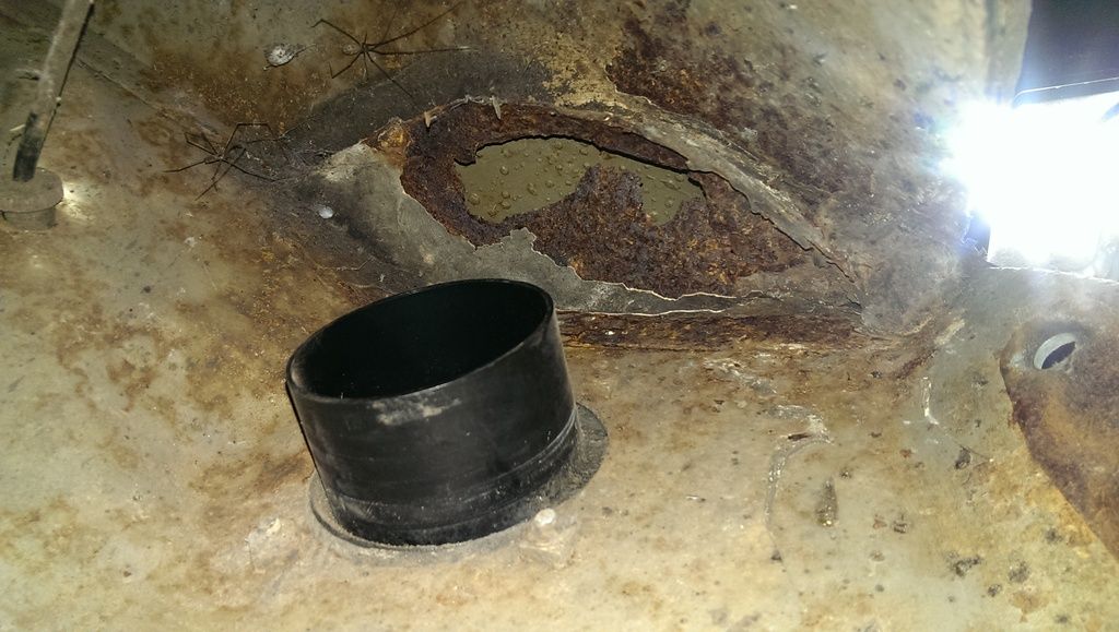

So as a continuation to this I took the wing off to revile this:

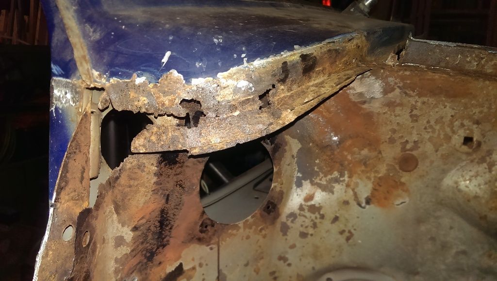

And it looks like I'm going to have a similar issue on the passenger side though not as bad:

Thought it would end up like this. Not too bad.

Not too bad, the norm.... BUT DONT SCARE me with un warned spiders again *wink*

My apologies D4VE, I'll get rid of them before taking any more pictures *wink*

Get it chopped out and stick some new plates in there.
