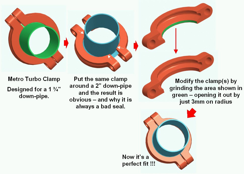

Ok, I did it in CAD, but it shows the problem and solution clearly!*wink*
Big picture - so just click on the link!
http://www.turbominis.co.uk/_iain/up/clamp_mod.jpg
This shows the clamp as modified, the right hand half is 'before' the left hand half is 'after'
