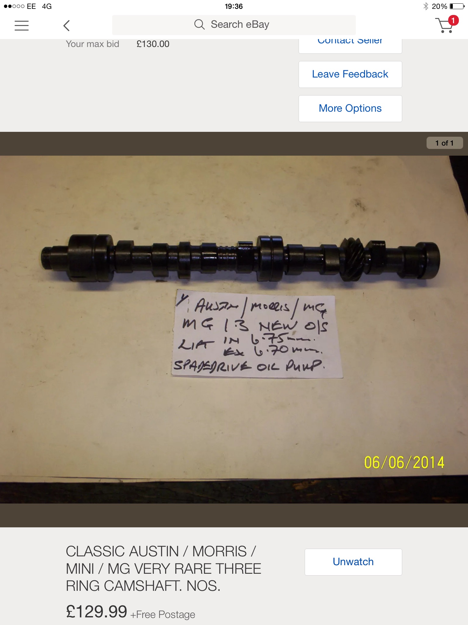

Is this mg metro cam? Not a lot of info really ? Thanks

no it isnt. mg metro cam have a groove not 3 rings

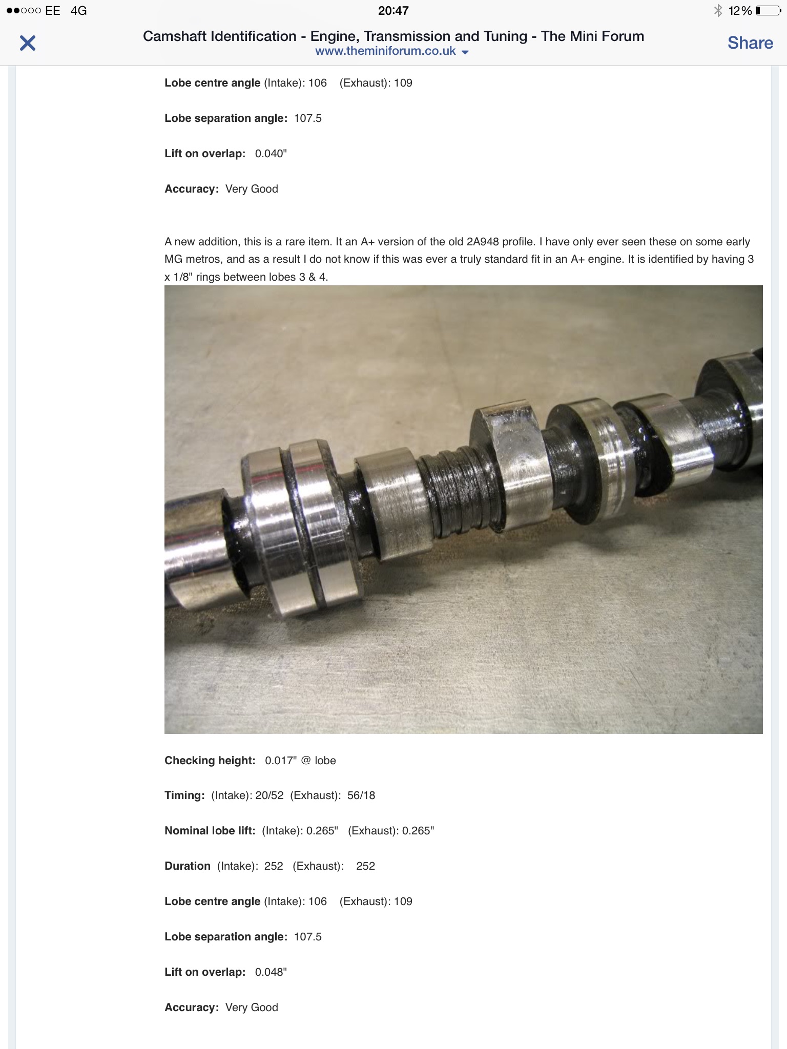

http://miniclassic.yuku.com/topic/5261/Lis...es#.VrJkVbLhDIU

It looks to be this? Would it be any good in standard turbo engine?

That seller always has misleading notes
MG metro cam is 16/56 59/29
That is 20/52 56/18
Pretty short duration and overlap. I don't know what it is, probably a standard 1275 cam (someone will know) Would work but hardly worth it.

Its a standard a+ non economic cam.
That cam was used in the cooper SPi
Could be anything, looks like a regrind
