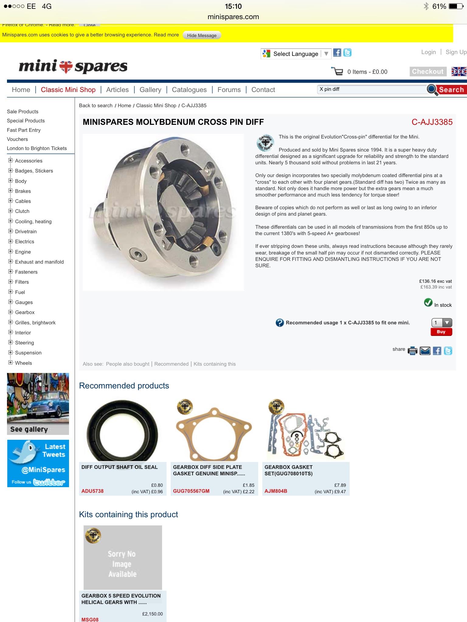

X-pin diff 100%
Jonnyturboboy
72 Posts
Member #: 11251
This any good what best buy for money?
That's the one!
