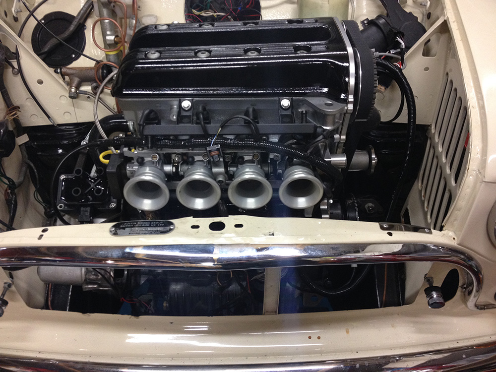

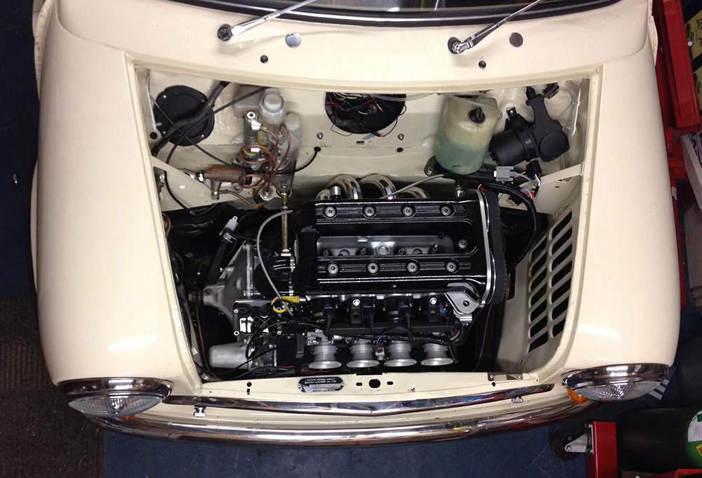

Hi Pickup
Other option which does work (see pics of mine) is to lower the right hand mount (rad side) 10 mm to 15 mm by using the older style pressed steel engine mount and modifying it. Sounds a bit drastic but allows the top of the cam cover to clear with some adjustments to the inner bonnet stiffener. I had some big issue getting my engine to sit in my MK one as the manifold was very close to the bulk head and tight to the slam panel with a filter fitted.
All up and running for the last year and making very decent power. If your looking for decent filter that works talk to TIG they made me a filter to fit and this despite being a single sock and some reservation when we start the mapping the engine made more power than running bare trumpets.
Good luck
