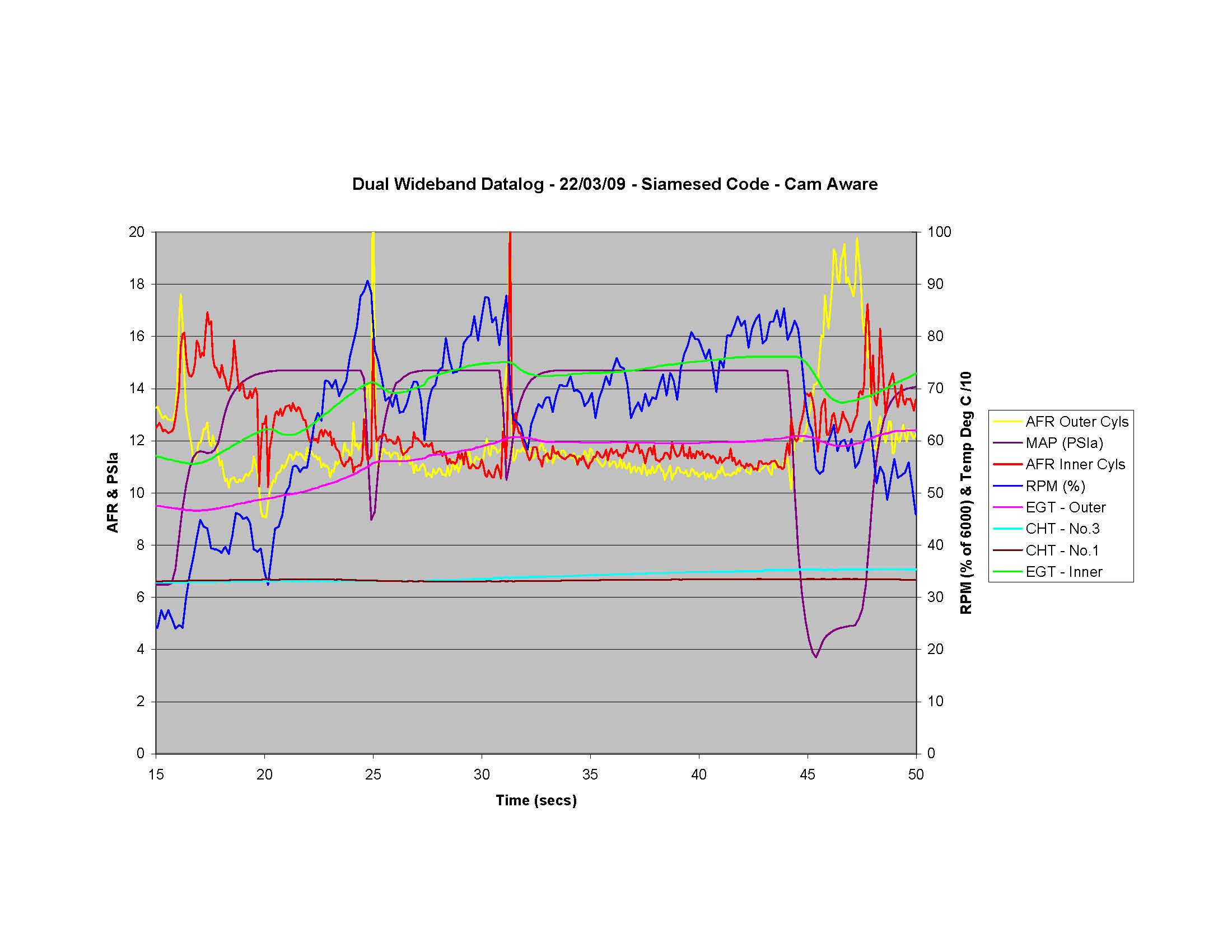

Go back and find Paul's data... When you have twice as much exhaust going through the centre branch, it runs hotter so makes comparing the inner vs outer difficult / impossible. While you will see patterns, interpreting them would near impossible without already knowing what they mean (i.e. having 2 lambda sensors already plugged in there).
Having said that, SC used 3 thermocouples and suggested the data was useful.

The centre port runs slightly hotter, but the fact that the thermocouple gets has two doses of exhaust gas per cycle means that it reads considerably hotter, around 120 Deg C on my engine.
Then you have to consider that the EGT is hottest around stoich and falls either side.
I've never been able to reconcile what to do with the data, other than to verify a simulation.

Datalog from 2009, uses the Innovate TC-4 and MTS datastream, NA 998 before fitting the turbo and the code was still in the development stage but you can see the big difference in inner and outer EGTs.
Data from a simulation, this time a turbo 998 but shows the reasons for the big difference:

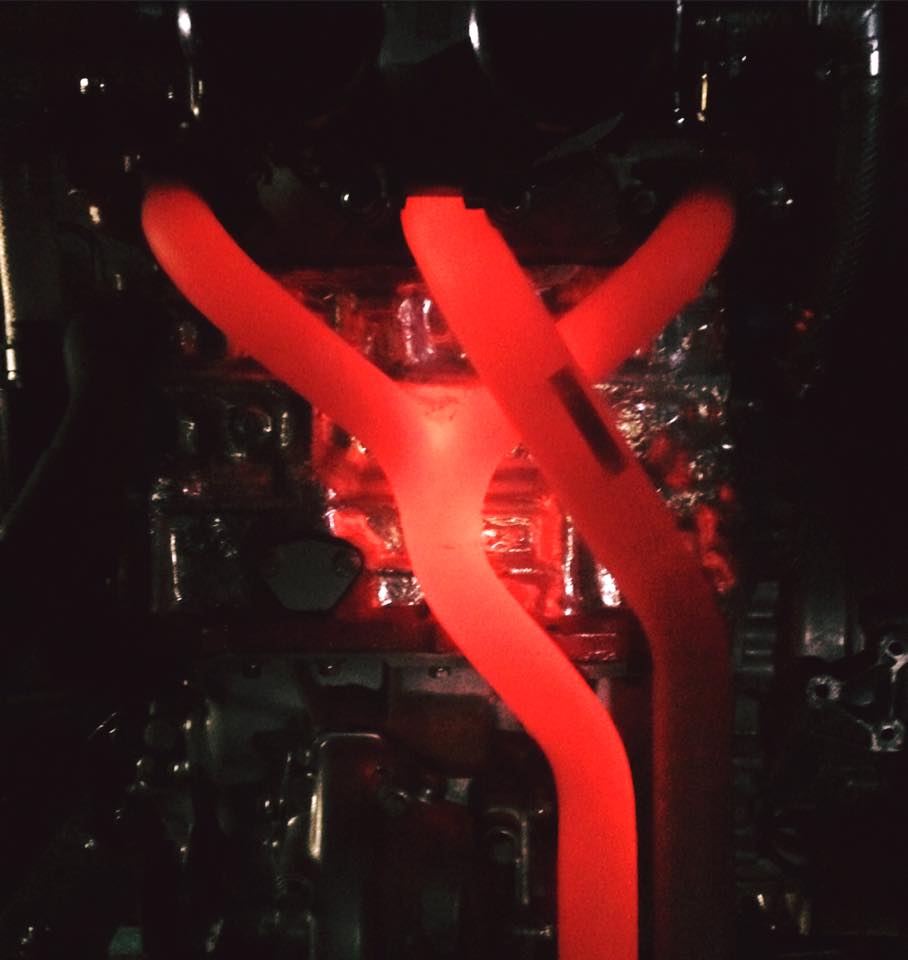

Swiftune just posted this picture on Facebook:
Very interesting.
Grab the toasing fork!!!

That looks like not only is it way too lean or retarded but that there's a distinct AFR mismatch between inner and outer cylinders.
doesnt this echo what a member touched on before withdrawing from the forum?

Or it's showing they forgot to fit the turbo !

I don't think that the difference in LCB leg temperature is anything to do with AFR imbalance, if there is any.
More differences in VE and carry over of fuel on overlap.
Even though the centre LCB leg looks hotter at the head flange, it quickly cools whereas the outer cylinder leg gets hotter!
You don't think that these would result in an unbalanced AFR?
