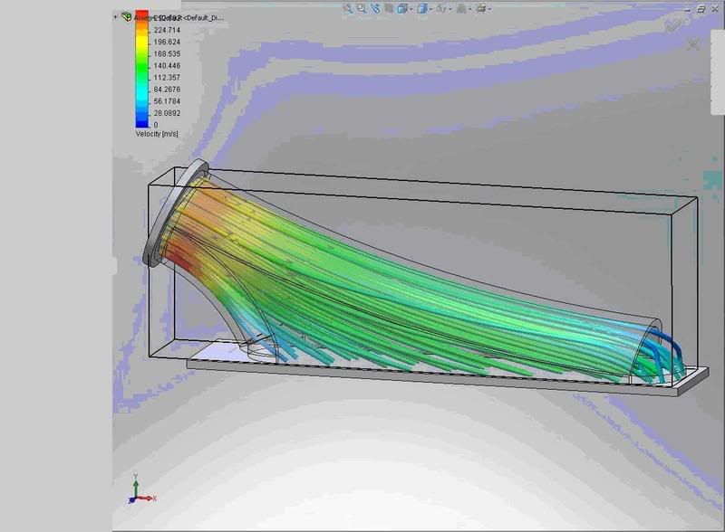

Chaps, some of you may know I'm going to run twin 40s on my Vauxhall engine. I was planning on building an ally airbox slash plenum with an outlet on the side for remote filter.
Question is will the shape makenany difference in performance?

Apprently it does.
Entering the plenum one side, the flow will favour one side, tapering away creates even flow to each runner
David.
Cheers for that pic mate I'd had a tapered box in mind to start.

NA ? Or turbo ?
Careful how you interpret that flow simulation.
The ports flow one after the other not all at the same time.
The cross sectional area of the part of the plenum feeding the furthest port needs to be just as big as the rest of it.

The way it reflects the induction pulses will be of consideration too. If you make it curved like in that picture it will scatter them. Sometimes this is good, sometimes not. Only dyno will tell for sure. Also a lot depends on what space you have available to fit it all in really.

In which case I'd suggest a massive box with a cold air feed. Make the box big enough to avoid any specific flow issues.
