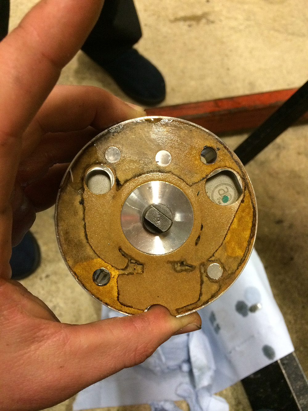

My pump on removal,
I've not got any engineers blue, however it measured 41mm between the oil ways on the pump
41mm is tight
jonny f
2096 Posts
Member #: 9894
Dorking
Looks a duff one to me!
Oli
1733 Posts
Member #: 1910
Wilts
New pump measures 45mm across the centre, that should do the trick!?
Certainly sounds more in line with expectations. Bet your glad you checked it now!
