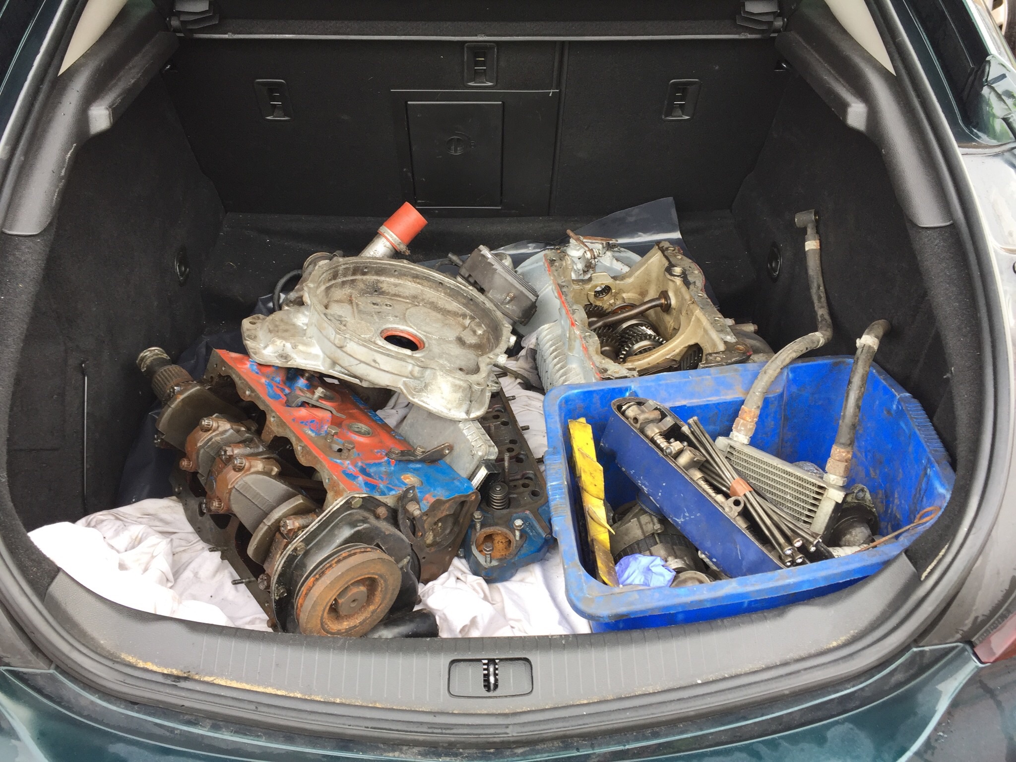

The engine that's needing a little love to restore. But generally all good... I think

I have roughly measured the bores and all seems ok so far. Used internal calipers and micrometer. Need some advice an where to get new piston rings? Have ordered an internal mic to check correctly the bores are all good. There is residue around the top of the bore that wants cleaning. How is this best done?
How can I tell if the head is leaded or not?? And what's the best / cheapest solution if it's not??
So many questions....
