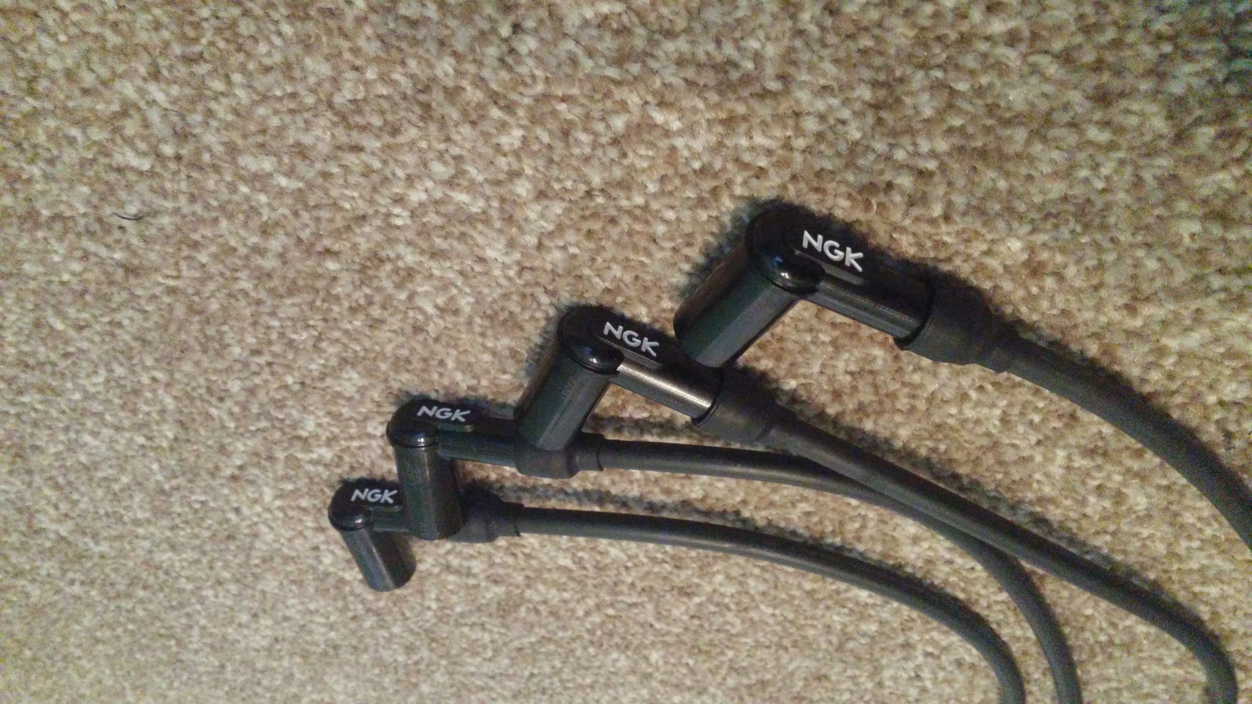

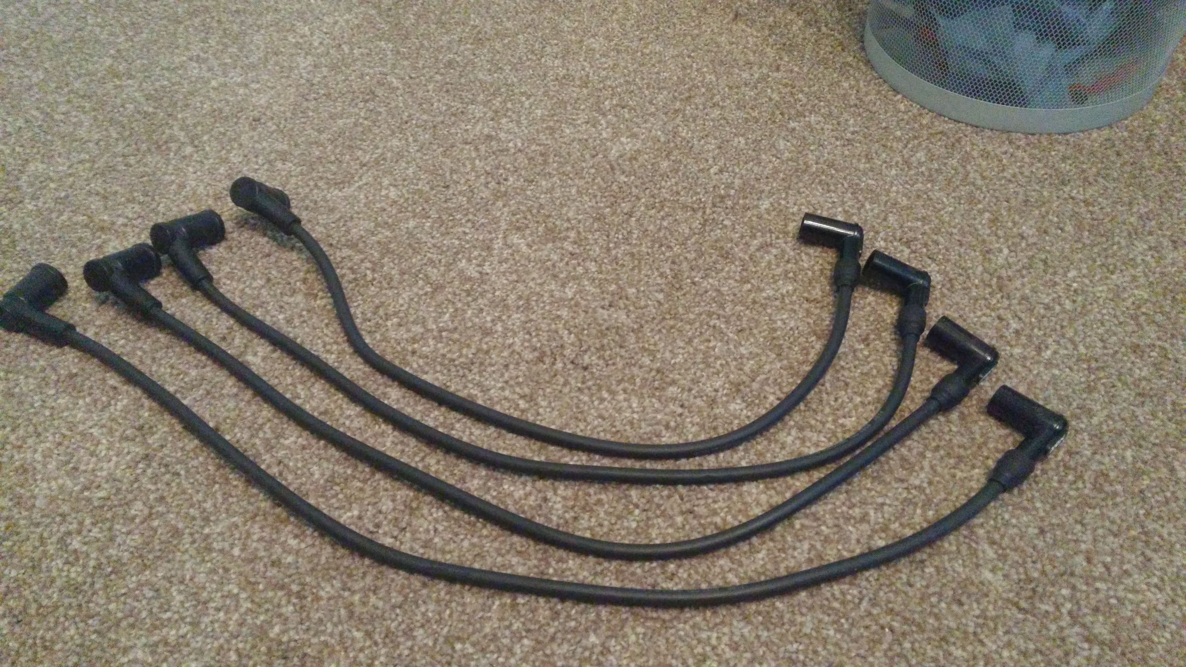

I've not long cut down some Ford ignition leads from eurocarparts for Shaunas, and fitted old school screw on type NGK plug caps, they're technically not the correct core type for the caps but it's worked perfectly fine so far for a few months.
As above

Copper core is non resistive and needs resistive caps as i fitted above (removed resistive plugs to compensate) and the carbon core (as the leads above are) which are already resistive and don't require resistive caps. But aside from that I'm not sure of the drawbacks or benefits of the different types.
