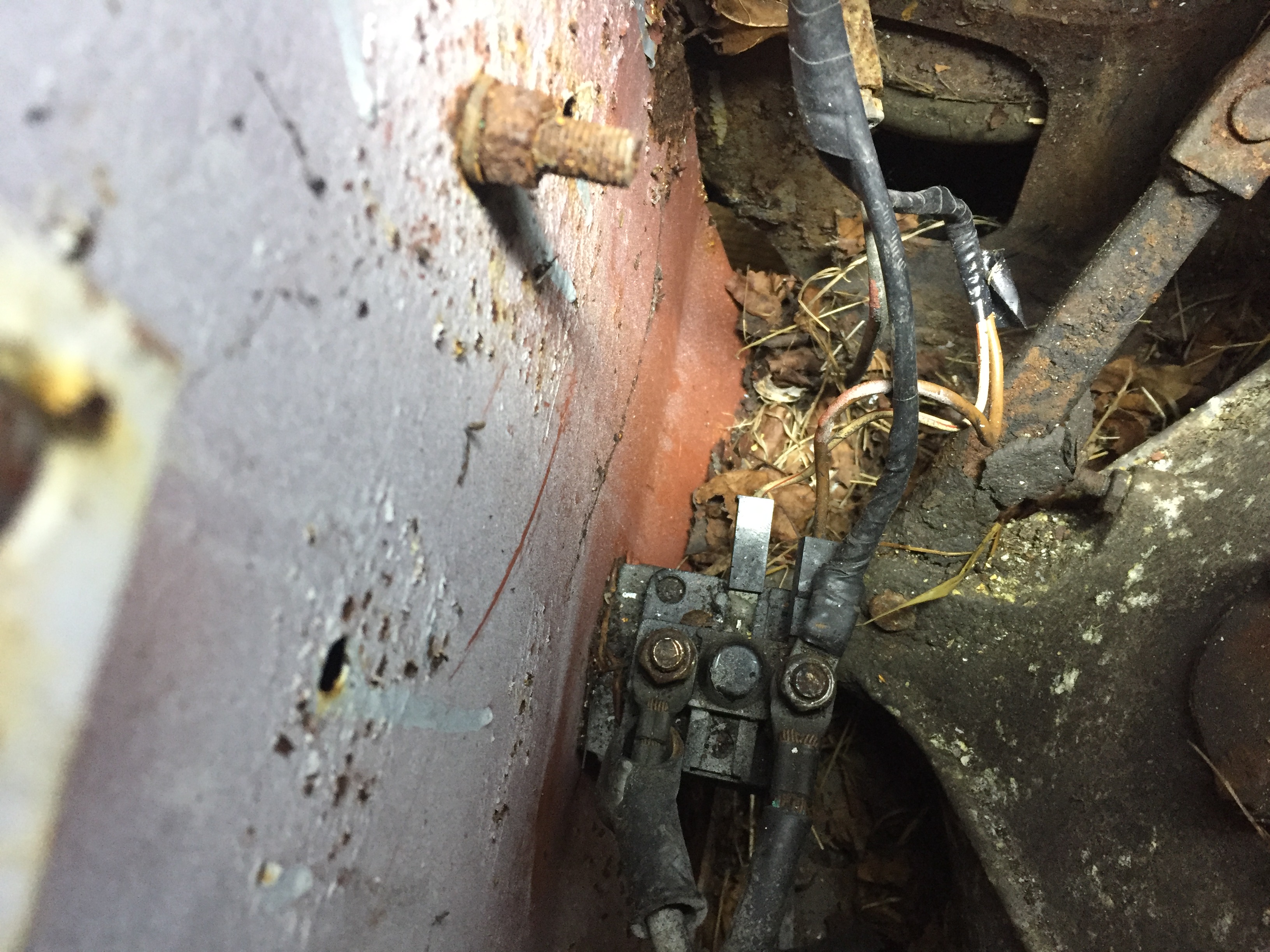

Hi Iv been trying to sort the electrics on my new mini van project, I'm not sure what year it is but after looking into it it mite be a 1983 as I think it's got ballist coil electrics, can someone tell from this picture please

The starter solenoid look like a four way one ?
I would say three, the fourth is usually on the opposite side to the start signal, the other one in the picture is just power feed to the ignition switch or fusebox or similar.
The extra (missing in your photo) terminal would be the ballast resistor bypass so not a ballast ignition system (or, if it is, it's not connected right)

Ok cheers rod, il get one ordered,
