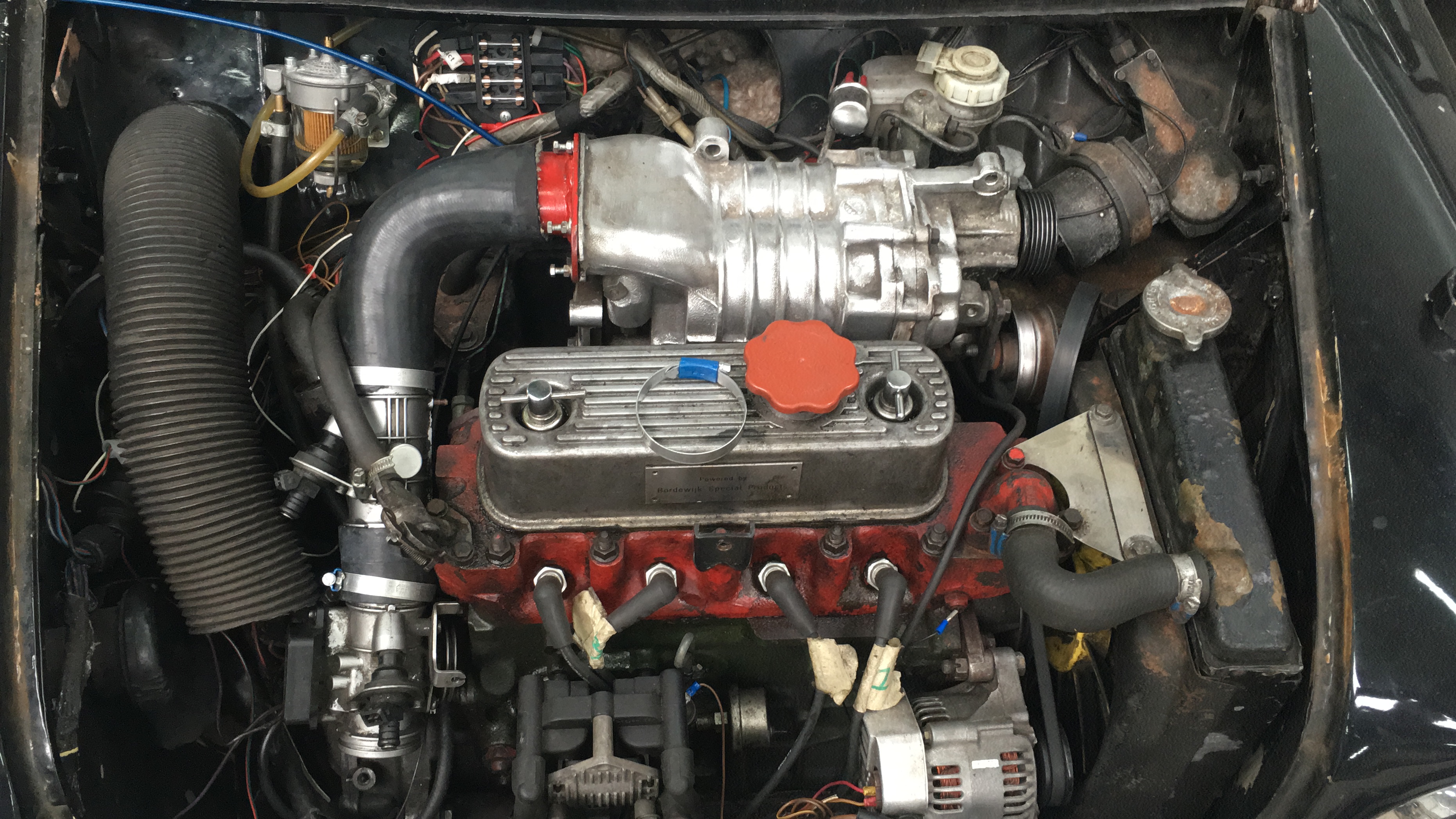

Hi all,
Time to finally get rid of the HIF44 on the 1293 with M45 compressor (poorly made V-max clone setup). Already running a Megasquirt but only for ignition. The plan is to fit twin TB's off a BMW Rt1150 bike and let one run from 0-max revs and let the other kick in from about 2k onward. Has anyone tried this?

Got it going:)
Current issue is the front TB's butterfly isn't sealing at idle but otherwise quite pleased with myself*wink*

Looks interesting. Is it two TBs in series, one without a butterfly?
Arnoud
160 Posts
Member #: 1085
Netherlands
Correct. Still needs fine tuning but looking for another TB first; this butterfly is leaking so bad that I can't get it to idle below 2k.

Sofar it's running fine. There's a Pressure and air temp sensor in the inlet manifold. I found a Volvo coolant temp sensor which goes where the old one was. First cold start is still an issue and it seems to run out of steam under max throttle but both are solvable. I'm getting another R1100 TB because the current one leaks massively past the butterfly so idle speed is 1500rpm atm.
