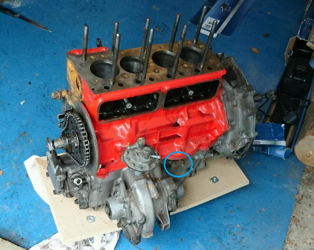

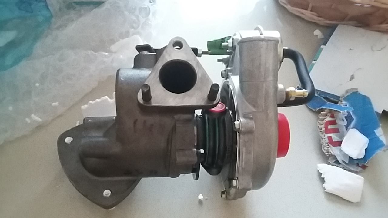

So today, the GT1549 bought arrived and tried to begin planning on fitting it. Its quite a little bulky to be fit, but I'll think I manage to fit it just below the firewall cross member.
With regards to fitting it are there any guidlines I should follow or be aware of ? So far I know that the turbo should be positioned above the "max" mark of the dipstick to let the oil from the turbo drain off to the sump. I also know that the exhaust runners should be preferably equal in size.
With regards to oil feed I was going to use a tee off the pressure switch, and since I'm positioning the turbo a little bit downwards to save the cross member from being cut, I was going to use the blanking plate seen in the attached photo as the oil drain.
Is it a good spot to drain off the oil from the turbo ? Else I would use the place of the mechanical pump, that would be as much as the same height as the turbo shaft.

Thats plea has the oil pick up pipe on the other side. Return it somewhere else or you'll be feeding the oil pump/crankshaft etc hot oil.
