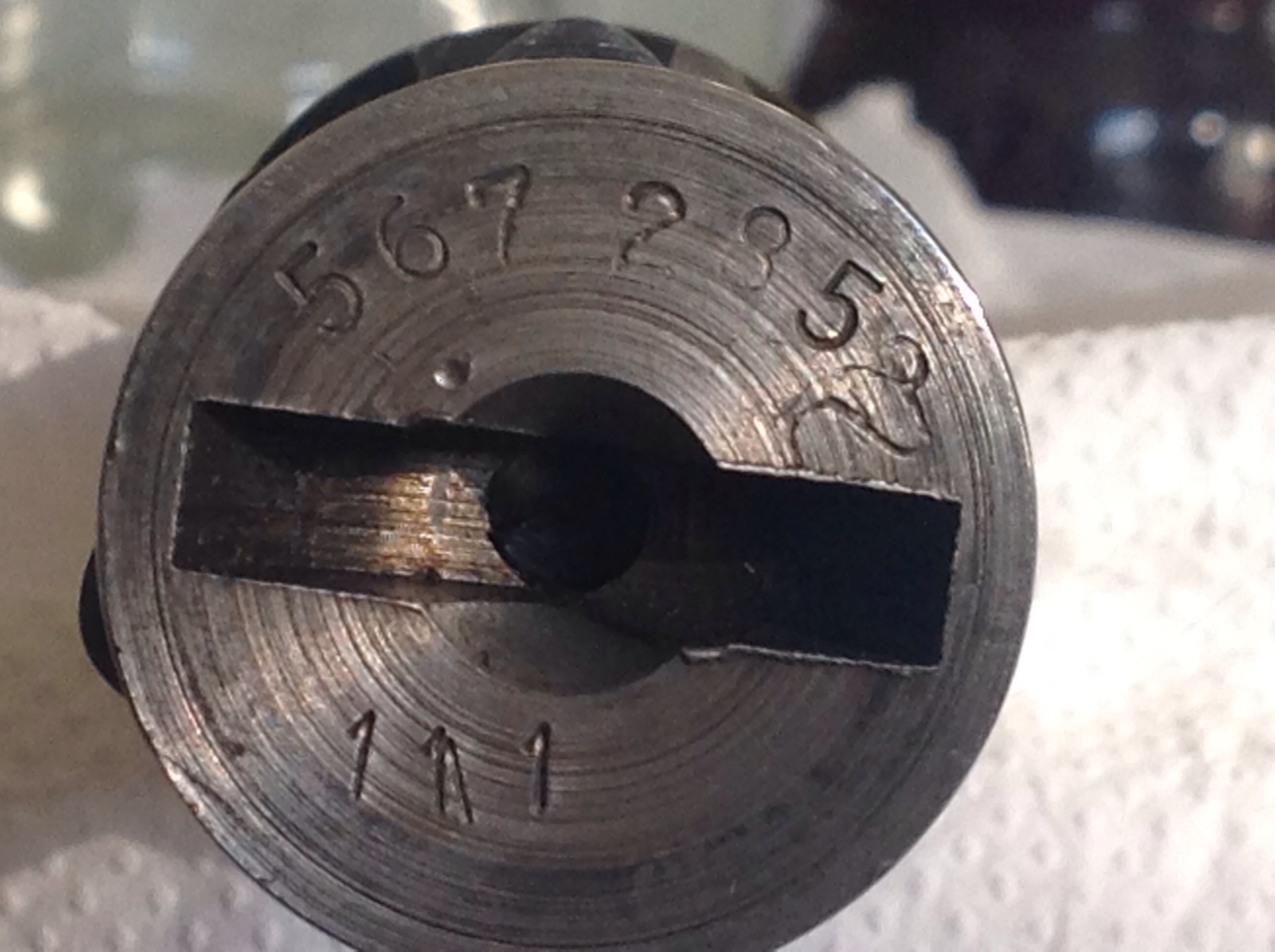

Greetings all,
Purchased this cam from mitp few years ago, it had avonbar ph2 handwritten on the box but unsure if it is actually what its described to be. Will this be ok to use in 1380, t3 turbo, Standard dizzy, big valve head?
It has 567-2852 stamped on it
Thanks

Looks like a Piper 285/2 which is the symmetrical version of the 285. Shite in a NA 1380.

Rang avonbar today and they said it must be one of their early turbo cams. They said the later turbo cams were developement from this cam, so should be ok to use in a turbo.
