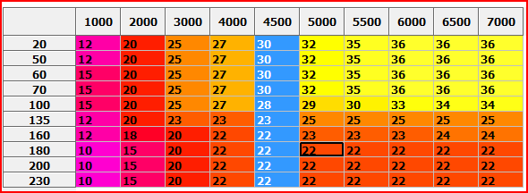

I'm pretty much at the stage where I can fire the car up for the first time, I need to 'knock in the cam' could I do this on the edis or should I use a base map on the MJ?
Also would it be possible if someone could send me a safe map for my spec to get it running before I take it to a rolling road to get set up.
1293cc
gt17
8.46:1 CR
BDD needle
kent 266
plan to run 8-10 PSI
Cheers Liam
Edited by Toad on 29th Jul, 2016.
Toad
27 Posts
Member #: 10162
West Sussex

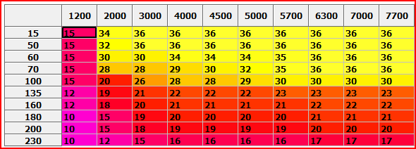

I have two maps, one of which came on the MJ and the other I found on here, it was titled 1293 turbo but didn't list any other specs so unsure if its suitable.
This is the one that came on the MJ:
1293 turbo map found on here:
Any of these suitable till I can get to a rolling road?
