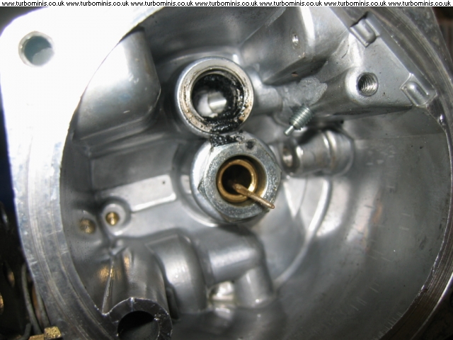

A picture of the carb upon rebuilding:
This didn't help fuelling in top, that's for sure!
Edited by Vegard on 19th Apr, 2006.
