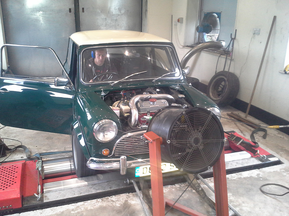

looking for some help!!!!!! I have just had my Metro turbo engine and gearbox rebuilt, I have fitted it back into the car and it fired up okay. The engine builder who specialises in race engines has a rolling road and offerd to set it up for me as part of the build.
When we first ran it up on the rollers it was running lean at the top end and we found the problem with the carb and sorted that, We ran it up again and there appeared to be no or little boost. The gauge showed -20 on idle and 0 at 4500 rpm at around 5500 the actuator stared to operate.
