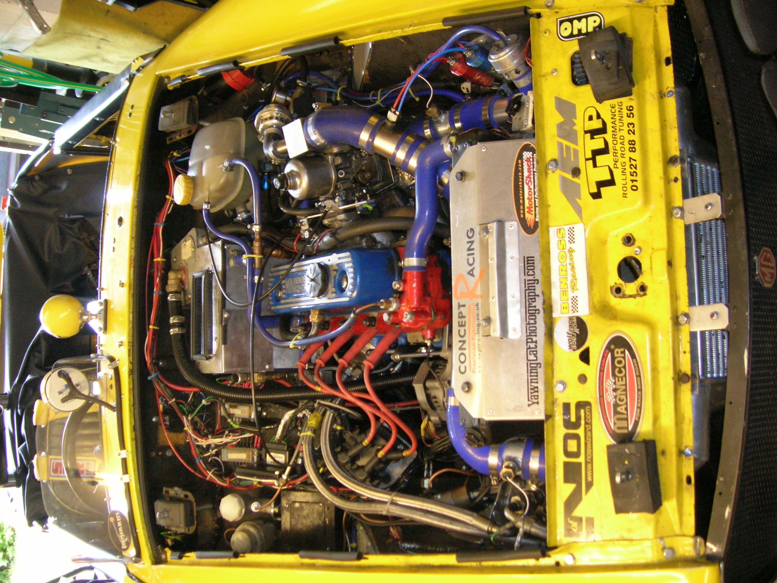

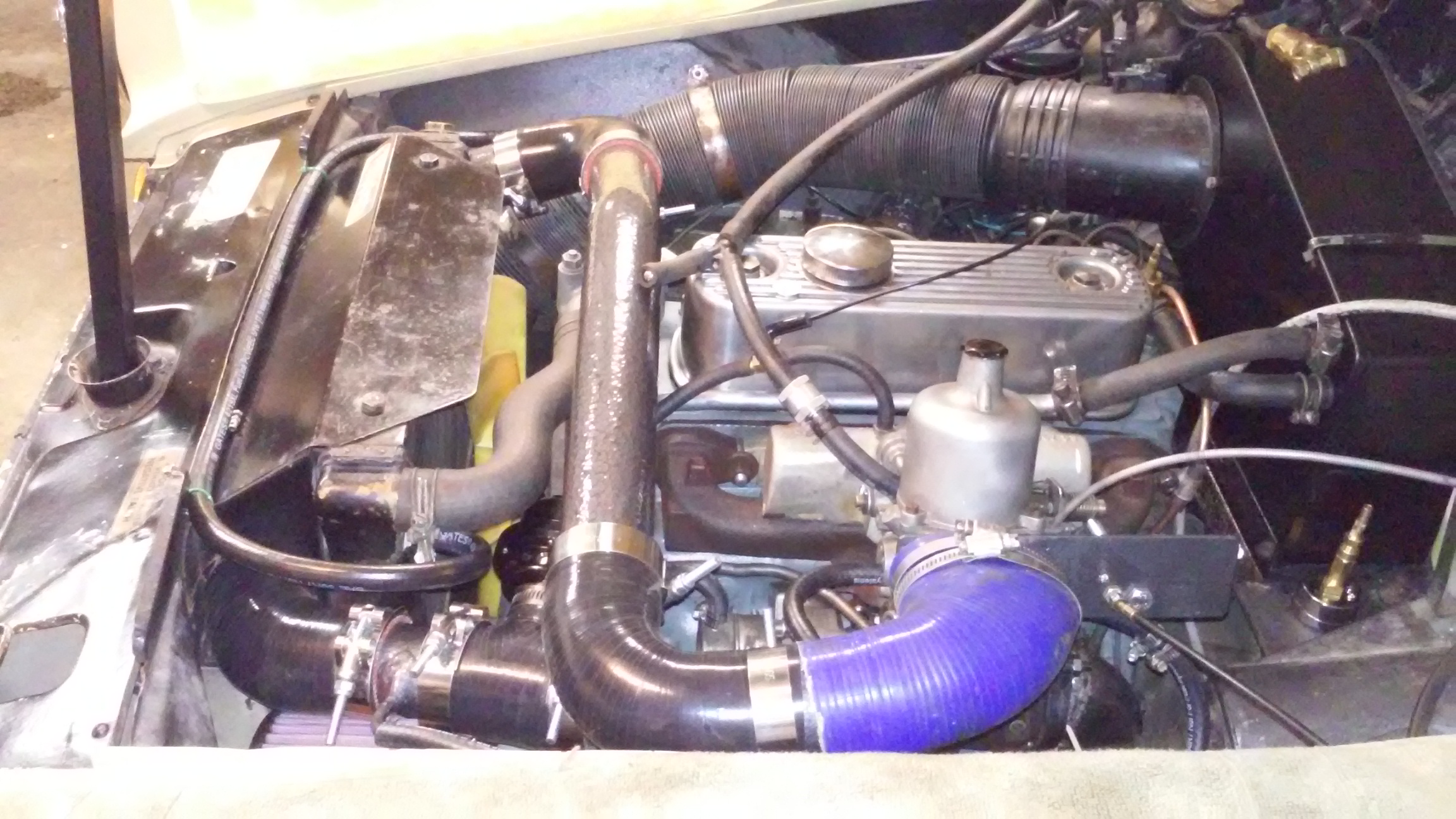

Pics of engine bay and cooler

i made progress

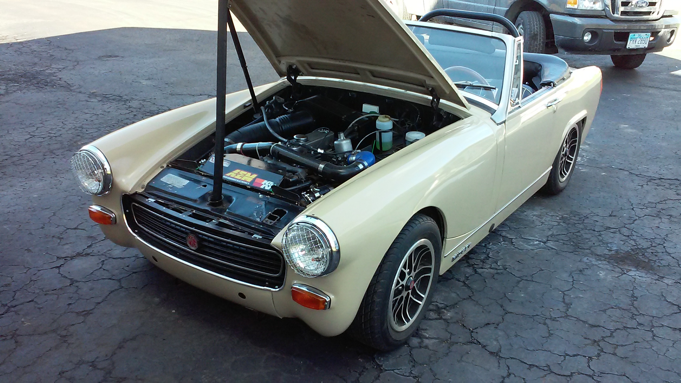

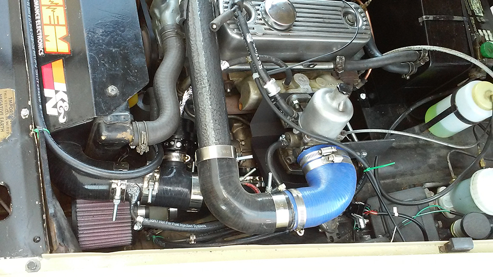

wackemandstackem
13 Posts
Member #: 11444

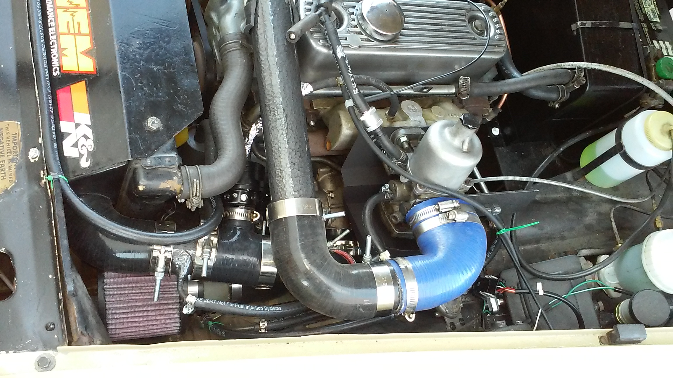

Ok some details
Metro turbo inlet and exhaust manifold.
2.25" Down pipe
Gt17 turbo
Mazdaspeed Miata intercooler
Pilot tube before intercooler
Draft tube pre turbo, connected to breather
Bosch fuel pump
Metro turbo fuel reg
1.5" carb, because my power goals are modest and low rpm throttle response is nice. Lastly carb was like new and only 20 bucks.
Ignition is stock and retarded(for now) megajolt or similar soon
Forge bov clone
KN filter
Engine is stock, except for head porting and 1.5 rockers(stock cam)
Pretty basic setup for now. It is completed, just waiting for good weather to fire the thing up and start tuning.
In the mean time i have some non turbo related work to do to the car. As with most of my project cars this thing will probably be constantly upgraded overtime.
I will post some more pictures soon.
This forum has been been a helpful resource for this project. Thanks everyone

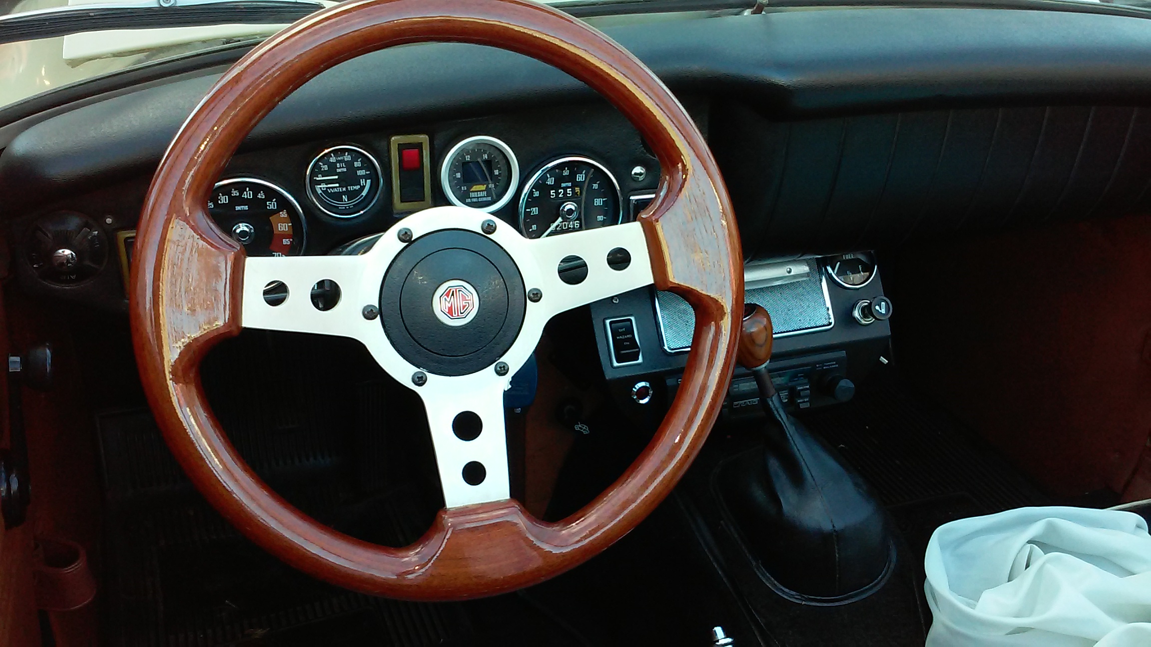

some pics
aem failsafe gauge where fuel gauge use to be. fuel gauge center stack next to speaker.

wackemandstackem
13 Posts
Member #: 11444

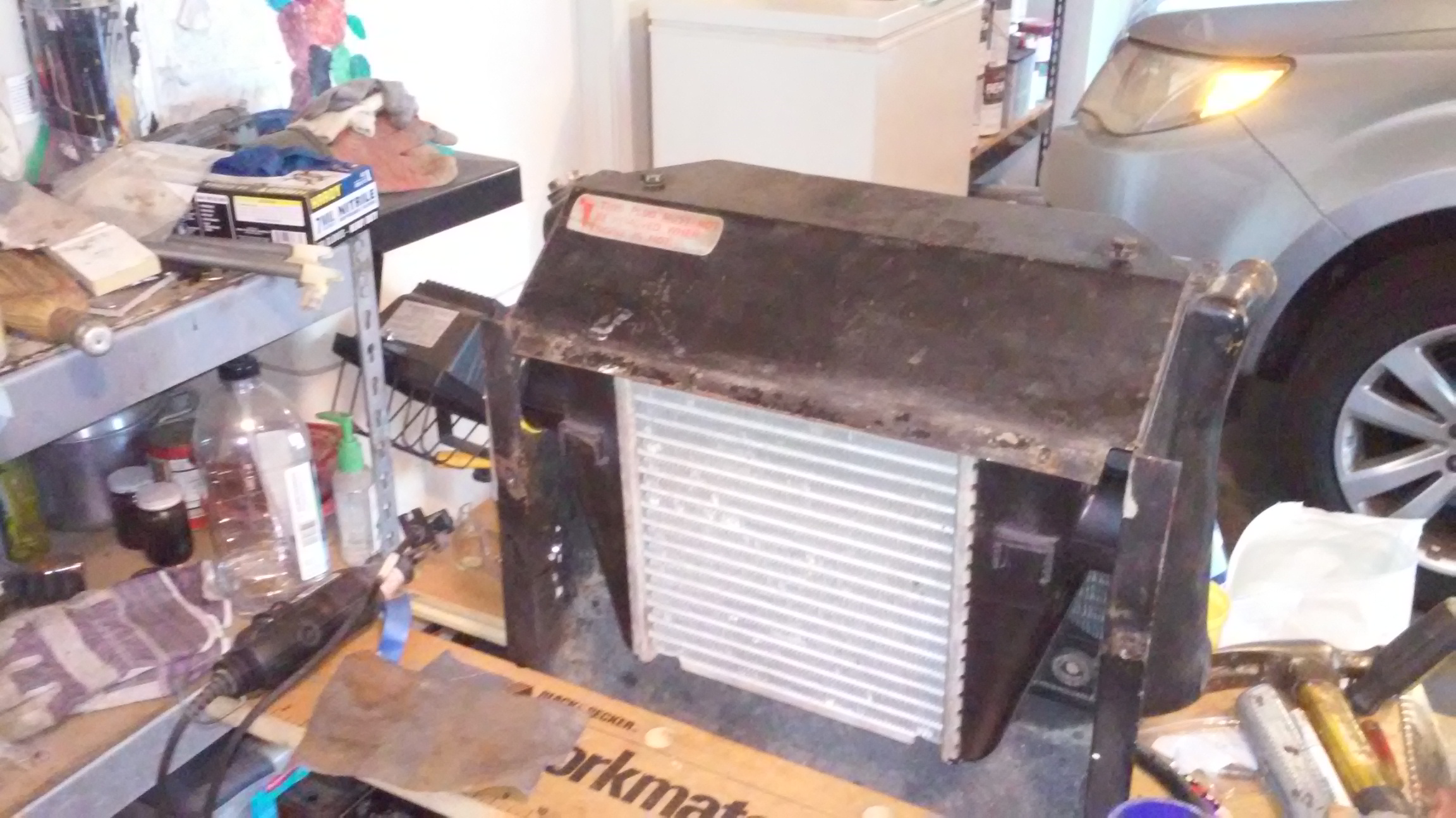

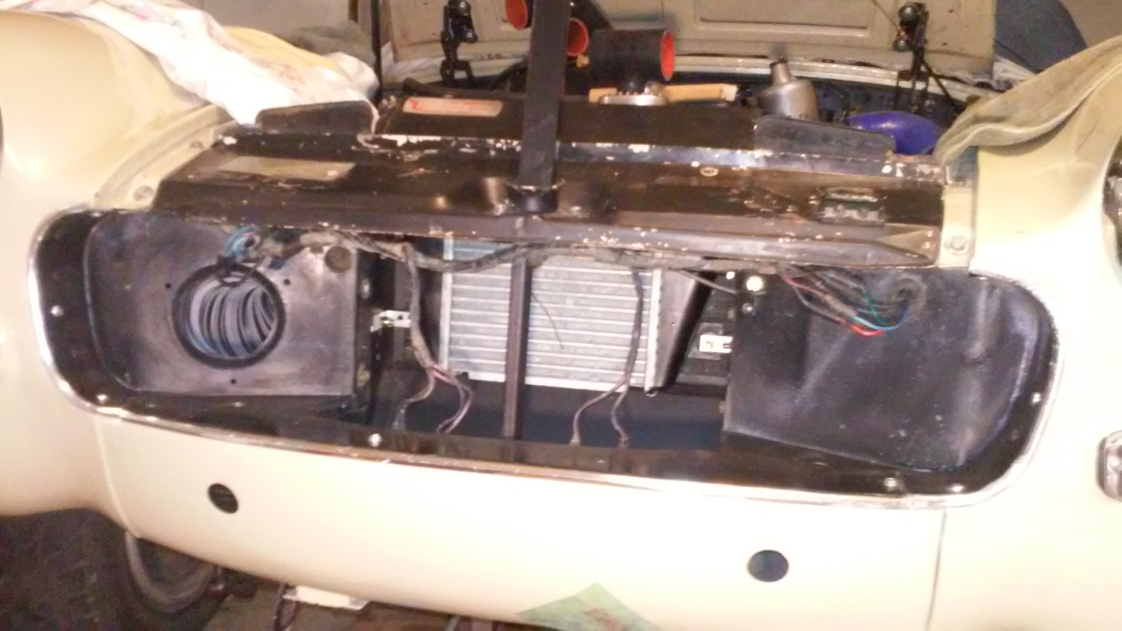

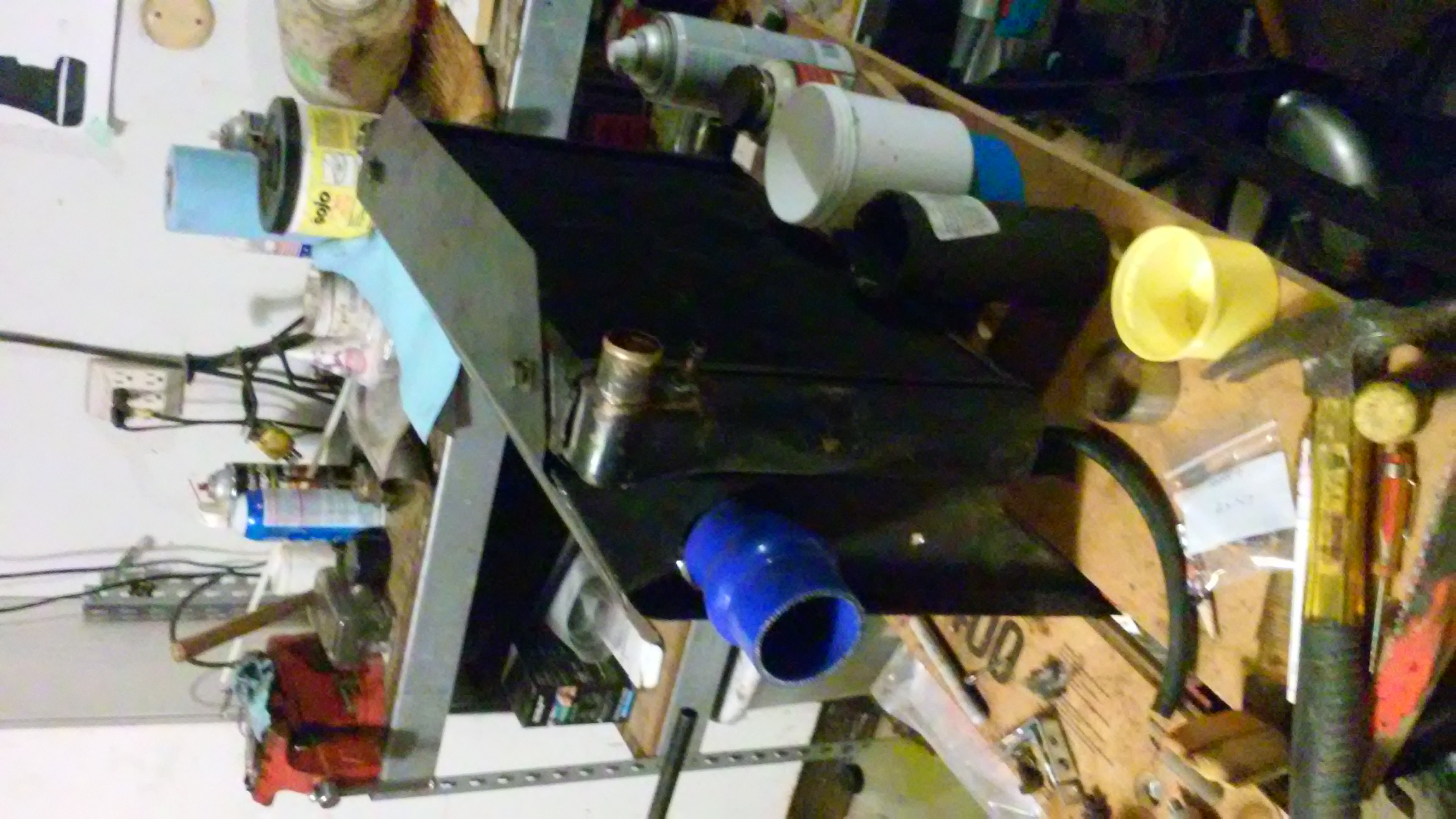

intercooler
with grill installed intercooler is unnoticeable.
Edited by wackemandstackem on 13th Mar, 2018.
wackemandstackem
13 Posts
Member #: 11444

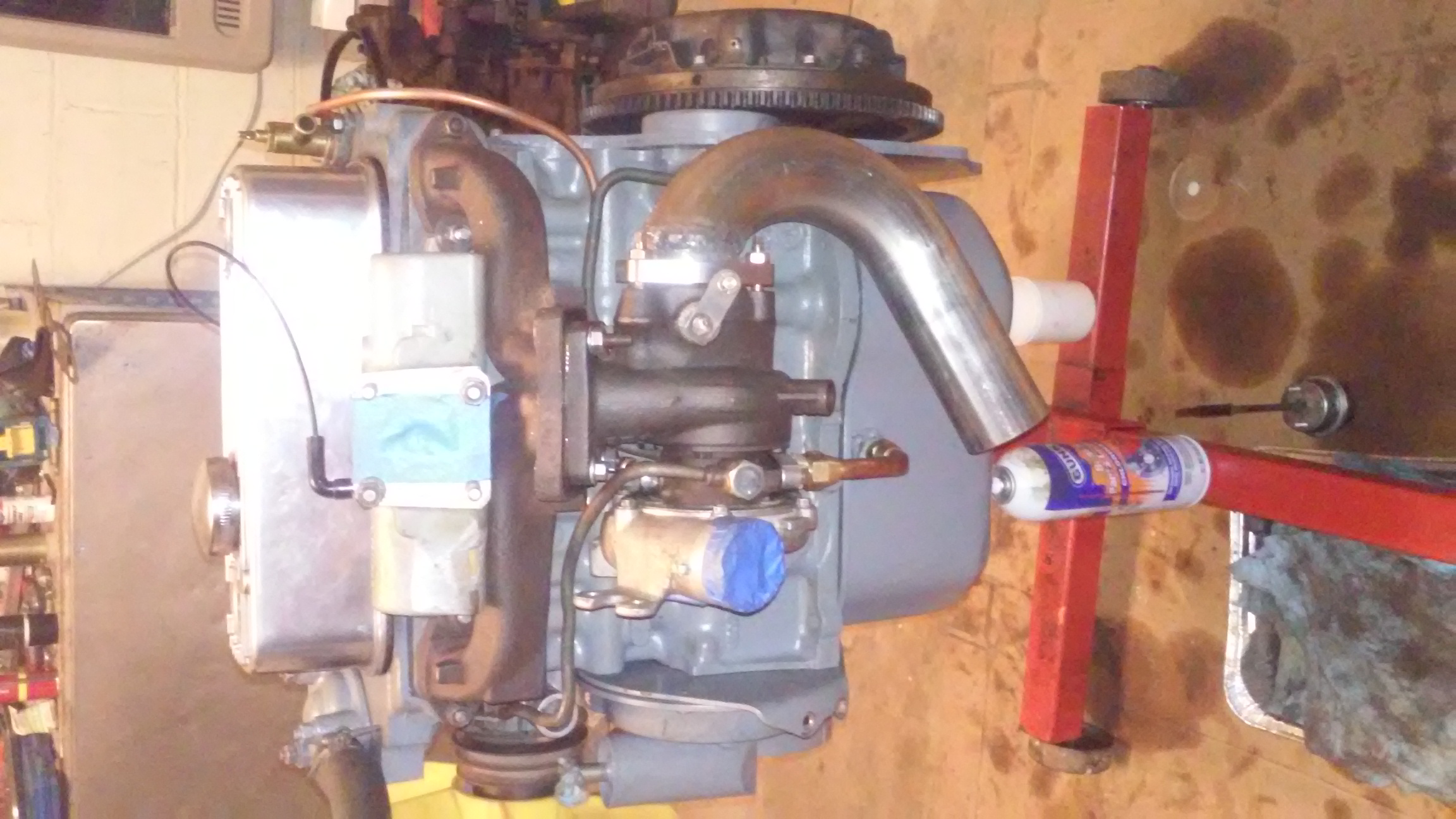

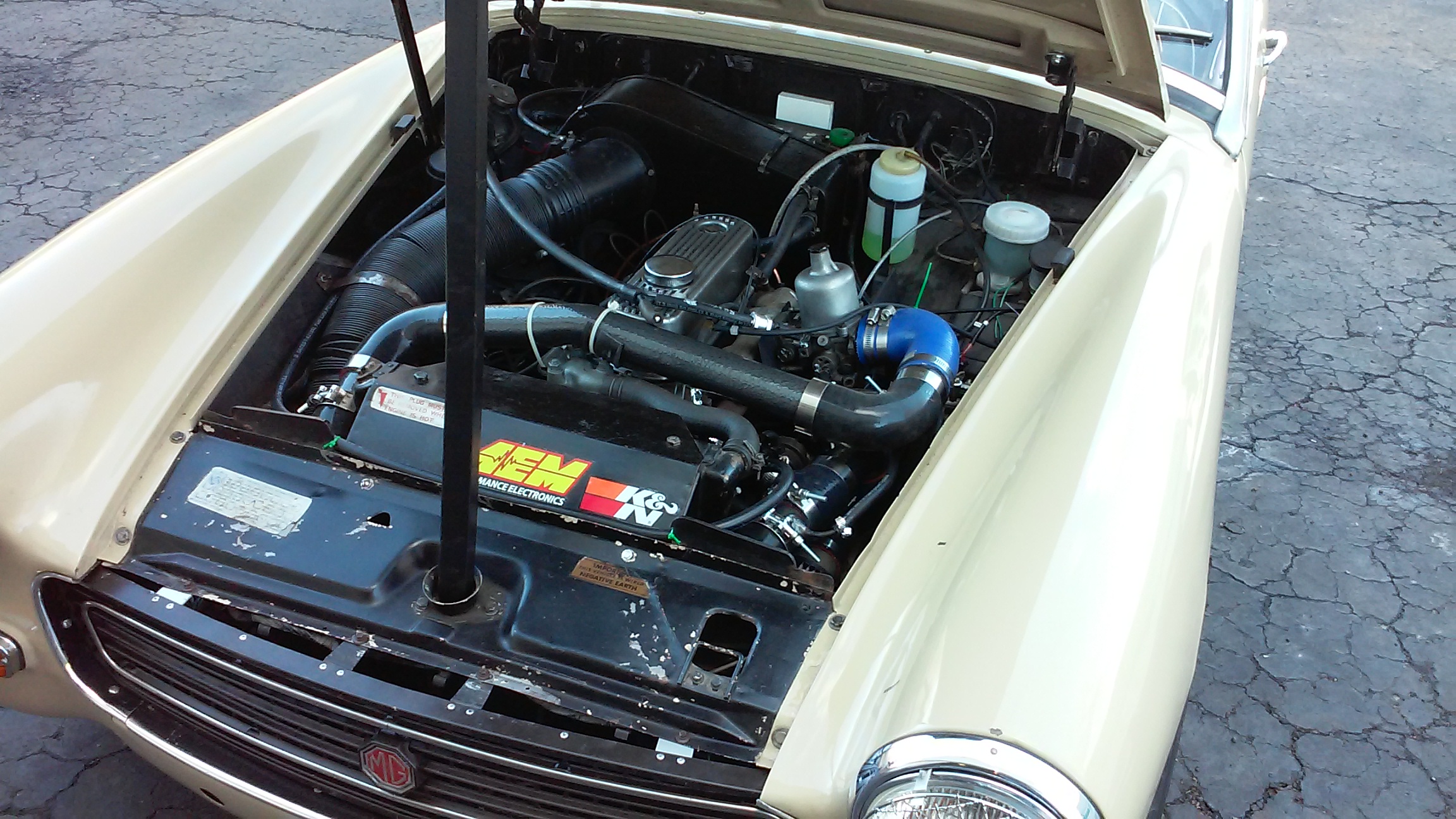

couple engine shots

Had you noticed that your steering wheel appears to be on the wrong side ?
jonny f
2096 Posts
Member #: 9894
Dorking
Awesome little car
jbelanger
1267 Posts
Member #: 831
Montreal, Canada
The left side is the right side. And vice-versa.

steve1275
864 Posts
Member #: 951
Bromsgrove
Must be missing something. You have no plenum,so how are you providing the correct boost pressure to the fuel reg?
