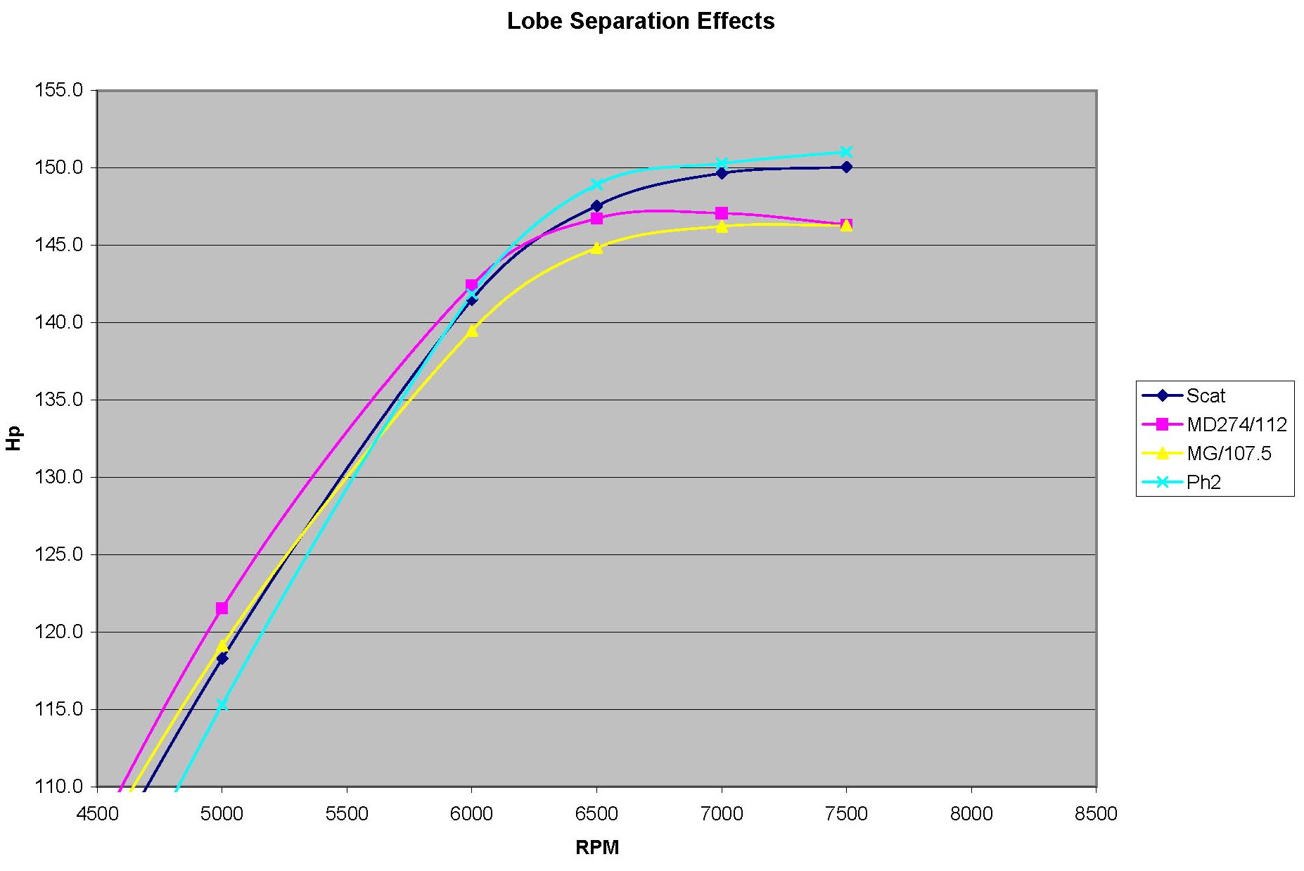

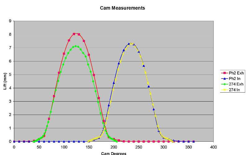

I've been having problems with my photo hosting, but now sorted so i'll post them here:

For what engine displacement and CR are these Paul ?
1020cc and 9:1, 0.8 bar boost.

Thanks a lot Paul. So it seems that the 274 only lacks the lift of the Phase 2. However this week I emailed Kent and asked them what they recommend for a 998cc turbo and they actually said that the 500 is the best candidate. I'm quite confused. However I think that the camshaft selection also depends a lot on the specific engine specs, doesn't it ?
