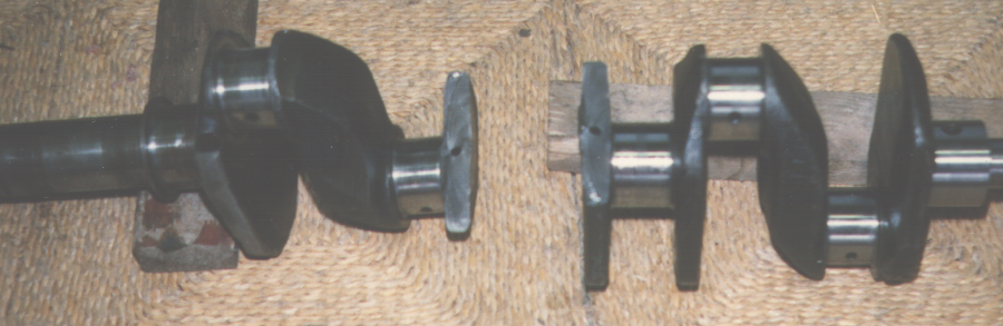

Loads of mainly clubman cars used the 1098cc A series engine code 10H. It's a very long stroke crank and not good for revs.

A firend sent me this. Non boosted 1100cc
