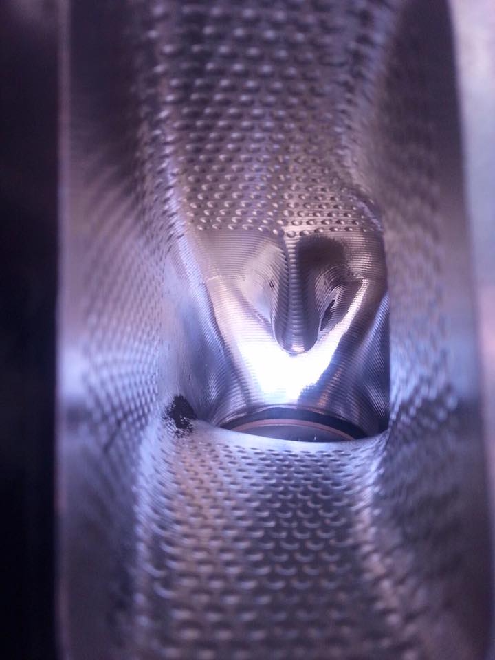

Something for you to think about Phil.....?.
4642 Posts
Way ahead of you Col ! *wink*

terrific photo sprocket, nice roughening, but does it work better? curious whether all the extra detail actually outperforms just a roughed out one. - either way the level of skill required is way above my paygrade, so just envious..
