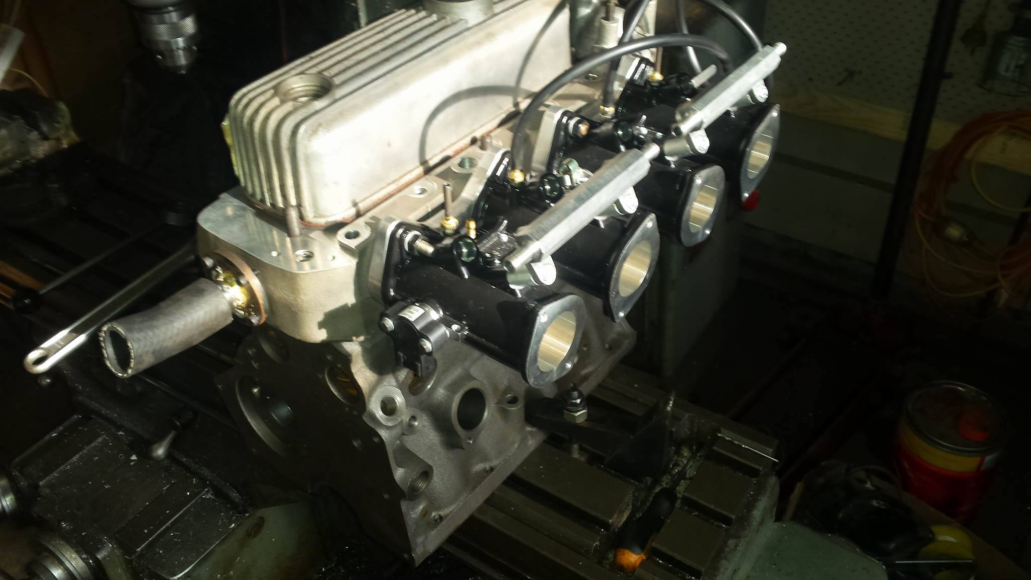

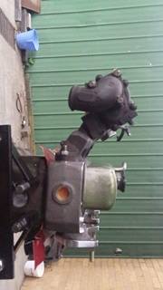

so after lots of thinking and homework I've gone down the 7 port road with efi. N I've started building my inlet manifold, which is taking some time as I drive a truck and trailer { you guys call em lorries } 14ish hrs a day.
Over a few beers and a bbq the other weekend my brother inlaw and I looked in a box and went " ohh .... that will help "
so this is what I have, yes the manifold i upside down but that mean I don't have to cut the crossmember to get it to fit, just need a bonet bulgde ....read POWA bubble :)

you might be able to just get away with kicking the back edge of the bonet up by bolting it to the higes with the rear stud on top of the hinge instead of through it. that giveabout 1.5" lift iirc.

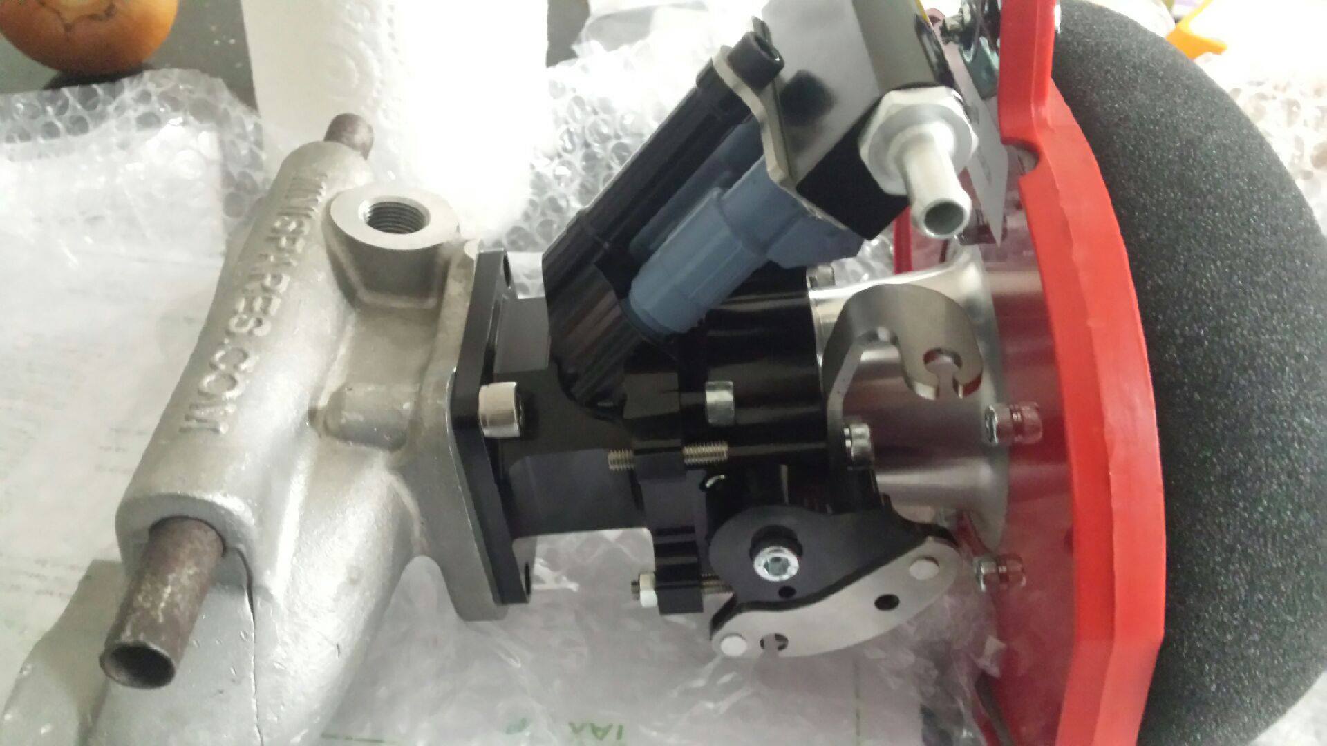

I'm going to be running 2 x 45 Jenvey dcoe efi " herritage" bodies ... any thoughts on them ?

Evoderby
224 Posts
Member #: 9987
Amsterdam
The jenvey heritage throttle bodies are extremely nice on an Aston, E-type etc. but on a 7/8 port transverse setup they are less than ideal Imho since they're far to bulky for the space available.
Why not run a single throttle plenum?

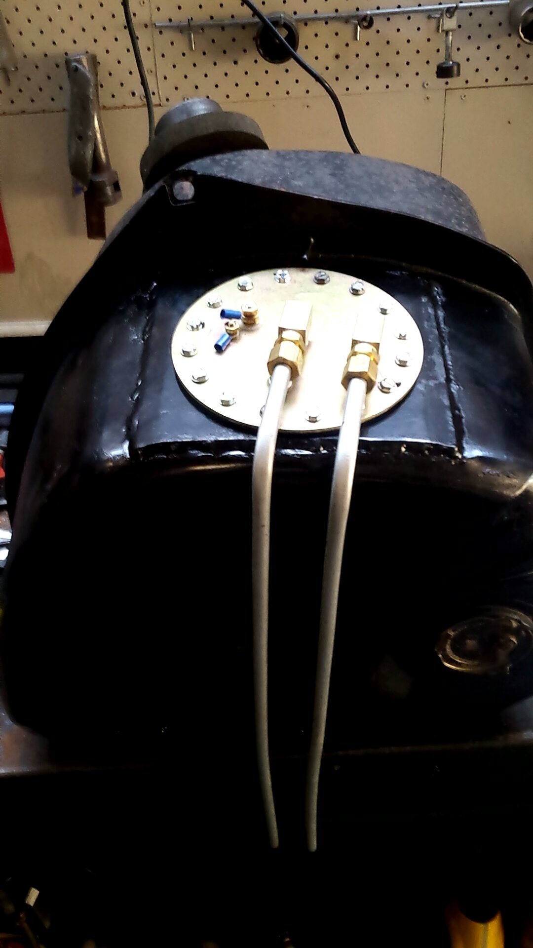

well I got some more time in the shed this weekend and have managed to finish the pump mount and tank set up

this is the tank and pump so far, 190lt Walbro pump with in tank "sump " and filter.

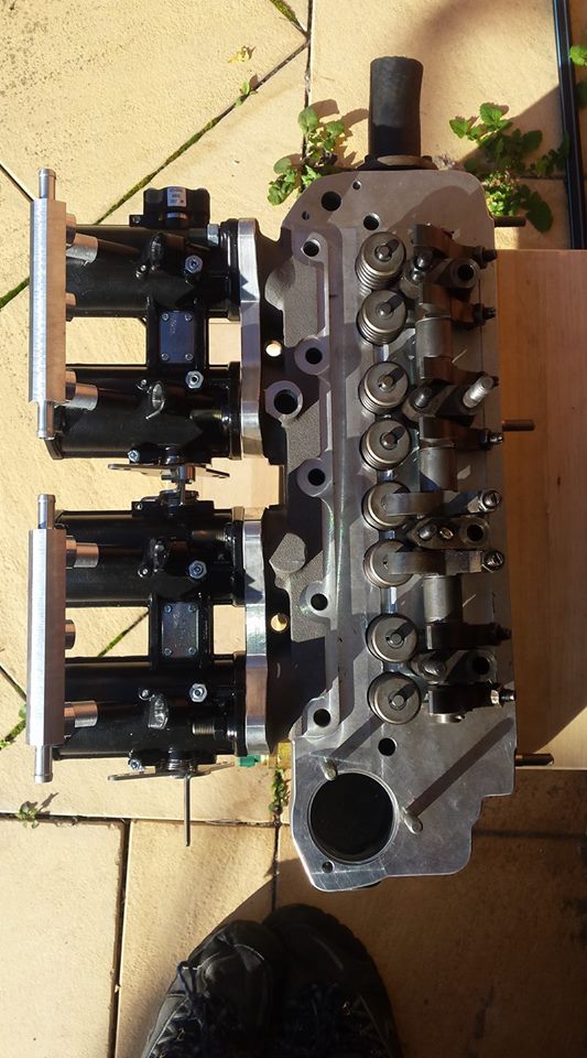

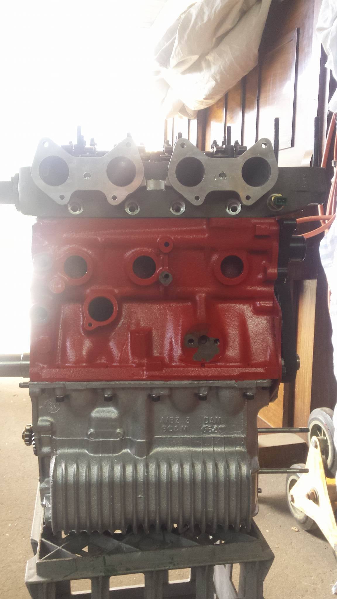

So this happened yesterday *Clapping*
pair of 40's with mahoosive 370 cc injectors, now to make a throttle cable linkage and then send to head off to get tickled. Kawasaki valves are apparently the thing to help with gaining valve lift.

giannoutsos
166 Posts
Member #: 8952
Athens Greece
Morning, nice looking head that.
Could you elaborate on the Kawasaki valves please.
Thanks

Blimey if yours is a slow build then mine is jurassic
4633 Posts
Don't want to piss on your chips, but how will fitting different valves increase valve lift ?
Surely this will be dictated by your cam and rocker combination and to a lesser extent the setup of pushrod/rocker geometry ?

I'm limited atm to std rockers and at the most a cam with 296 thou lift, if I change to longer valves and another set of springs I can gain more lift { 1.5 rockers } and not have the springs bind or the valve retainer touch the stem seal / guide.

4633 Posts
Ah I see you're trying to increase the distance between the retainer and the top of the guide/stem seal to allow you to use higher lift.
What height are the guides installed at. It should be possible to have an installed height that allows over .500" lift without changing the valves etc

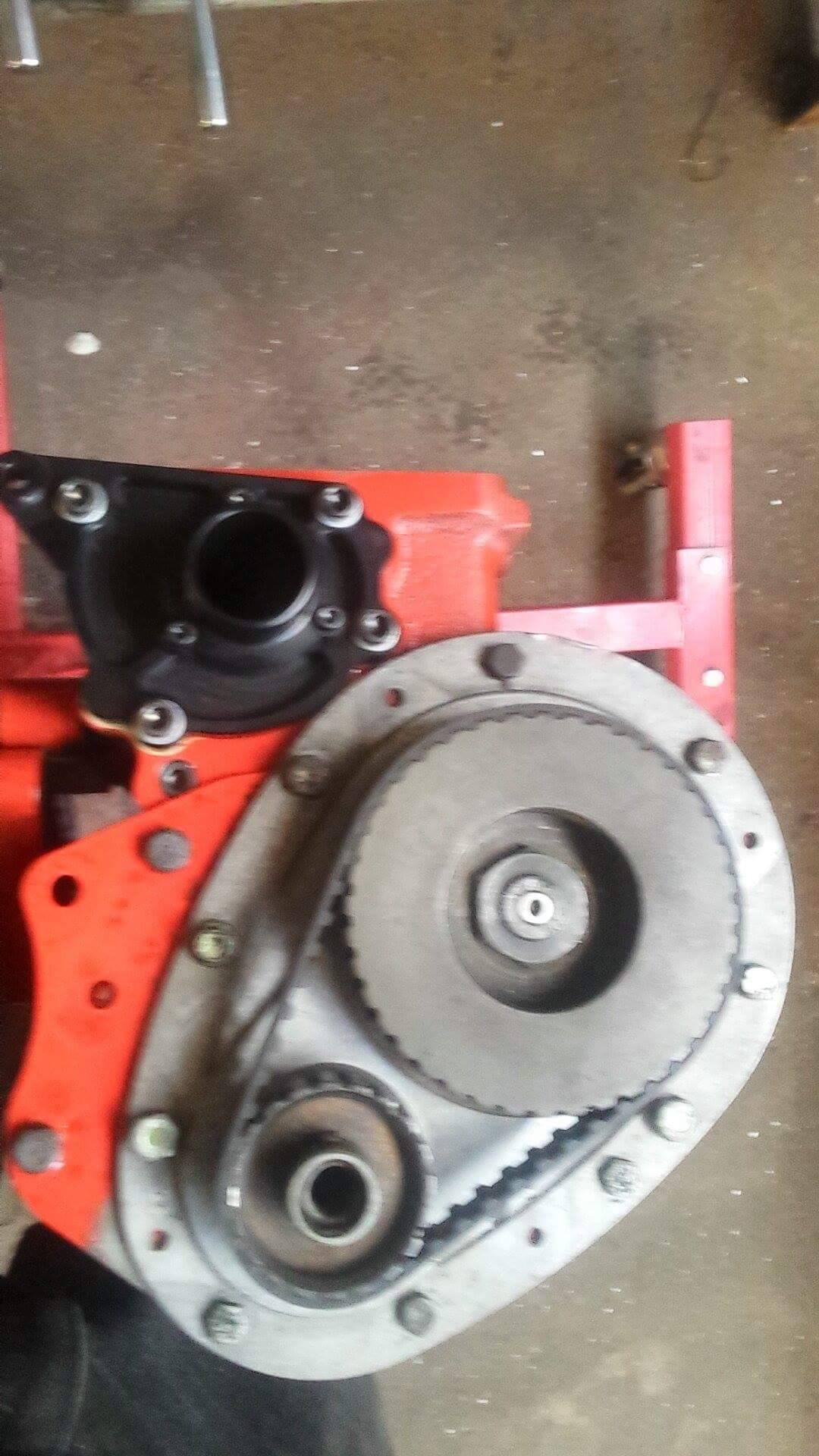

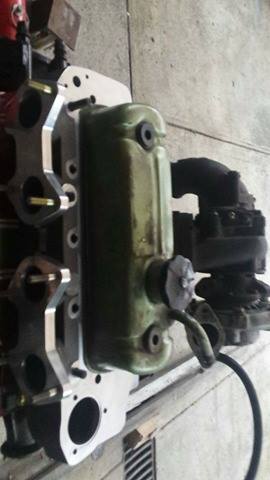

So as it continues at a galical pace .... don't want to work too hard lol
It's a 110S block, Dam 5626 box with Guessworks x-pin centre ,3.44, bored to 73.5 with a set of cast pistons, 81A cam { 292" lift @ lobe, 106 deg lobe sep, 228 deg lobe duration} A+ crank @ 10-10 with A+ rods lightened and balanced, dry decked, cam belt kit and MED water pump plate.
slowly slowly ..... soon it will get it's 40mm tb's for it's last time.
Just trying to decide on what rocker cover to use, std steel, classic alloy { in pic .. period part} or the square alloy box.

Those throttle bodies would never fit under a roundnose with a plenum, its one of the reasons mine took so long.

Richspec
552 Posts
Member #: 300
Cumbria
the trick is to use short bodies and turn them upside down so the fuel rail doesnt interfere with the bonnet, thats how it works on the 8 ports.
