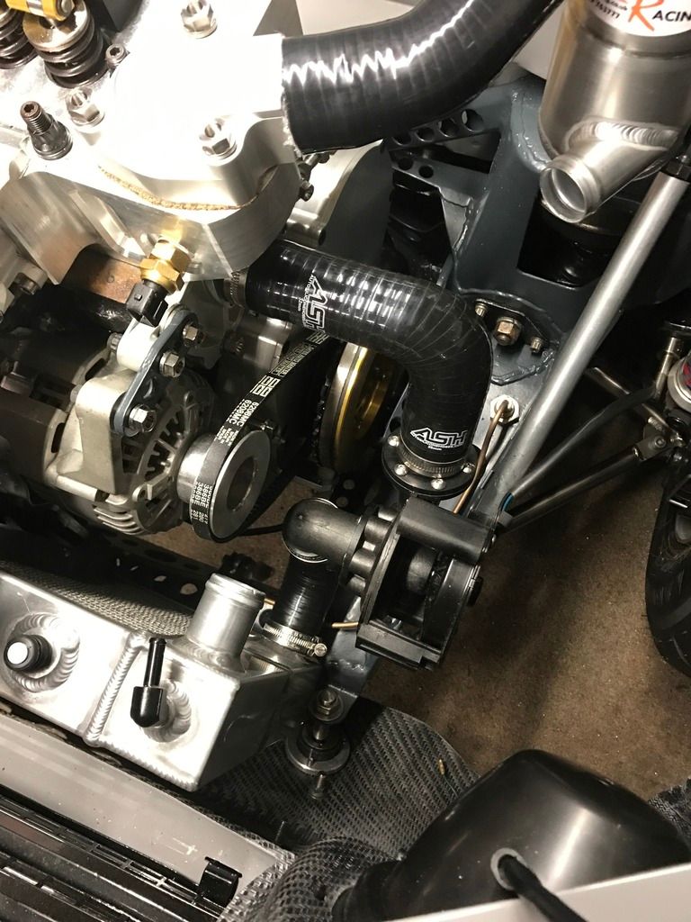

Finally decided to keep it, and see how it goes. Managed to find a suitable location that's not to high.

Looks much better there. Might try one of those smaller ones and see what difference it makes.
Craig David pump looks good there Matt

The pump looks good there should be fine.
I would change the cork gasket to a paper one at the thermostat housing, I had two fail on my engine, one in a middle of a rally not very nice.
