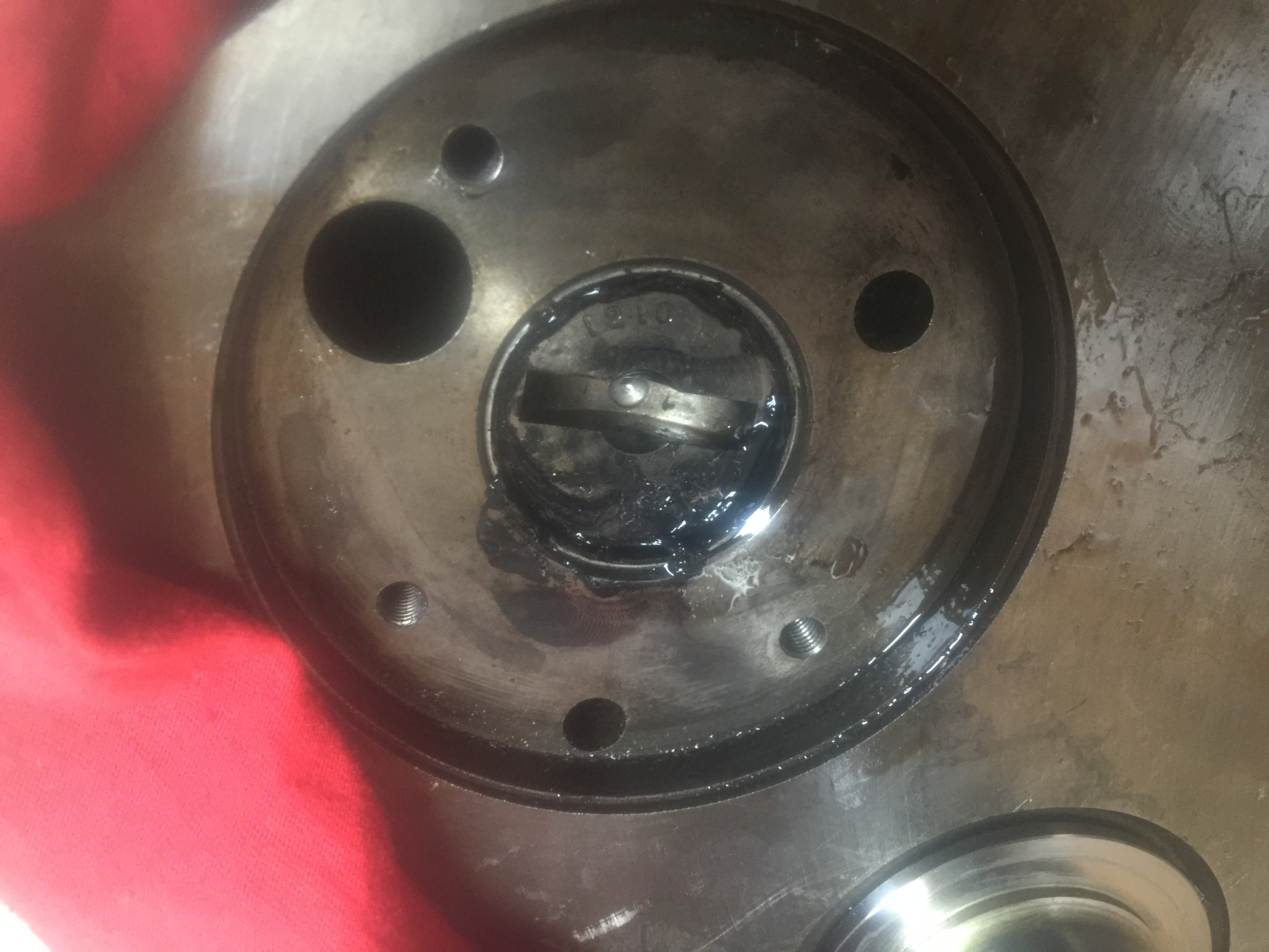

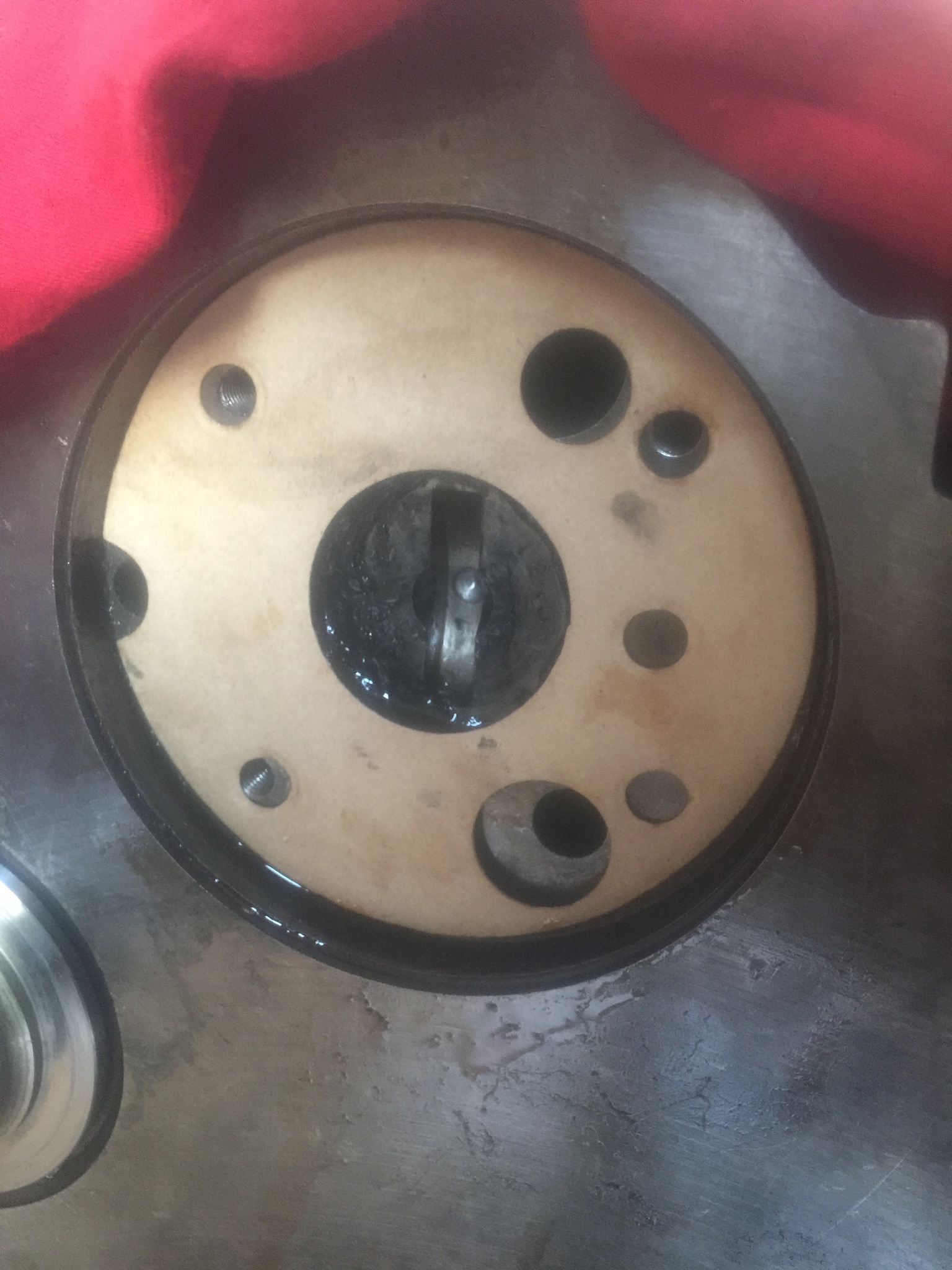

MPI block
Metro turbo high capacity AP oil pump
And the standard rover gasket set
To me it doesn't look very efficient compared with a standard pump?
Quite abit of gasket overhangs the pumps channel
And as you can see isn't entirely open to the oil galleries?
When did you buy it and who from ?
There is a long sad history with the "turbo" pumps that certain suppliers were selling, just search and you will find it.
In all those previous cases the ports in the pump were too large so didn't seal against the block with the standard gasket thus losing prime and pressure.
Is your second photo (of the block face) from the new pump or the one you took out.
I'm guessing the latter.
Put a bit of engineering blue on the pump joint face (no gasket) and rub it around the block face then photo the blue marks on both the pump face and block face.
Ignore the gasket, the holes are plenty large enough, the mating faces between pump and block are far more important and engineering blue will show if you have one of the "fixed" pumps or one of the bad ones.

All of the pics have the new pump in them, it's just the gasket resting ontop
And the block is the mpi one with cam in situ

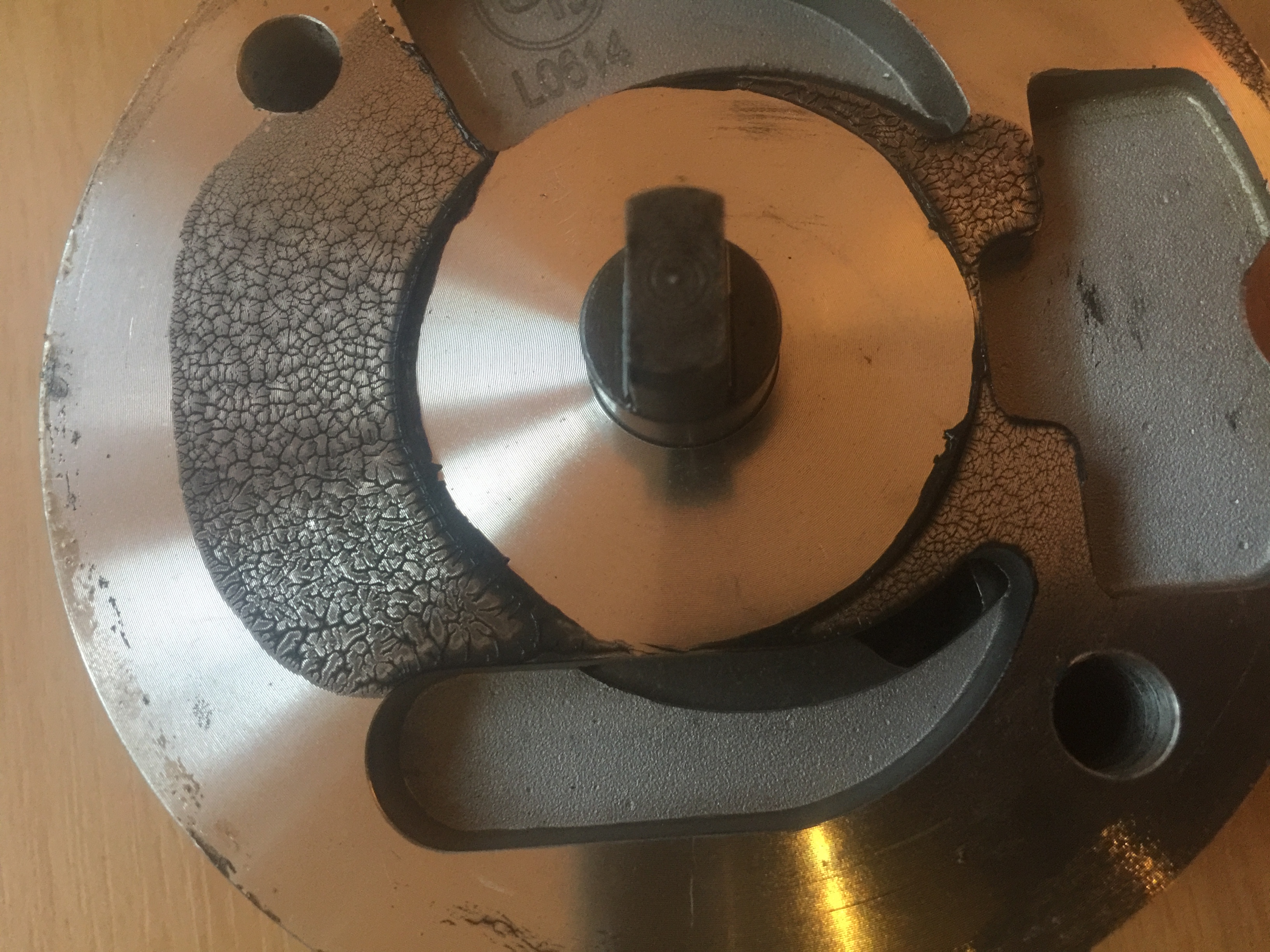

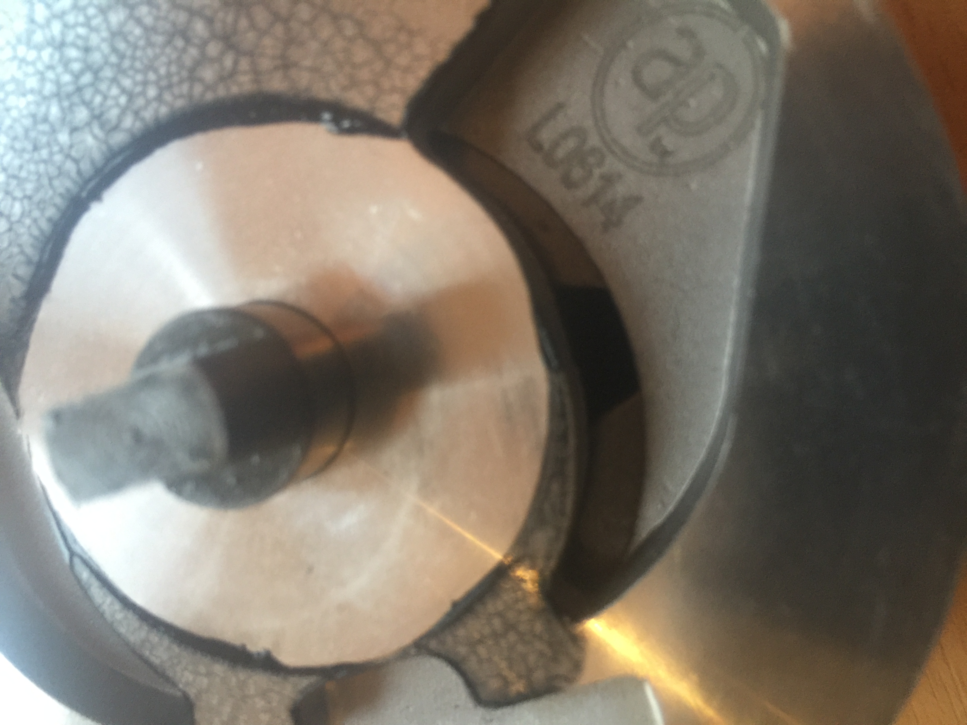

Will
167 Posts
Member #: 11091
I know it's not engineering blue but my curiosity got the better of me
Using the graphogen building paste this is what I got
A gap starts from about the 4 and finishes by the corner again
Is abit thin on the other side too
engineers blue will give a clearer picture but it does look like a similar issue.

I have to say I'm with Mike-998.
This is not a block issue, the oversized cutouts in the defective pumps virtually overlap the cam bearing.
That space around the cam bearing does not vary from block to block, the only variation being how far the bearing is pressed in, maybe giving 1.5mm extra "safety" if it is pressed in flush with the surface.
I can't believe AR/Leyland relied on that....
The gasket width at that location was simply too small, non-existant in many cases.
It's good to here it's been fixed (waiting for Will to show us a blued one) but it's no excuse for it being wrong in the first place.

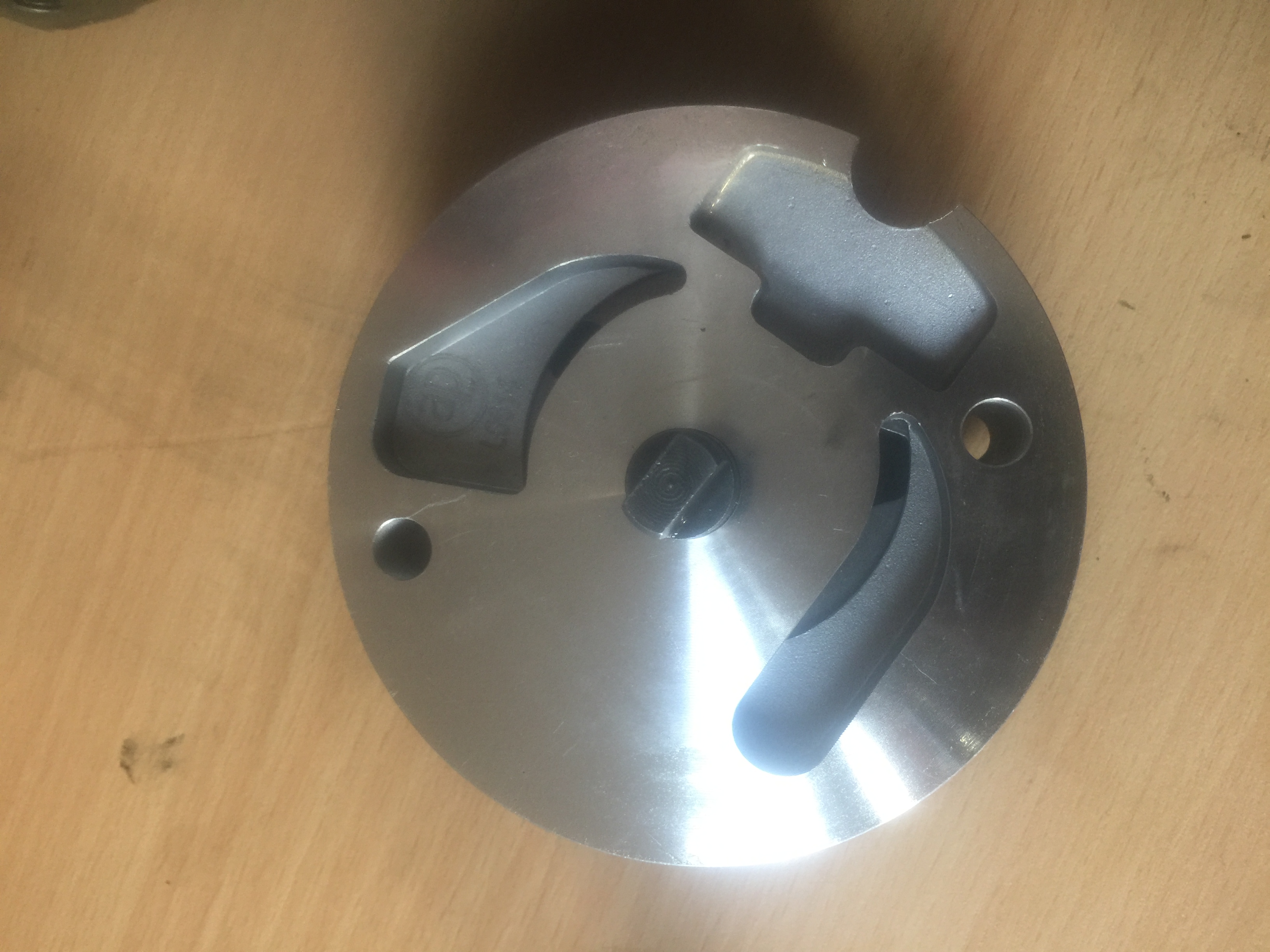

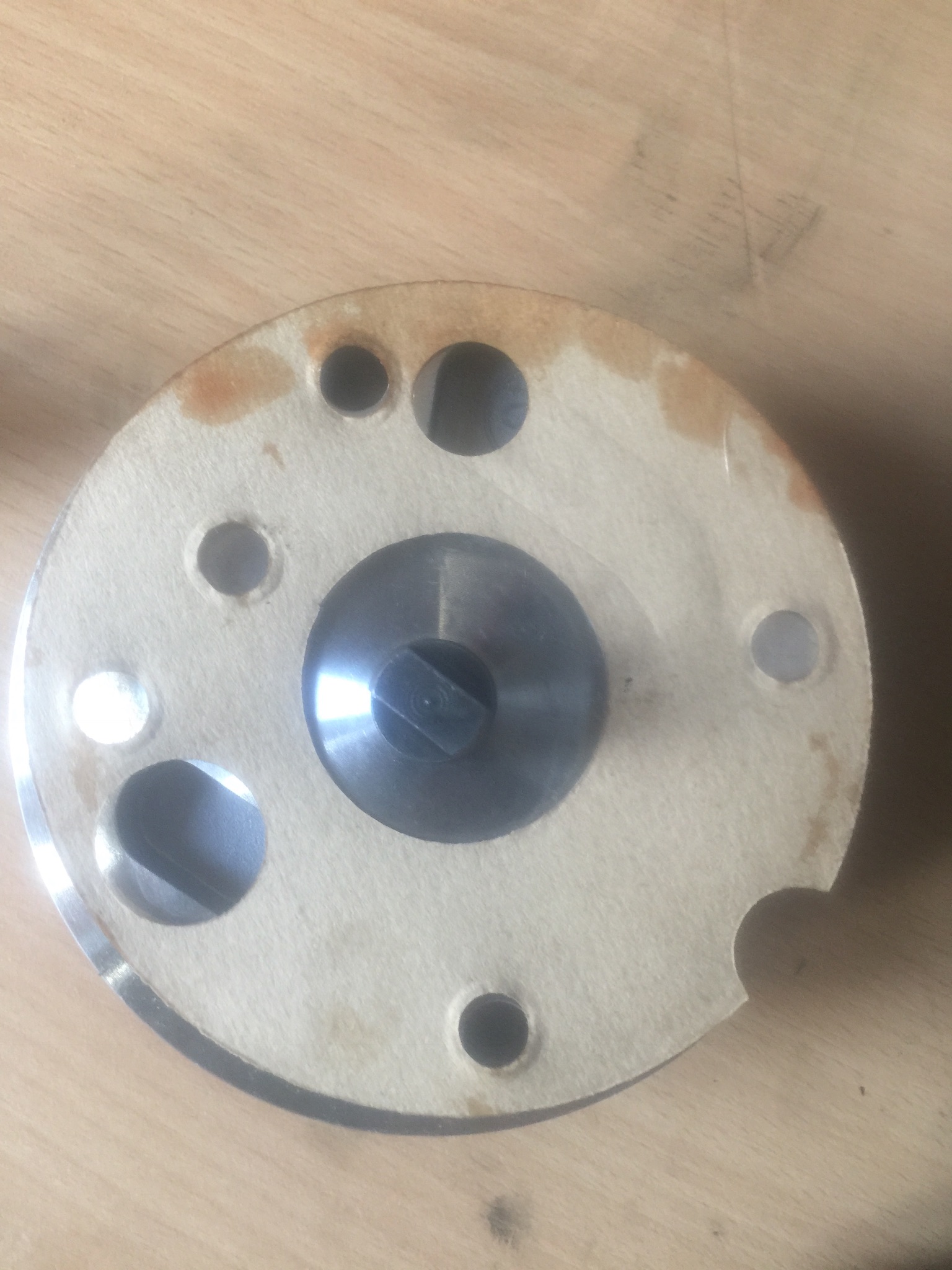

Will
167 Posts
Member #: 11091
The new pump has the green dot and the old pump has AP and the product code printed on the inside
New pump is abit tight in places but does at least cover the circumference of the camshaft bearing
New pump has the branding on the outside too for identification purposes
