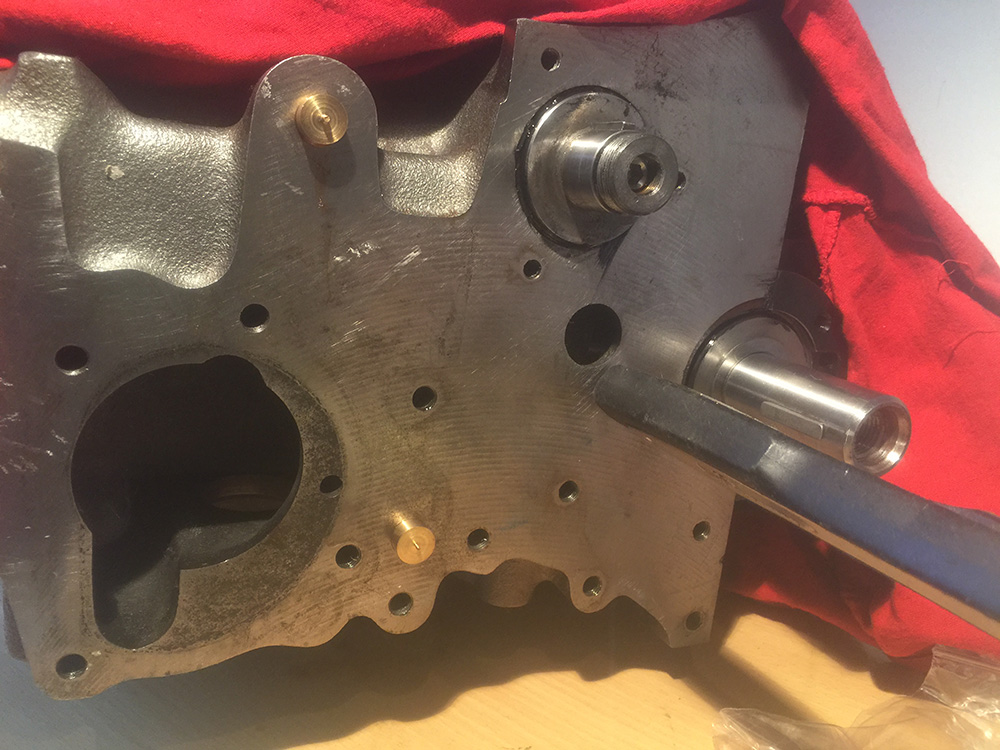

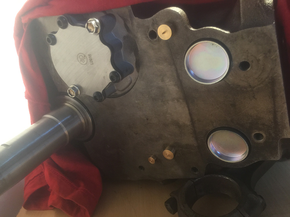

Just a quick double check I've got the locations right as it's been a while

yep, only the ones at the front of the block are under pressure, its worth spearing a bit of sealent on those before they go in, and then staking the block so they can't come out under pressure.
