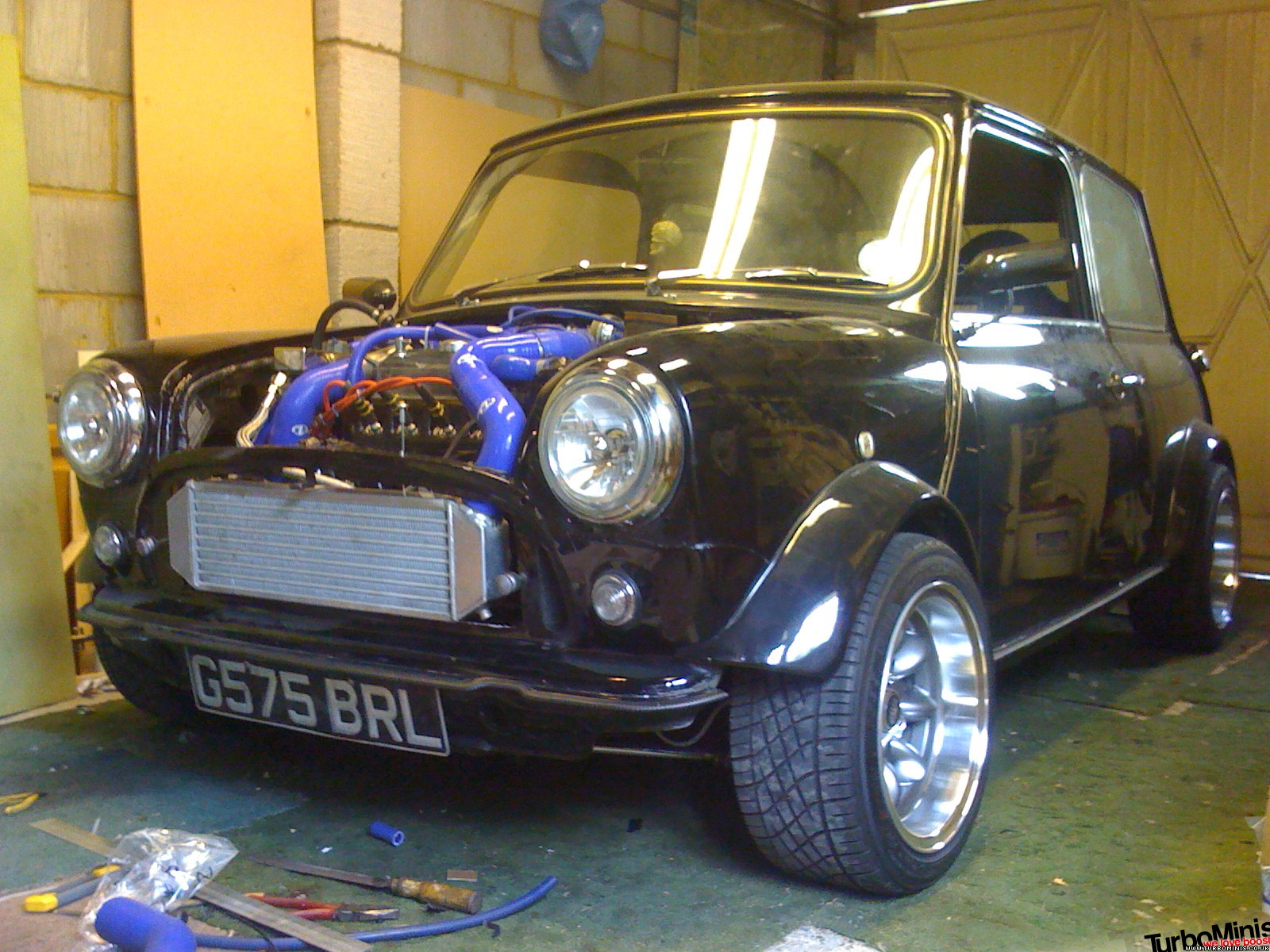

Sounds like mine. It's an off the shelf item from Allard. I'll find a link for you.
Hmmm. It's not on the site anymore. http://www.allardaluminiumproducts.co.uk/a...tercoolers.html
An old photo. But shows the intercooler well and isn't on Photobastard.
