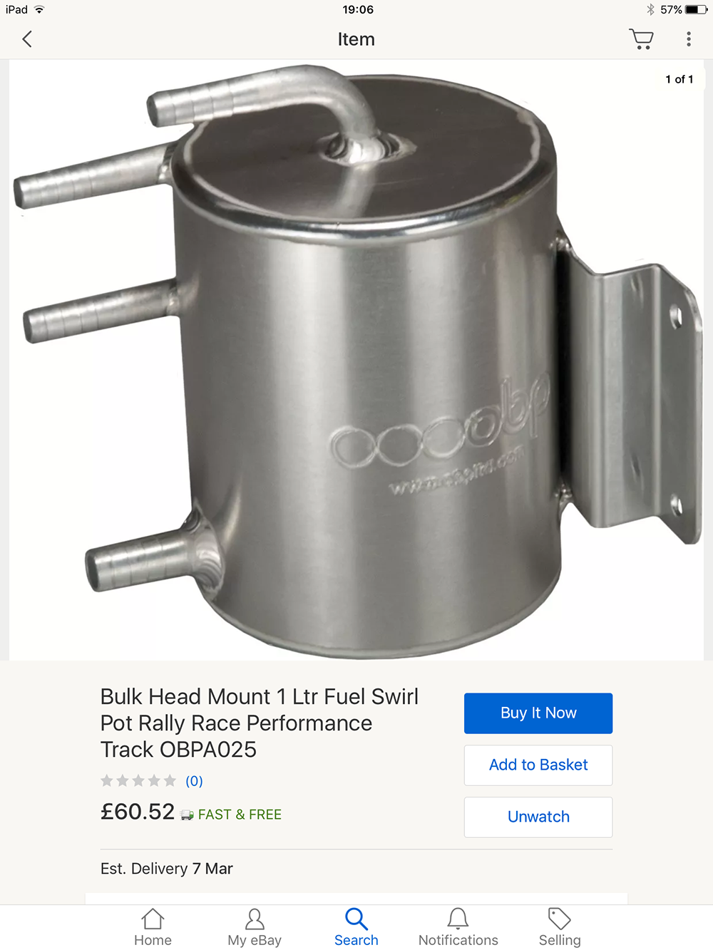

Is this swirl pot above suitable chaps ? It's 1 litre
I've got a pump in the for sale section that would be fine for a lift pump.

Do you think the above swirl is suitable ?
