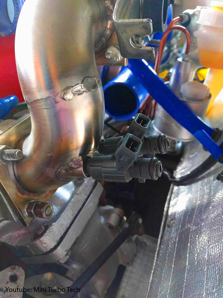

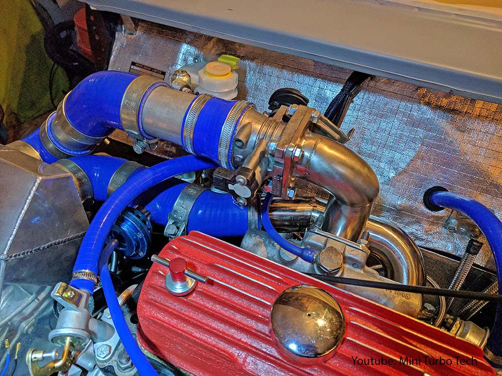

Well it took a lot of thinking power and a LOT of grinding, cutting, welding, re-cutting, re-welding etc but its finally complete!!! (just a heat shield to make and some finish welding)
The throttle body is a 48mm MGF one made by Dellorto, £16 from ebay *smiley* - including TPS.
*Clapping*

Looks great.
When I ran a side mounted Carb for a suck thru setup the air seemed to deviate to one side of the manifold which caused a leaner mixture one half of the engine. But that was a carb and not injection so imagine it will work better.

On 6th Mar, 2017 MikeRace said:
Looks great.
Yes I thought about that, I'm going to have to assume that the angle of the airflow from the right is going to cause a "swirl" in the lower part where the injectors are. Hopefully this helps with fuel mixing - but ive got no way to simulate this. I'll have to keep an eye on plug colours.
"If its not broke, whack a turbo on it"
https://www.youtube.com/c/turbominitv
It didnt really affect it driving wise. The car drove great tbh but I wasnt pushing the boundaries of boost.
